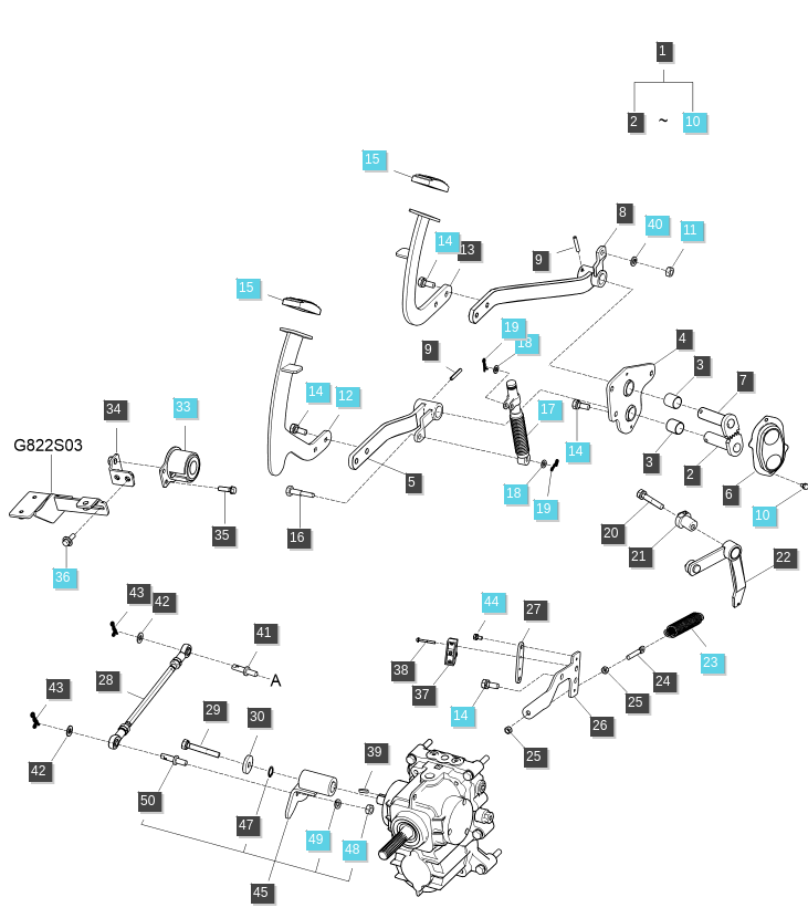

I recently acquired an R4041H and the hydro occasionally stalls. When the hydro pedal is pressed it’ll kick out and tractor will stop moving. You can press the pedal all the way down and nothing will happen. The only way to move is to return the pedal to neutral and start over.
All filters have been changed, linkage checked, and fresh trans oil.
Ideas??

All gear ranges? and is the reverse petal moving opposite of the forward? Does it in reverse?
The petals and linkage moves Item 45 and that moves the internal swash plate in the HST, maybe the key item 39?

Does it in all ranges, but more often in 3rd. It’s done it in forward and reverse, and yes, both pedals are operating.
What is #39, is that a key way? I shall take a look at that
   / R4041H trans problems #5
If the key was sheared or missing, maybe? I guess it could have enough friction to move the internals most of the time. IMHO if the petals move Item 45 and the key (39) is intact it would have to be internal. UNLESS you just not getting the gear selected, mine will sometime not click in on the first try (All HST do that).

Thanks for the heads up. I'm going to check that key way. Also wondering if it could be a faulty pressure relief ??
