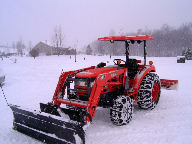

   / R4's and snow don't mix #22
For years I fought trying to push snow with my R-4's. They were useless in snow.
I added chains this year and the differance is AMAZING. Don't know why I waited so long before adding a set of chains.

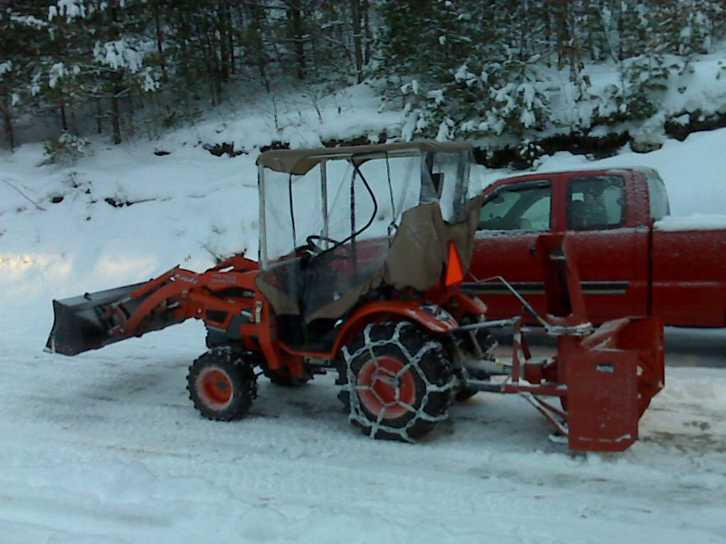

   / R4's and snow don't mix #24
My r4s (loaded) were great for the first 2 winters i had the machine. by the 3rd winter, the leading edge of the treads were worn down somewhat and i think that they actually round-off. my driveway is 700'+ on a pretty steep hill. last year i added vbar chains on the rear only and now it is a tank. i can push and blow snow back up the hill now as well, so it cut my play time in half... i don't think any type of tire by itself will matter much on compacted, frozen snow/ice....
