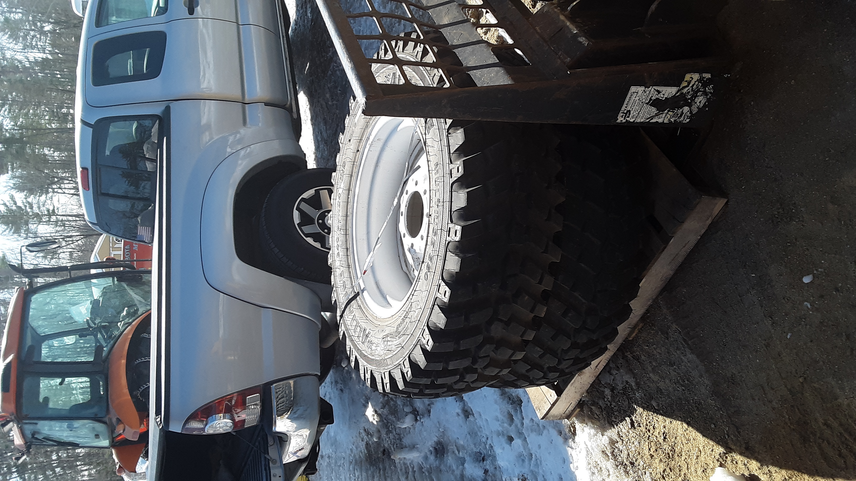

I just got these Monday, I don't know if they have a "r xx" designation but they are similar to the Nokian. I opted out of the actual Nokian as from what little information is out there, the Nokia seems to have a softer rubber and a narrow target of snow use. I've had a pair of this style on the front for over a year and I'm very happy with them for our soils (gravelly) and winter plowing along with the road ride and expected increased tread life.
View attachment 680013 View attachment 680014
Nice write up Midwesterner

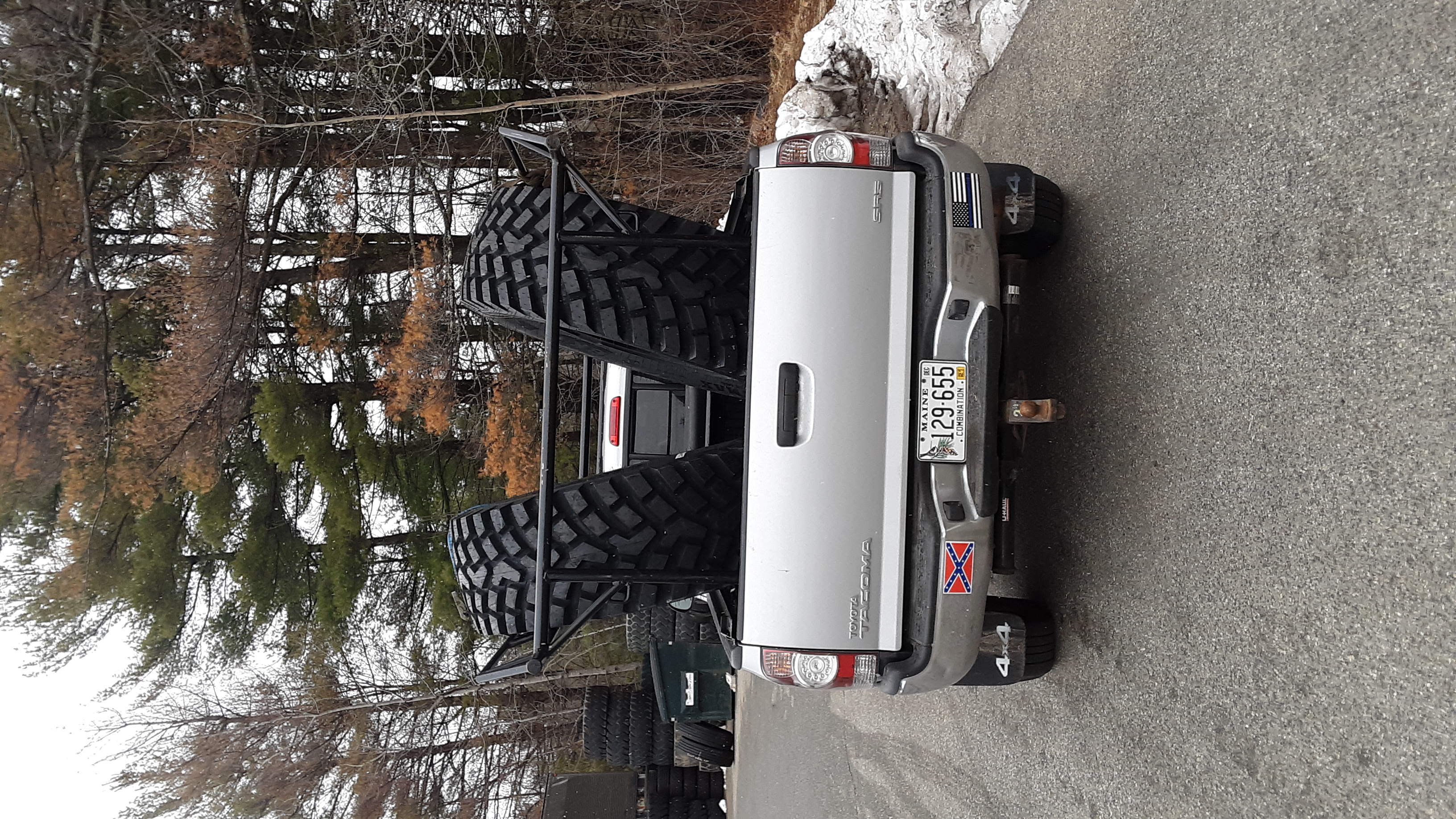

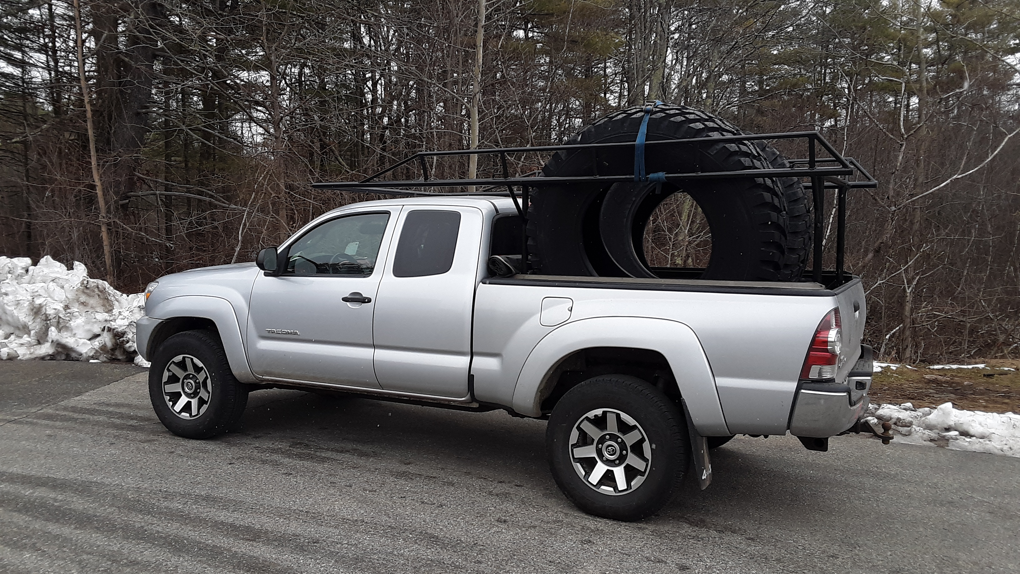

You may need to upgrade your p/u if you decide to put them on the rear... :laughing:
   / R4s vs R14s Tested #24
If Rustyiron is going to put those tires on his p/u, he better go get two more to level the truck off. LOL Jon
   / R4s vs R14s Tested #25
I may have been misunderstood. I thought that those were front tires for his tractor. Not knowing or being familiar with his tractor, and using the assumption that the rear tires would be bigger, I assumed that two rears wouldn't fit in that toy. In fact, even one at a time might not, depending on the F/R ratio. Further to the point, that toy may not have the weight capacity to carry one large tire.
   / R4s vs R14s Tested #26
They are for the rear. 18.4R30, right about 5' tall. :thumbsup:
these are the fronts fresh off the shippers truck back in March 2019

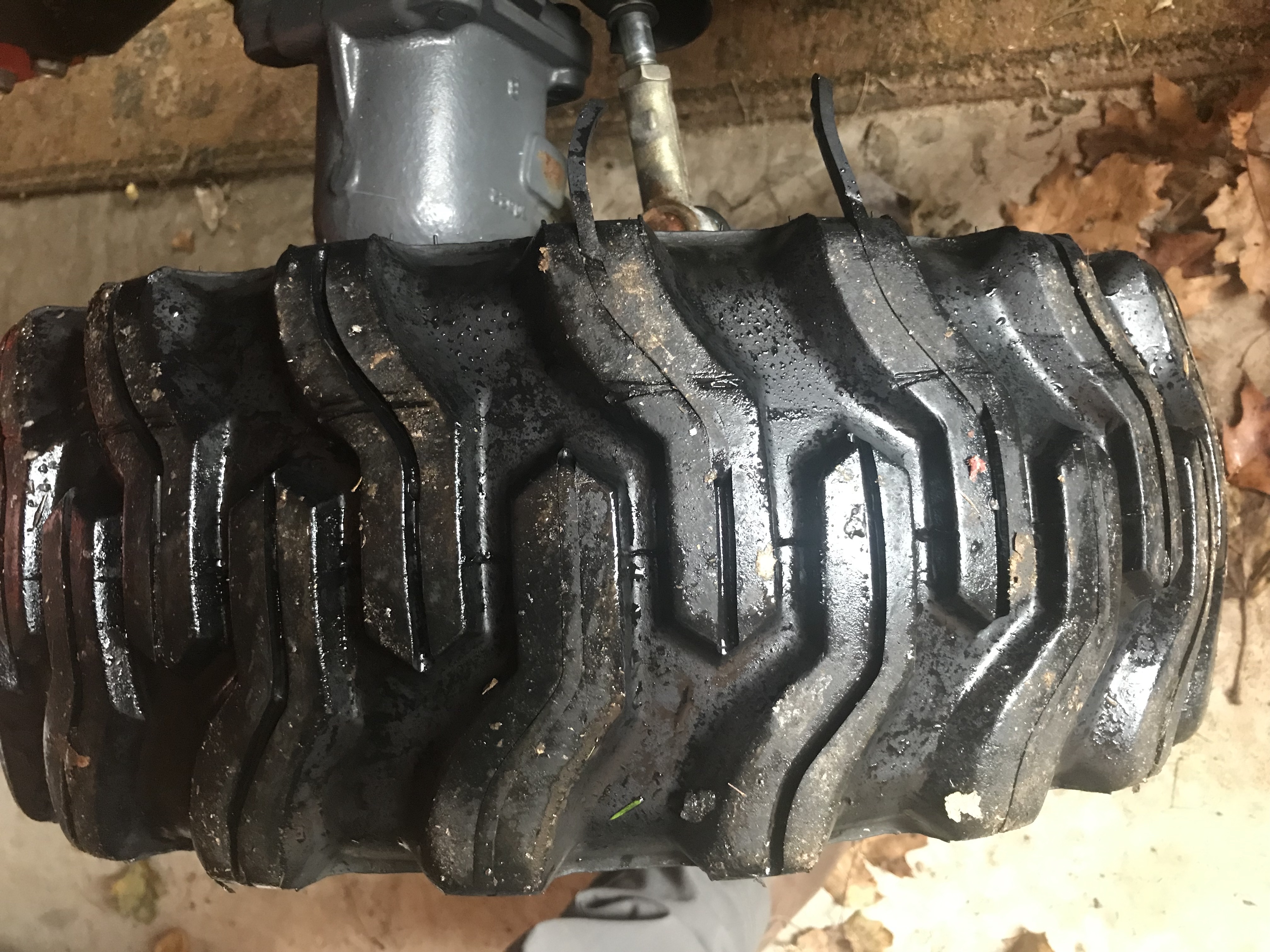

Groove or Sipe and do you have a picture of how you grooved them?
Thanks
   / R4s vs R14s Tested #28
I grooved mine. Not sure if I said in this thread - I never ran them ungrooved, so I have nothing to compare it to.
Like this:

That picture is a good "testimonial" for the benefit of grooving. :thumbsup:
