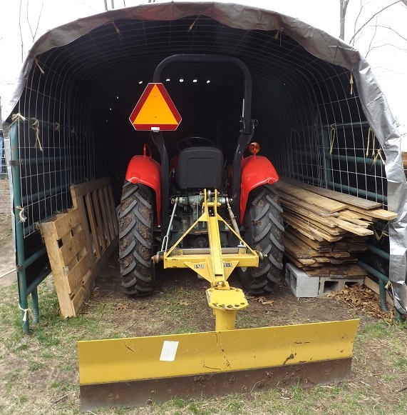

For under $300, I made this from 3 coral panels, 3 cattle panels, zip-ties and 1 huge tarp. It's going on 6 years now.
Then came the add-ons later. oh boy.

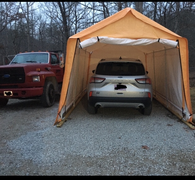

Put one up for my daughter in law over Christmas.
I used gravel to level the pad area.
Counting the rock and all Ive got about $250 in it. Purchased the carport on sale.

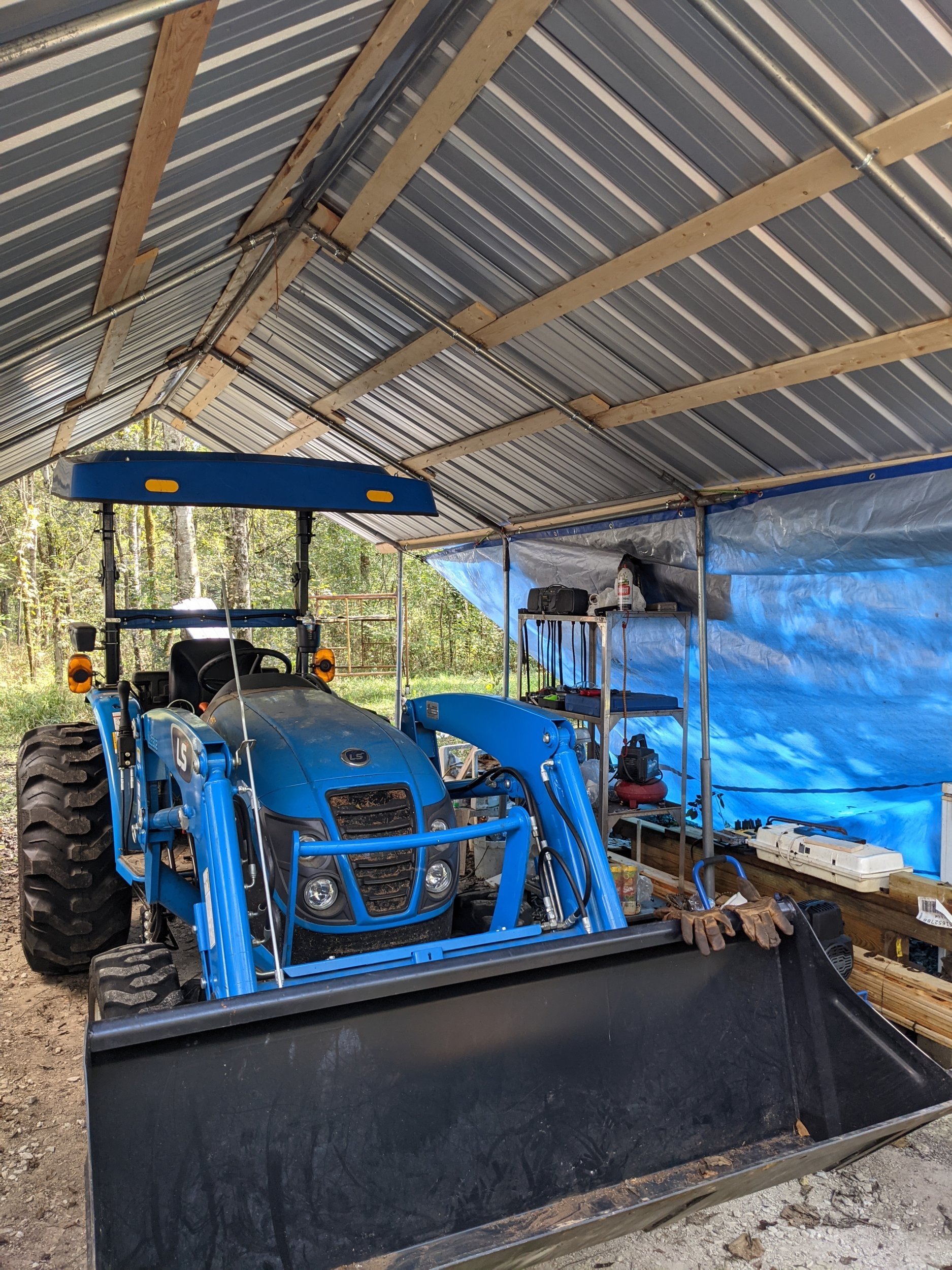

When my 2nd cover wore out I decided to upgrade to a metal roof.
I purchased the material from a local metal fabricator for less than a big box store. Total for all material was around $350. The blue tarp area is now a 20ftX8X7 attached covered area for lawn mower and other stuff.
