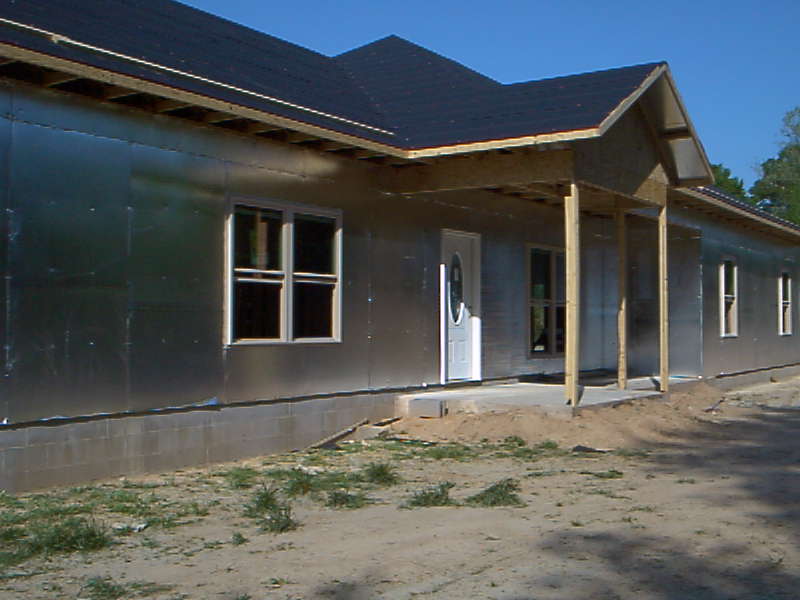

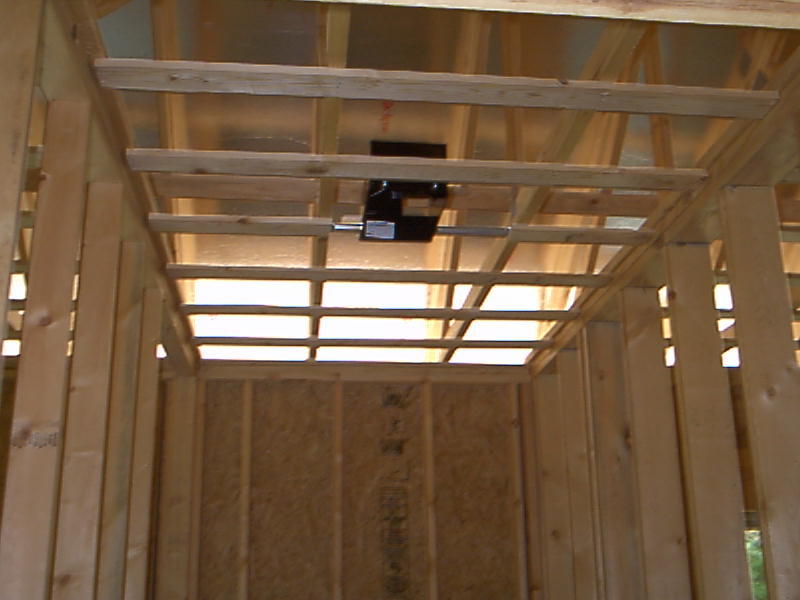

A radiant barrier will help with attic temperatures during the summer but without some ceiling insulation it wont be enough to keep you cool in summer or warm in winter. I have the radiant barrier in the ceiling of my shop plus bat insulation between the rafters and in the walls and the mylar radiant barrier on top of the insulation. In my house, I have the same but with bat insulation between the rafters, then 12-18" of blown in fiberglass on top of that then the mylar film radiant barrier on top of the blown in insulation. The roof has radiant barrier full length from center ridge vent to soffit eaves.
You can see in the second photo how the front porch has it installed also in total roof area and walls. This actually went on first then the roof decking on top of it.
My shop just has 8" bat in walls and ceiling and of course the roof radiant barrier with the mylar radiant layed loosely on top of the bat insulation. This was an after build scheme that we went for in hopes of saving additional energy costs. Not sure if it is helping much more than than just the barrier and insulation and it was super costly. Possibly I should have just invested in more insulation for the cost. Insulation is cheap compared to energy cost.
My shop does pretty well with what it has and stays above freezing with no heat and comfortable with a 1500 watt heater running during winter and that only runs part time. Summer time, I can cool the whole thing to a comfortable 80F with a 14,000 BTU window unit.
