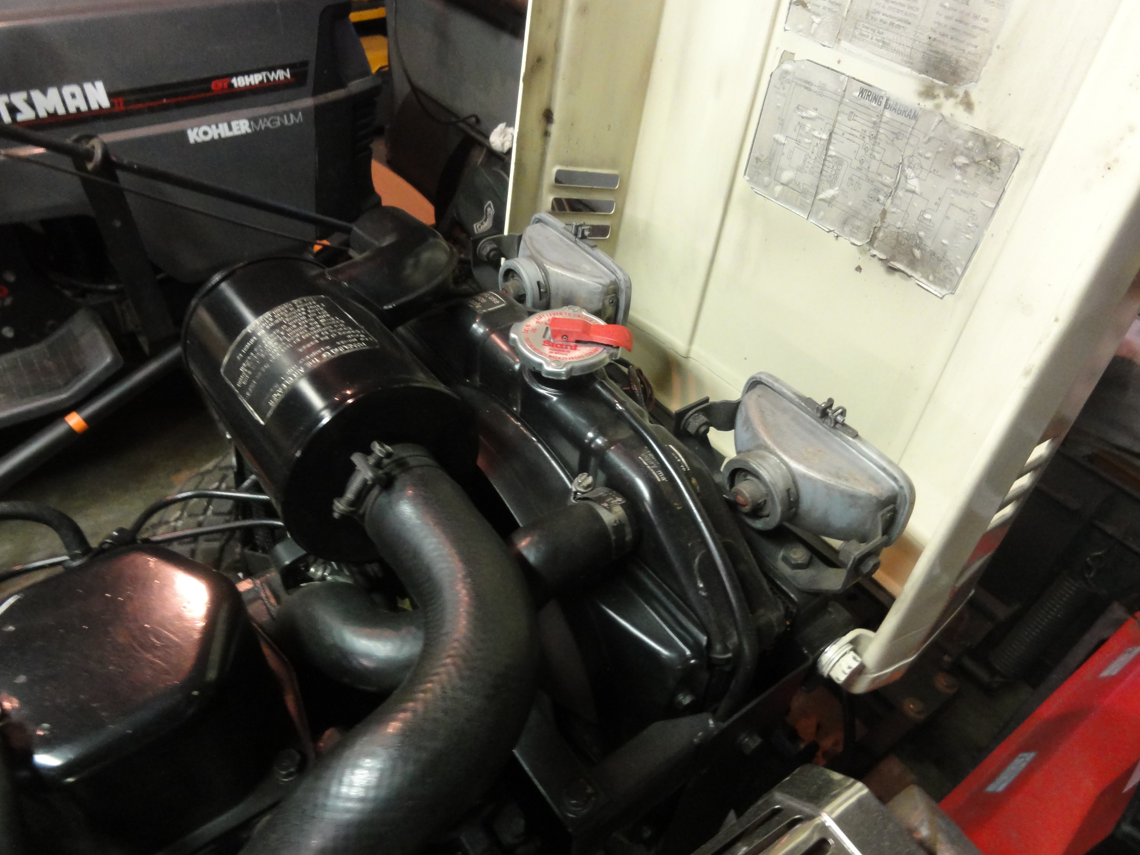

I'm getting set to flush the antifreeze in my Bolens 1502/Iseki TX2140 and I'm not happy with the looks of the radiator cap. It's pretty ugly but still working.
Does anyone have a cross reference to a replacement one handy ?
/ Radiator cap ? #2

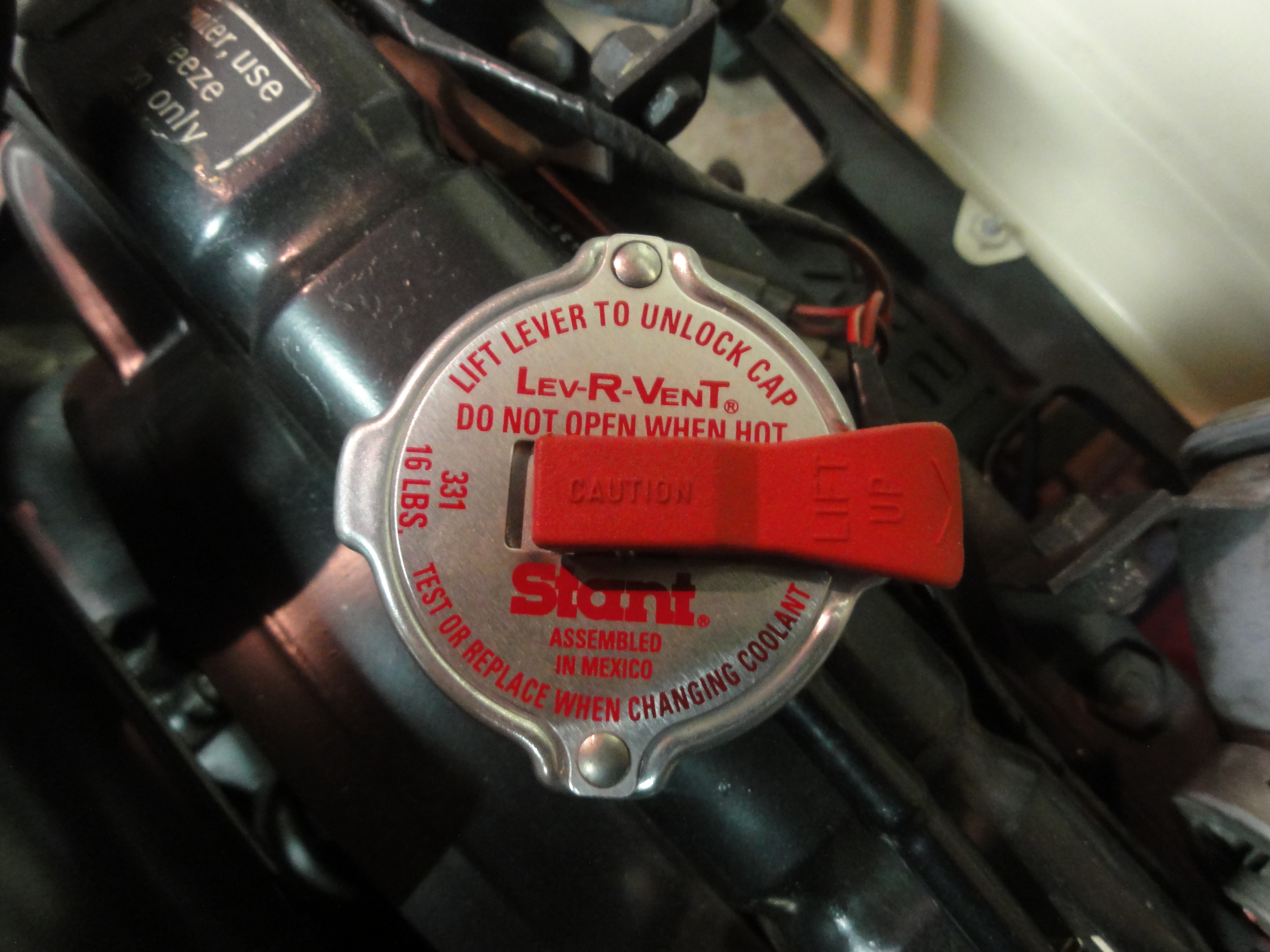

I have a Stant brand cap on mine. Its model number 331.
I bought that cap new at wal-mart and its been on there
for about 5 years now. I have not had any issues with that
cap at all.

Thanks, I did finally find your post from a ways back. The search function here pulls in a lot of results, so it took some time.
My local NAPA guy turned up a Balkamp 703-1702 that looks just like that one in the pic with a different label. It is 16 lbs too, and seems to fit fine.
