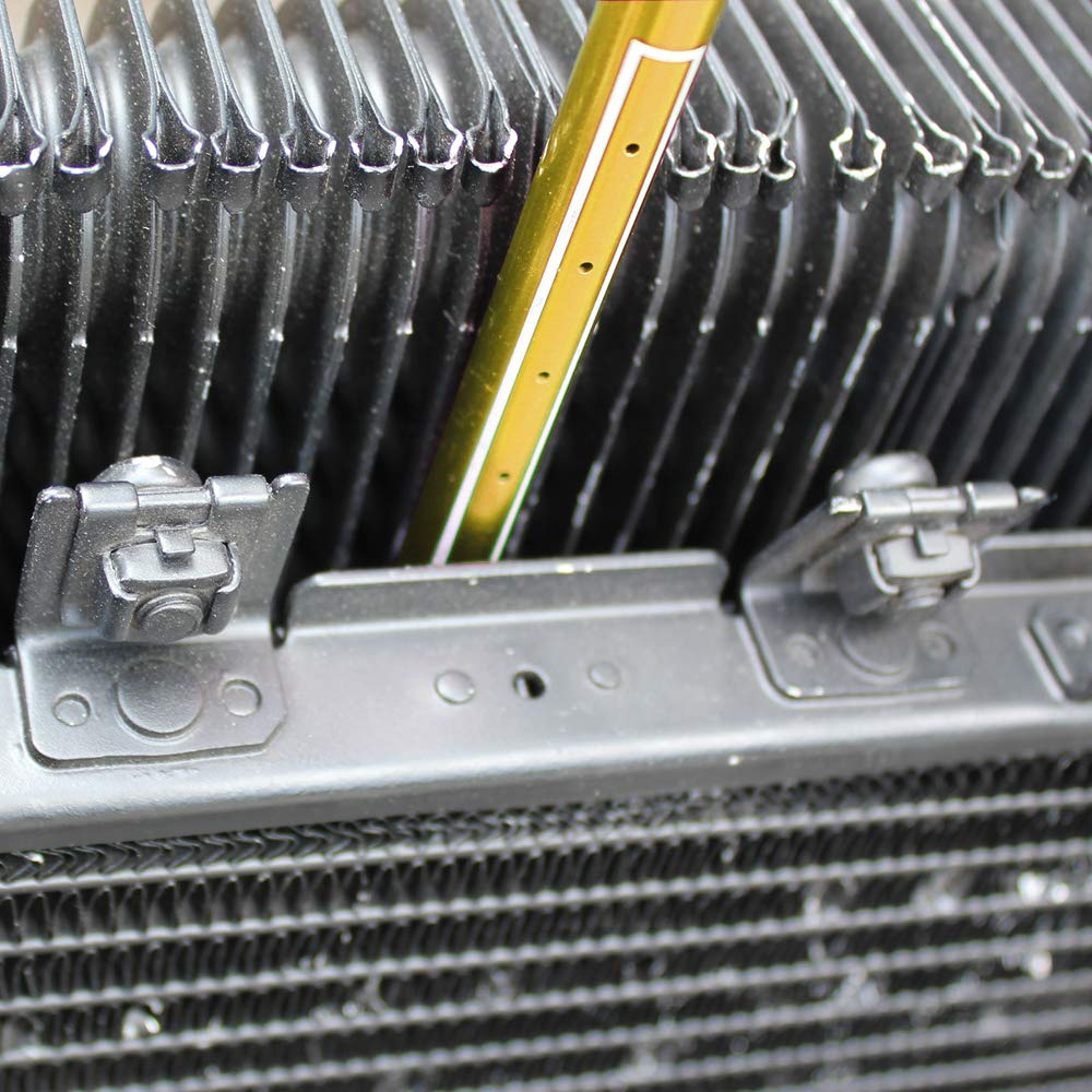

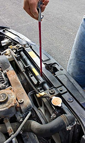

I bought an air comb radiator cleaner from local K dealer. Nothing could keep the A/C running when we were haying. Blowing from the front with air or water did no good. Using the air comb from the back and presto the A/C works. $40.46 from amazon, less from dealer.
Been using radiator genie tools for cleaning radiators and air filters. You get both an air and water wands. Best tool for cleaning the shop floor, blowing dirt and grass out the door. Just bought a air comb to try too. Thanks for sharing.

Check out a tool called radiator genie. It makes the cleaning easy.
