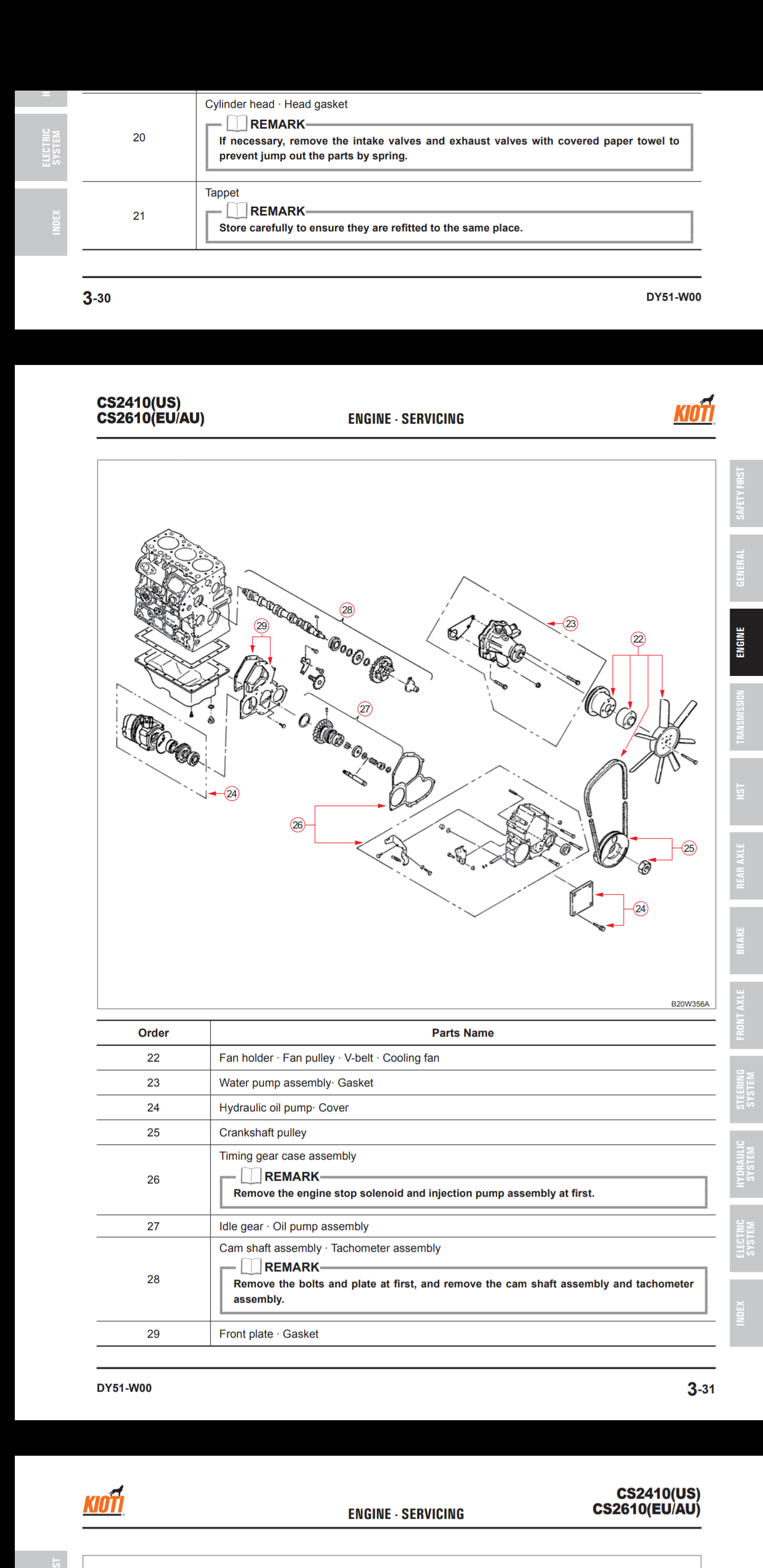

I'm not sure if your question is directed at me, but I think I've mentioned several times since my initial incorrect assumption that the radiator fan is belt driven off the engine. That's why in my last couple posts I have been looking for peoples' input in to how/why the radiator fan shuts down briefly (3-15 seconds) before spooling back up.
As far as the HST slowdown, thanks to @crashz , I did some googling for pedal adjustment Kioti and what came up instead was a fairly common issue for these Kiotis to get bent reverse pedals that reduce the allowable travel. I checked last night and this certainly seems to be the case with mine, it's only an inch off the deck, so I will try bending that back or having dealer order me a new one since it is still under warranty. So thanks for getting me on the right path with that as far as reverse speed, but it appears to be a different issue from the fan.
The mystery still remains about how its even possible for the radiator fan to shut down. I will check engine mounts, but I think if it was hitting its shroud, I would here the THWAP THWAP THWAP of the blades making contact before their motion was stopped, which I don't, but I will check the mounts as well as the inside of the shroud for signs of contact from the fan blades.
Attached is the only diagram from the service manual that shows the fan assembly.

If the fan is slowing down and the engine speed doesn't drop at the same rate as the fan slows down, then you have a belt slippage problem. That is usually caused by something binding, and if there is no noise from the fan hitting something, this points to an idler pulley starting to seize up, or your water pump doing the same. Loosen the belt and see if idler and water pump rotate smoothly.

You probably already know this, but just in case, note that the fan is mounted on the waterpump shaft.

The radiator fan is solidly mounted to the water pump flange and driven by the belt. Any change in speed without change in engine speed would be belt slippage as 07 mentioned. i saw no clutch mechanism in the parts diagram you posted. Or its remotely possible that the fan center is broken.
The first thing I'd check is the belt tension, and see of the fan can move freely when the engine is off. If the fan moves under finger pressure, the belt is either not tight or glazed to the point of failure. Most importantly is that the water pump may not be spinning when the fan cuts out, so you could have a real overheating issue there.
Your machine is new, so a little belt stretch isn't unreasonable.
