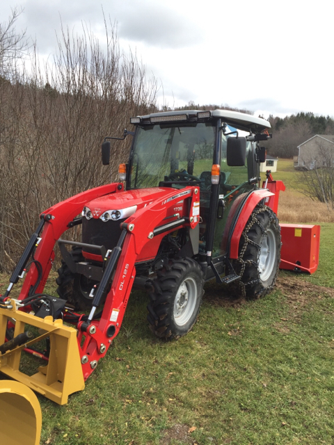

The LED lights I installed interfere with the radio causing static. Has anyone had success with using ferrite core snap on assemblies?
The lights are currently connected using the factory wiring in the cab for the front and rear work lights.
Or, do you have other solutions?ImageUploadedByTractorByNet1456109002.224974.jpg
