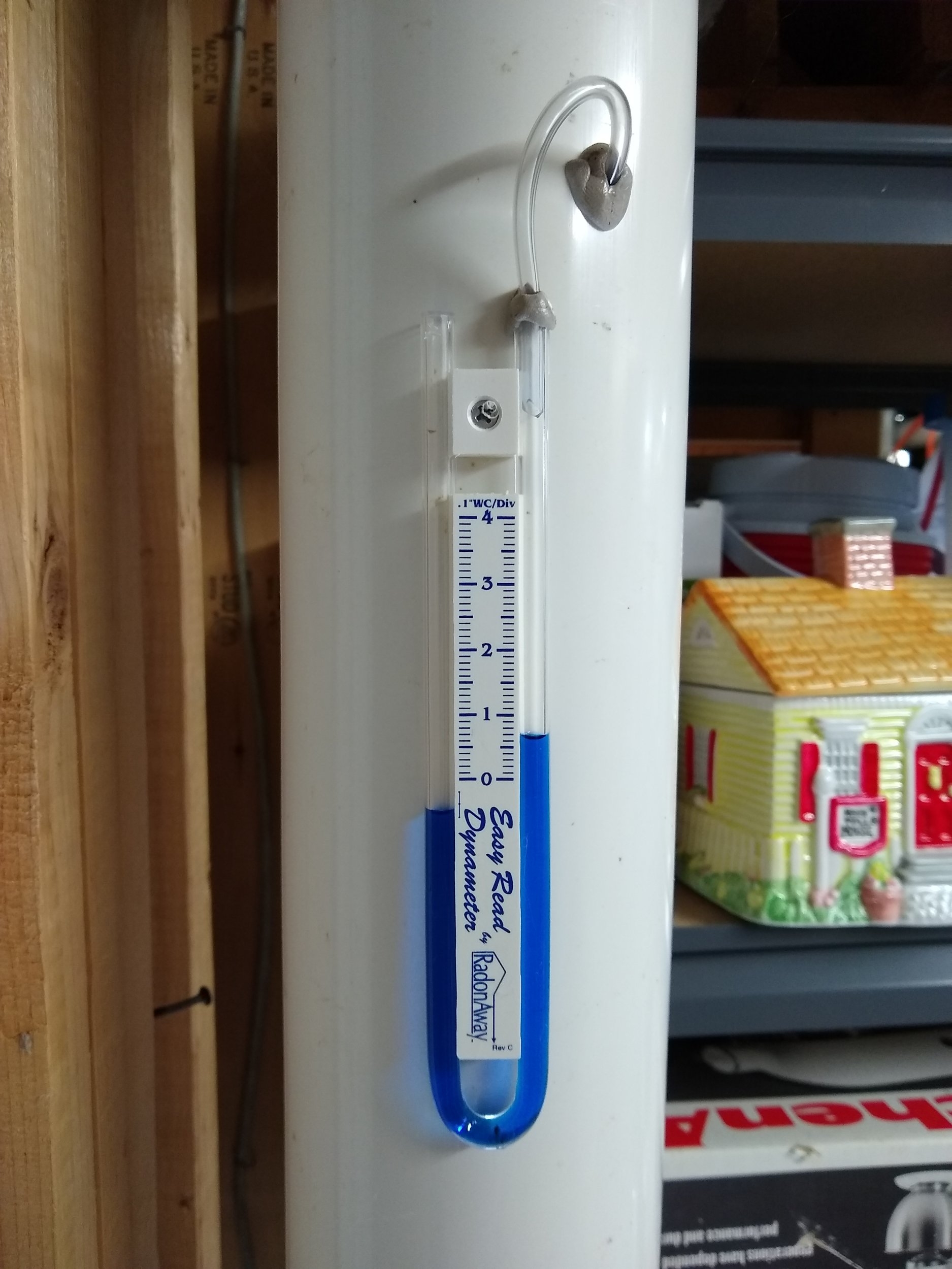

I have been told the sensor is only good for about 3 years for the particular meter I have. I don't know how accurate that is though.
/ Radon pump install #25
I'll like to know... Google says 10 years. We have had ours for 5-7? years. Happy with this reading!!
