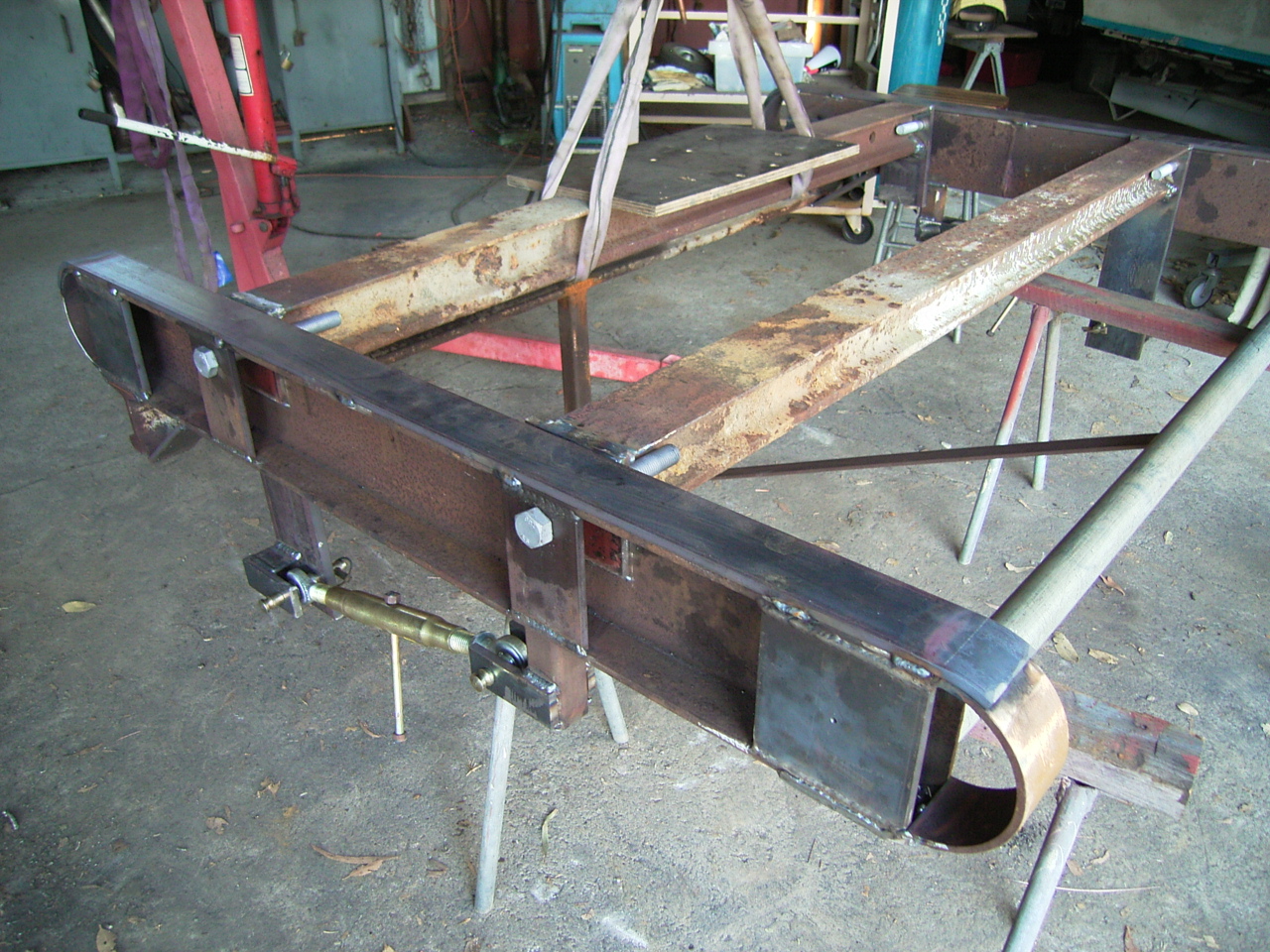

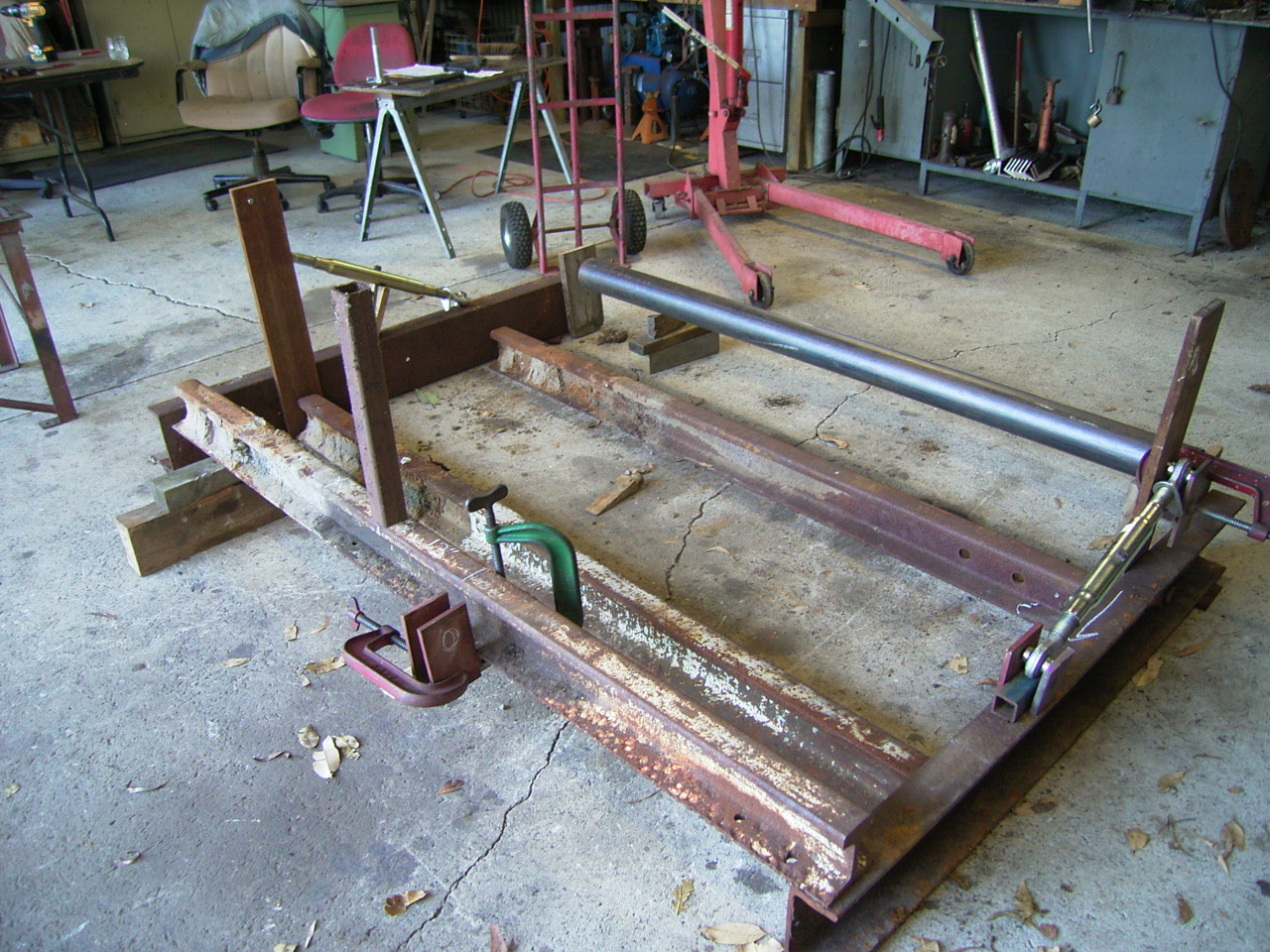

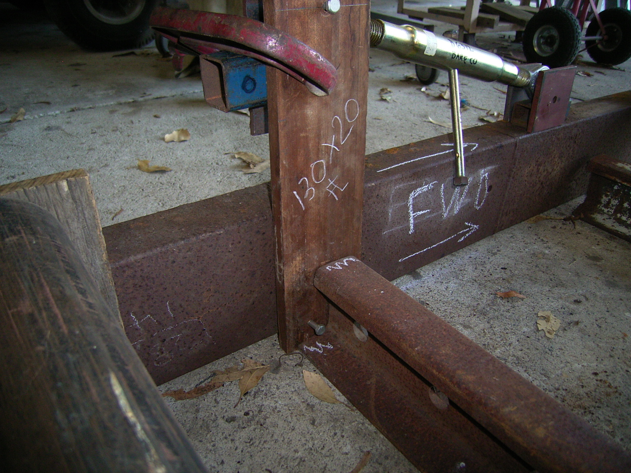

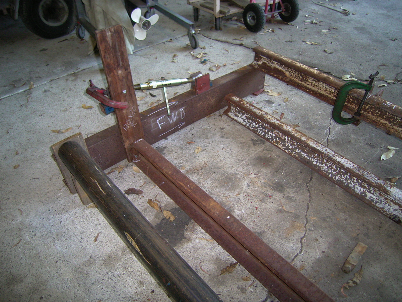

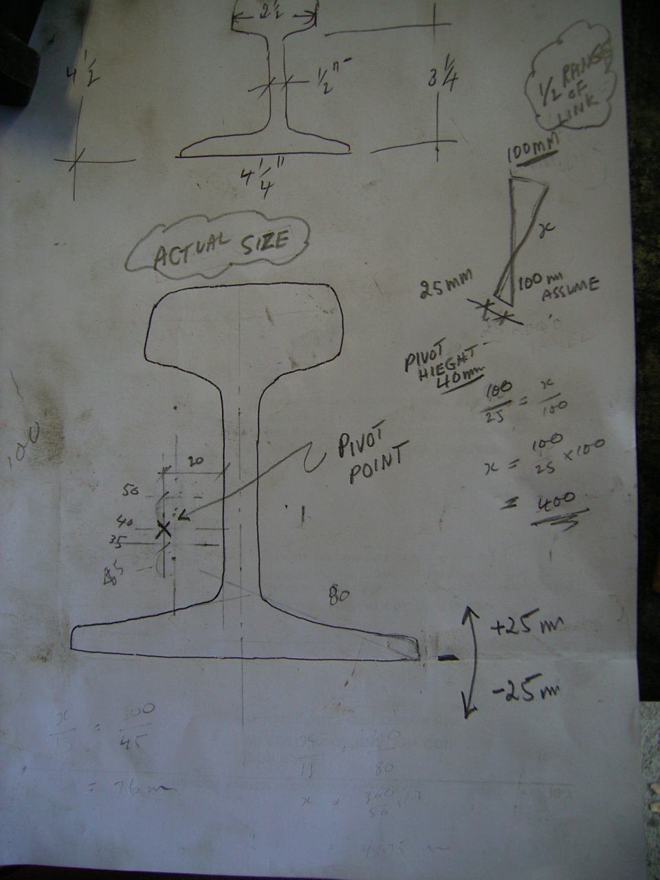

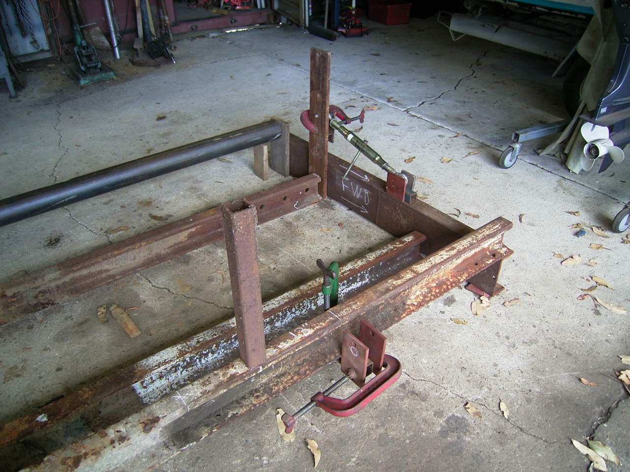

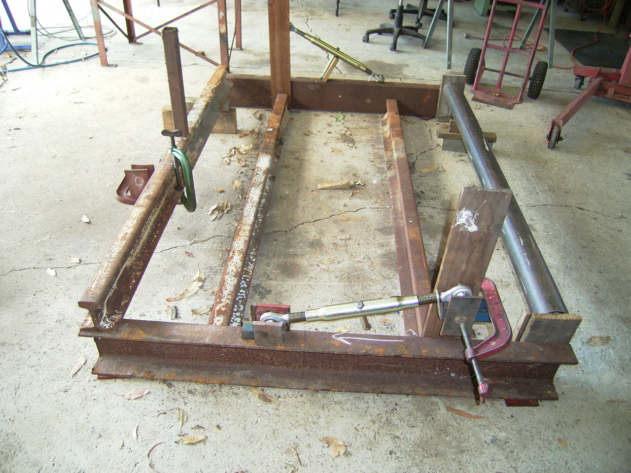

Finally I got to spend some time this arvo to mock up my landplane.
Insiration has come from tractorbynet member builds
Obviously I am using what materials I have on hand wherever possible, hence the rail iron.
my build  22 feb 2013 007.jpgmy build  22 feb 2013 011.jpgmy build  22 feb 2013 017.jpgmy build  22 feb 2013 018.jpgmy build  22 feb 2013 021.jpgmy build  22 feb 2013 022.jpgmy build  22 feb 2013 025.jpg

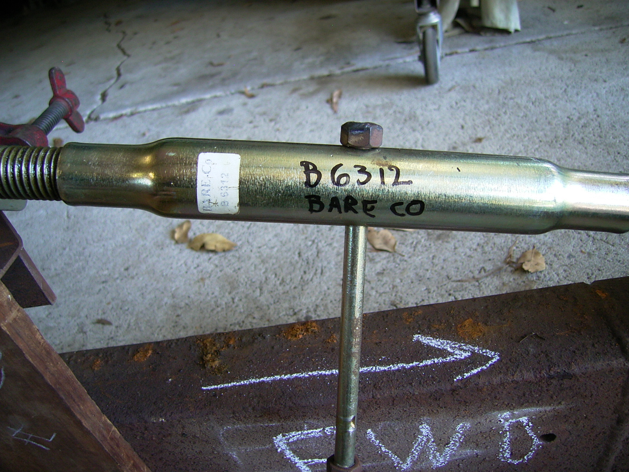

If the top links don稚 cut for adjustment I will go for bolts as per orezok's design, hydraulics would be gr8.
The plan is to pivot the front edge of the rail iron up 25mm and down 25mm from level, which should allow for all gound and material conditions.
The final build will have gussets and reinforcement.

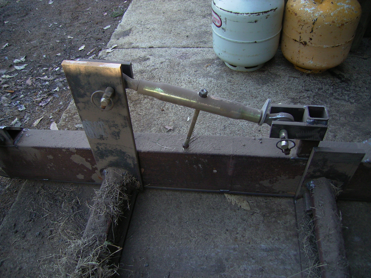

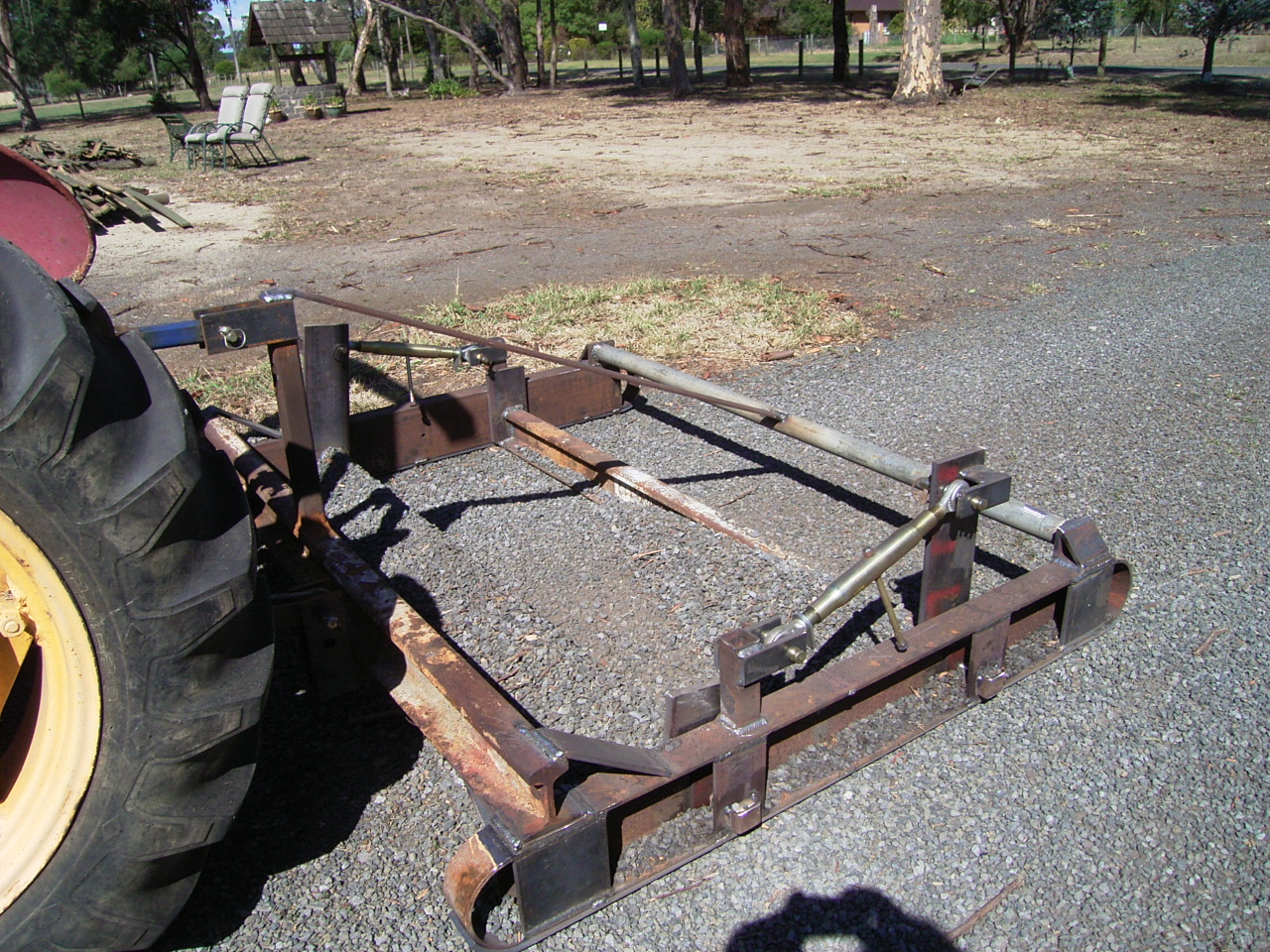

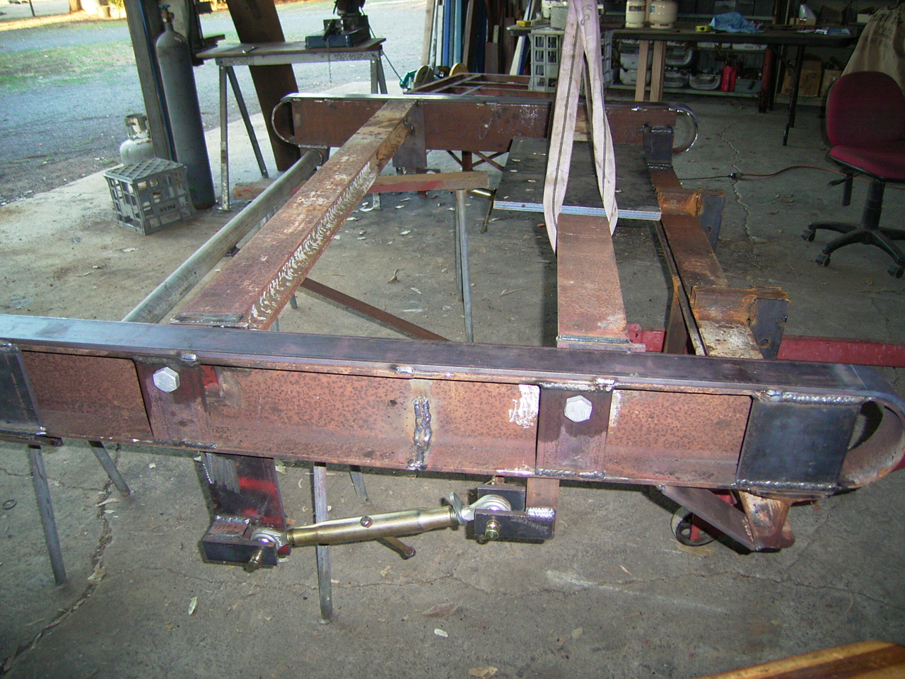

Nearly finished, make four 1" pins tomorrow, tip it right way up and go try the theory.
Summer just finished here so ground is hard.

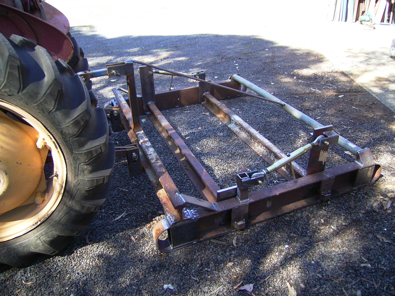

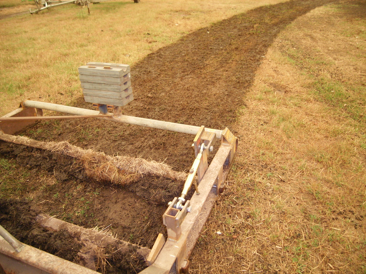

Finally finished today.
These things find the high spots on roads.
Blades were tilted back when leveling track. (Material relatively loose)
Paddock work required the blades to be tilted forward, but ran out of time as it was beer o'clock.
I have had planes before, adjustable blades seem to be the way to go.
Might consider front blade being controlled by hydraulic ram.

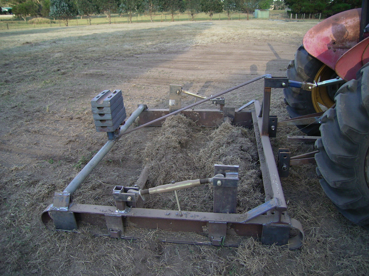

Never worked the weight out first as I have had 3 pt hitch smudgers (Landplanes) before.
Just piled the 3 lengths of rail well back on my rear forks and drove it around to see how well it steered and lifted the weight (MF35 with 3 cyl Perkins).
It is flat land here, but would build it lighter and longer for hilly country.
The Rail is 60 lbs per yard, 2 @ 6' and 1 @ 6' 6'' so about 370 lbs total for rail alone.
But after using it decided it could do with some weight on the rear so added a frame to hold 5 x 30 lb bricks from an old heater. Weight is comfortable when raised but will not go heavier.
The rear blade is now more effective and the hole thing less inclined to tip forward when the front blade digs in hard, note I am using a drop down top link. It is not really practical to lower the lower hitch point as the plane would lift of the ground when the front of the tractor dipped in a hole.
Cannot tilt rear blade down enough, need to cut off rear blade adjuster anchor post and move it forward 90 mm a mistake I made thinking the front and rear blades were exact mirror images.
