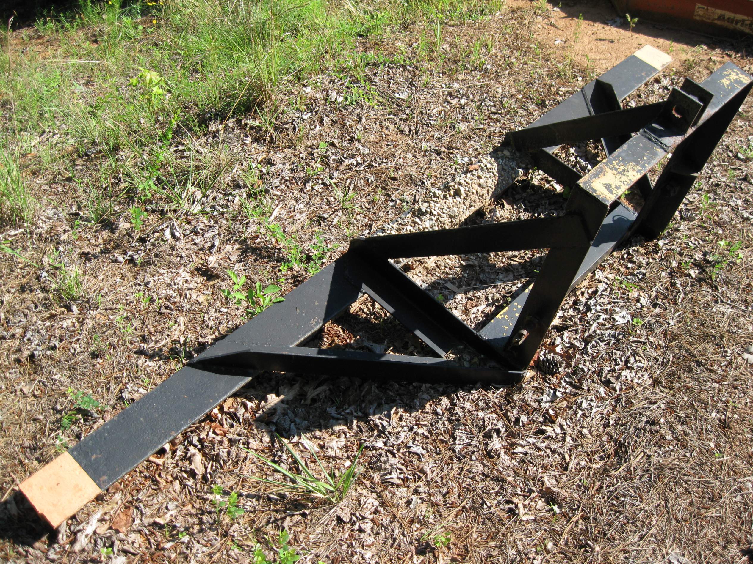

I will let you know how it goes. Made it yesterday afternoon out of 16' piece of rail. I need to smooth out my pasture for sprigging.

I wonder if you could weld stubs of rebar or 1" square stock, 4 inches long, extending an inch or 2 off one bottom edge. Maybe 2" apart. Then you could drag it with the teeth down to scarify a pasture or break up rough ground, or turn the rail over and drag the smooth side.
If your looking for teeth. Go down to any old rail line. There are lots of spikes lose on the ties or laying on the rock. They work perfect for teeth. You can even weld on some hard face for added dirt ripping life.:)

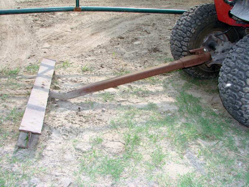

   / Railroad Iron Drag #18
I know that this is thread is a little old, but here is a pic of my drag.
   / Railroad Iron Drag #19
What are you pulling it with? :)
