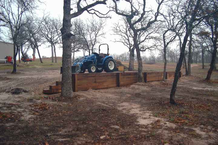

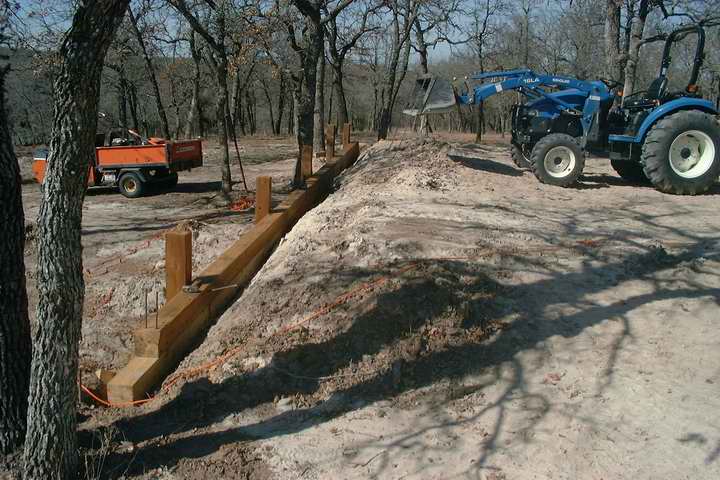

Jim, about two years ago, I built a small retainer wall about twice the length of yours. I thought about using railroad ties because I have a source of ties in very good condition. One of my neighbors suggested I check with a local sawmill because they buy old telephone poles and cut them into 6" x 6" beams. I wasn't looking forward to stacking and handling crossties with their inconsistent surface conditions, splinters, and other irregularities, so I went to the sawmill and bought 280 feet of the 6x6 beams. It was $1.95 per foot, so I put close to $600 into lumber, but I'd do it again in a heartbeat. Here's why...
1. The timbers were 11' to 15' feet long and the varied lengths came in handy during construction.
2. The long lengths reduced the number of posts I had to sink into the ground (5 posts sunk 3-1/2 feet deep for over 65' of wall)
3. The 6x6's stacked perfectly with very predictable dimensions.
4. The timbers were easy to cut to length and drill for fasteners without any worry of finding hidden rocks and metal.
5. I think the finished product looks far better than any crosstie wall I've seen.
I'm in Sunset, TX which is about 60 miles north of Fort Worth, but maybe you might find a sawmill in your San Antonio and Austin area which does the same thing. Your cost would be only about 1/2 mine and I think you would like the results. I'm attaching a couple of photos to show you my wall during construction and the finished wall. /forums/images/graemlins/cool.gif
   / Railroad Ties for Retaining Wall #16
...finished wall.
