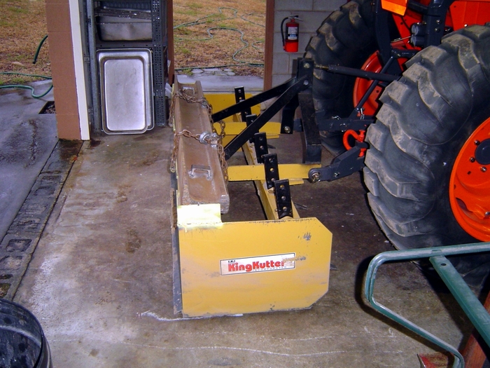

I also have some pieces of rail. Some long, some short. Here's one piece I keep on my box blade for added weight. The rail piece, (6 Ft), weighs around 300 pounds. I welded a holder for it on the box blade. I unchain it to take it off.
