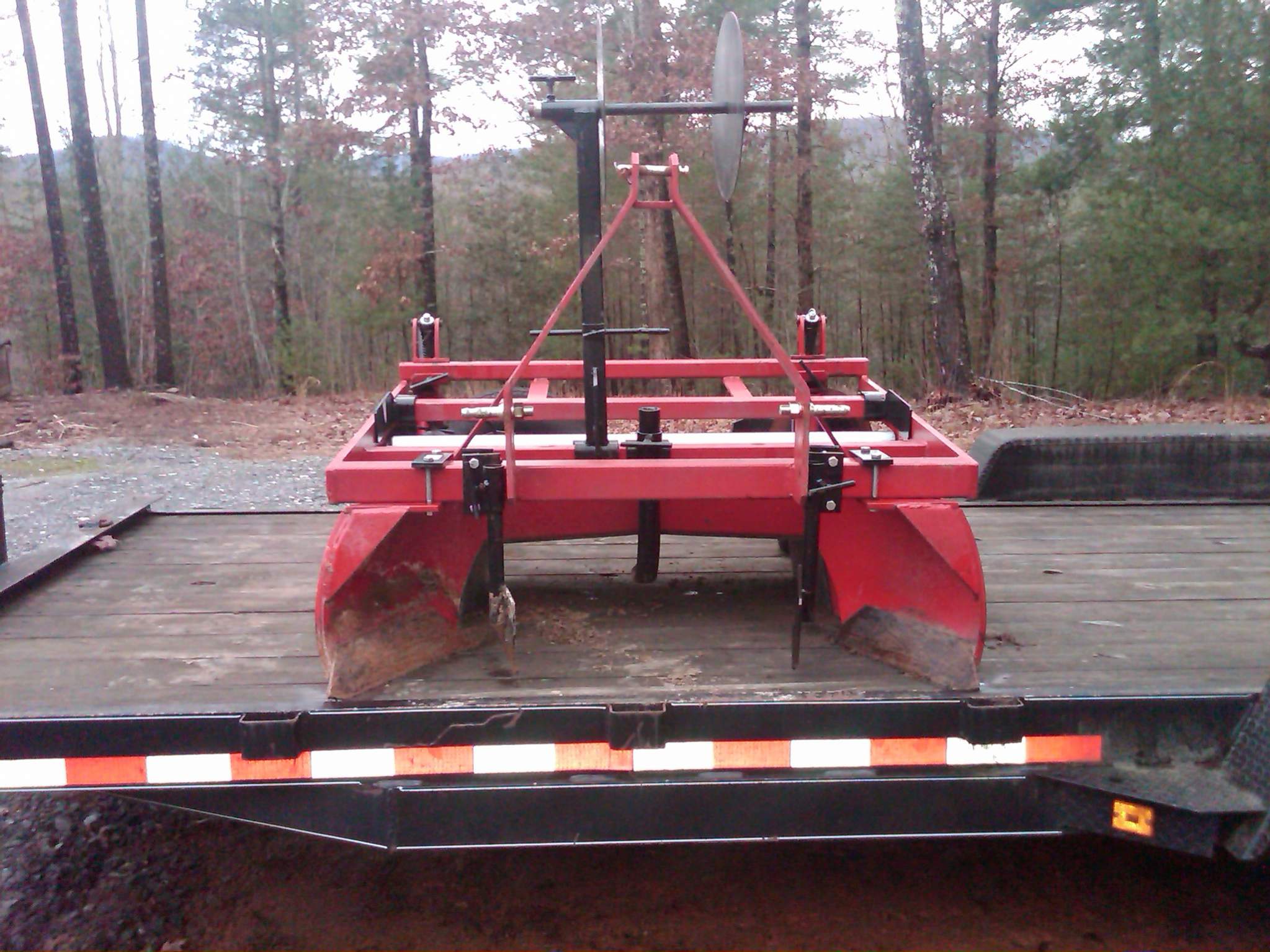

I did look at it but found this one from Berry Hill Irrigation. http://www.berryhilldrip.com/Mulch-Layers/
It will handle the 48" plastic.
Couple bought it and only used it for about 10 rows of strawberries one season.
I have not tried it yet but it should work fine his tractor was the same size as mine.
I think the 2400 from Rain Flo has the water tote on the front to add weight??

I have seen the red one on berry hill before. I think it is only for flat beds. The rain-flo 2400, 2550,2600 has the ability for making raised beds. The 2400 model can make 5" bed which is perfect for my 40 HP tractor. The rain-flo 2550 and 2600 requires a heavier tractor with more HP.
The one from Berry Hill make a 4" raised bed.
