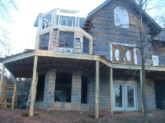

I might need to put new guttering up when we add this new section. I will NOT have easy access to a higher part of the house (main roof) without climbing onto another roof.
The pitch of my roof is 12/12 and I really do NOT want to do that. Thus far, I've been using a 24' ladder, fully extended to reach the gutters.
I'm wondering if this rain handler might be a better idea for the main roof, allow the water to then spray to the new roof that's going over the deck and have traditional guttering from there down to my drains away from the house (I've got scheduel 40 pipes taking downspouts away and into the woods)
Would a 12/12 pitch help or hurt the logic of the rainhandler system?

/ "Rainhandler" anyone using it? opinions?
Here's picture of the front...you can see without the deck there why I don't want to walk on the roof!
Now, what you CAN'T see here is the second roof. We're adding onto the kitchen on the left, sort of an octagon shaped room in logs. There will be a roof over that blends into the existing roof somehow. I've attached another picture showing where they've started to remove the existing roof parts.
On the RIGHT side of the house is where you don't see the 'new' roof. We are going to add another roof that will tuck in underneith the existing roof... this problaby isn't making sense.
Trying again.. on the right side of the house, we will have some ceiling joists attached to the wall, above the windows, yet below the current roofline. So, I COULD take the existing guttering off the existing roof and the water will simply fall to the (not yet existing) new roof. Then, on the new roof, I could take my guttering/downspout to where my CURRENT downspout is, and let it be taken away from the house.
It's on the UPPER roof section that I'm wondering about either:
A) taking ALL the guttering off so I won't ever have it clog up on me and let it fall to the "lower" roof... or
B) install soemthing like this rain guard on the UPPER roof, so the water will 'spray' onto the lower roof, easier than simply crashing to the lower roof...and then still, allowing the guttering to collect it on the lower roof and take it away.
In no way, do I plan nor propose, allowing anything to let the water spray or dump from any roof, down to the ground. ONLY from the higher roof to the lower roof.
Unfortunately, the lower roof doesn't yet exist to help illustrate this.
Cleaning out the guttering on the left/right side of the house is a REAL pain in the hiney and always an exercise of telling who ever is with me (if anyone :eek:) "the first thing you do if I fall is see if I'm breathing, then call 911 right away"
I really want to get away from ANY need to be on any of the roof if at all possible.
Hence, my wondering if I could use this rain guard on the higher side only?

I had a situation where one roof stopped above another and there was no gutter on the upper roof.
The water from the upper roof hit the lower one, splashed back and rotted out my wooden windows. I could tell it was rainwater because it only rotted them on the bottom part of the windows, where the splash hit.
When I rebuilt the house, I gave the upper roof a 2' overhang, which cured the problem...

perhaps not a serious worry in TN but farther north... what happens with ice.
ever seen icicles hanging off the edge of a roof? now you give the ice a 4" wide space with slats to build up on? I can see that thing holding on to like 30lbs of ice per liner foot Perhaps not huge issue for the plastic rainthingie, but your lower roof would NOT like the impact after the rainthingie breaks away from the facia and crashes down on it carrying with it hundreds of pounds of ice.
i say just remove the upper gutter and let the water fall on the lower roof. then deal with it there.
if worried about long term cleaning go with gutter caps. Still not convinced they work in heavy rains, but a lot of my neighbors have them and are happy with them.
