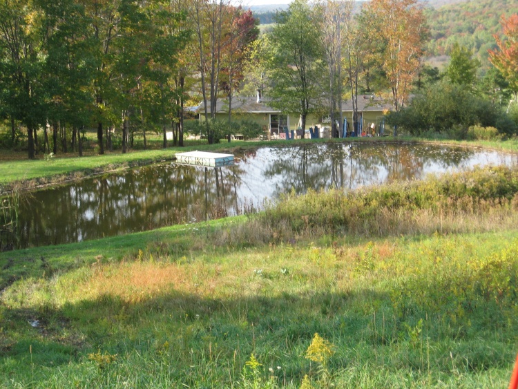

   / Rainwater collection system #7
This is my rainwater collection system. It collects water off about 6 hillside acres.
