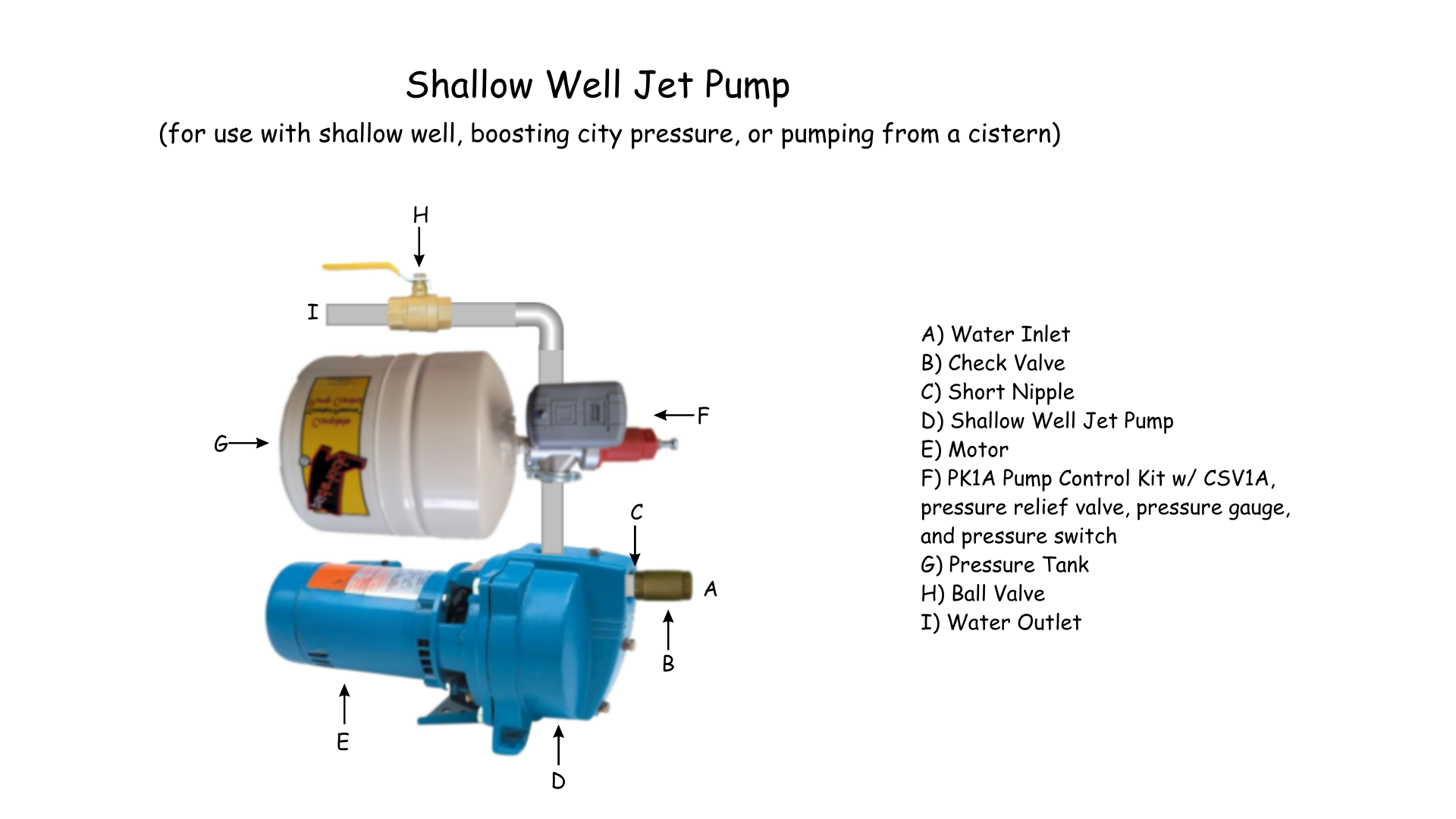

Sorry, maybe the question was buried in the details.
I understand what needs to be done, the question was how.
Do I use the Schrader valve in the Tee? There is no other place to air up the tank.
Thanks again.
Patrick
Yes, that Schrader can be used to put air in the tank. With a booster pump and no air charge system you will need to add air on a regular basis. Big tanks will slow the cycling but a Cycle Stop Valve will completely stop the cycling while irrigating. The CSV works with a small diaphragm tank that would not need periodic air charging.
   / Well Pump Pressure Tank Fill? #12
Add air at that sniffter valve on the bottom, in your picture.
Air should be 2 psi below turn on psi.
Be careful over irrigating, you may run the well dry.

Thanks everyone! I drained the tank and charged it with the valve in the tee. Pressure spread was off, so I adjusted and now it's 40/60psi with much slower cycle times.
