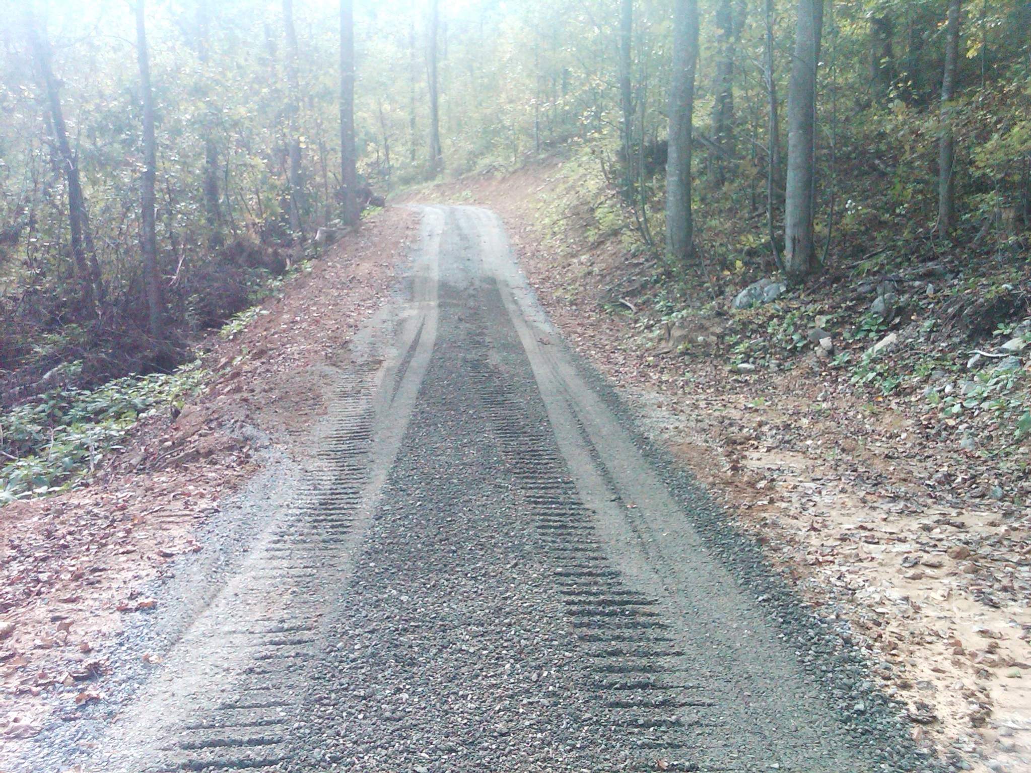

I had to put in a new easement road to my neighbors "extra" 10 acres since I used the old one as a driveway to my new pole barn. Here is what I got for $3K through approx. 600' of forested hillside. I only had to put in a rough road not a finished road as that is what I took over. But you can easily see the base rock which came from a small pit on my property so that kept the cost down.
You can see the culvert (black plastic) on the right side of the photo. I am actually going to have it pulled up and reset as the uphill side is not deep enough to collect the water flowing in the ditches.

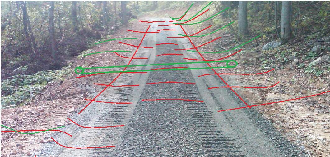

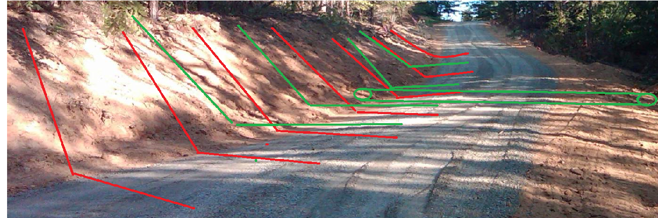

One issue that the OP will have to deal with, and which was a problem on my place, is that repeated traffic, especially when the soil is wet, will create depressions/channels in the road that can gather runoff and lead to washouts. Expect this to happen and be ready to correct it (eg recrown the lane). Adding gravel over a number of years can slowly build up the road base until this problem largely disappears, but without a very large front-end investment, you need to expect to do a fair amount of annual maintenance until you can get things stabilized.
Proper crowning, ditching and culverts will help a lot. Bare ground along the road needs to be vegetated to stabilize it. Also, having the brand new, totally uncompacted road surface exposed through the spring thaw is likely the worst-case scenario; with some modest upgrading (and use!), these issues with the road shouldn't be nearly so bad in the future.

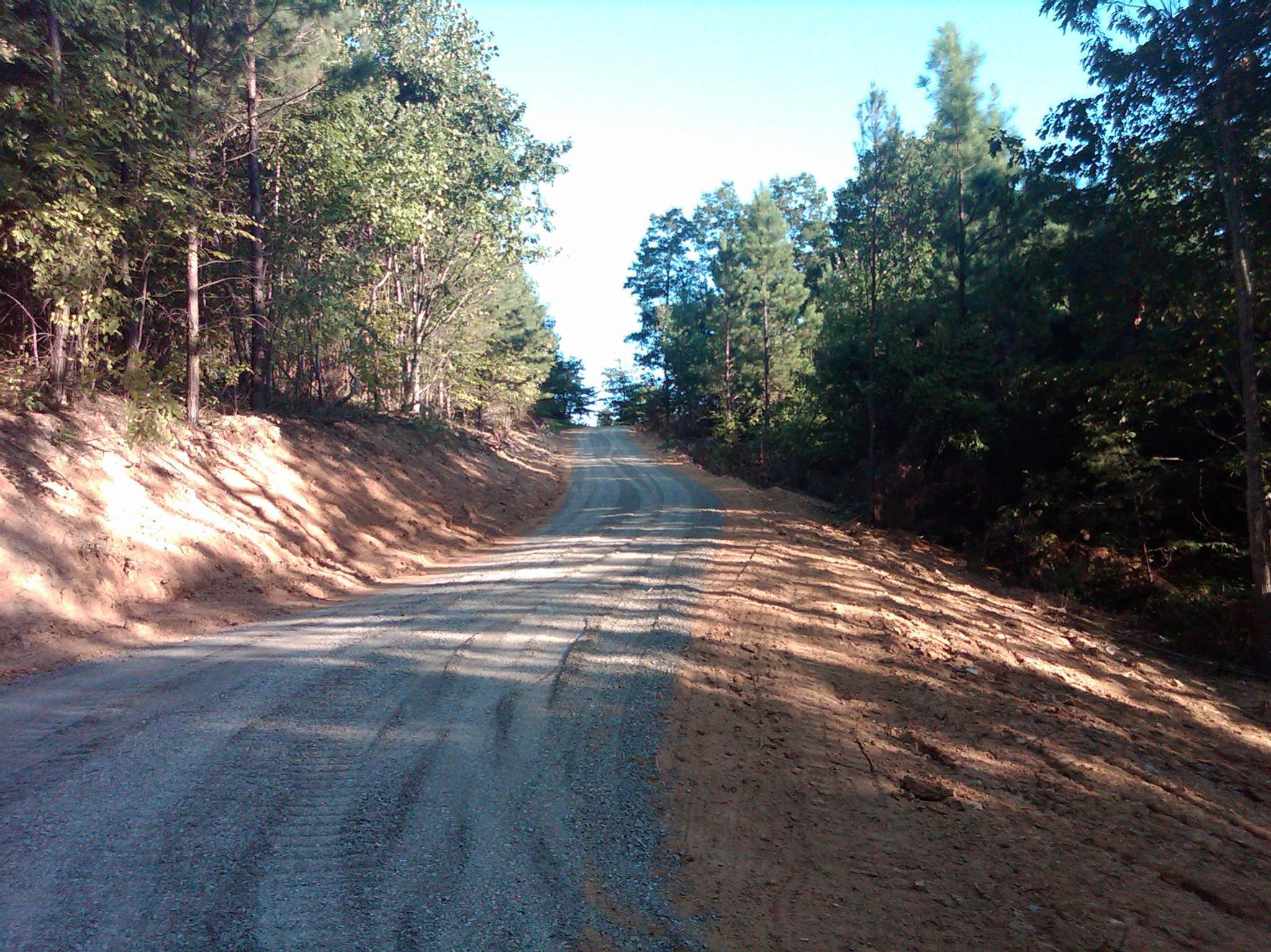

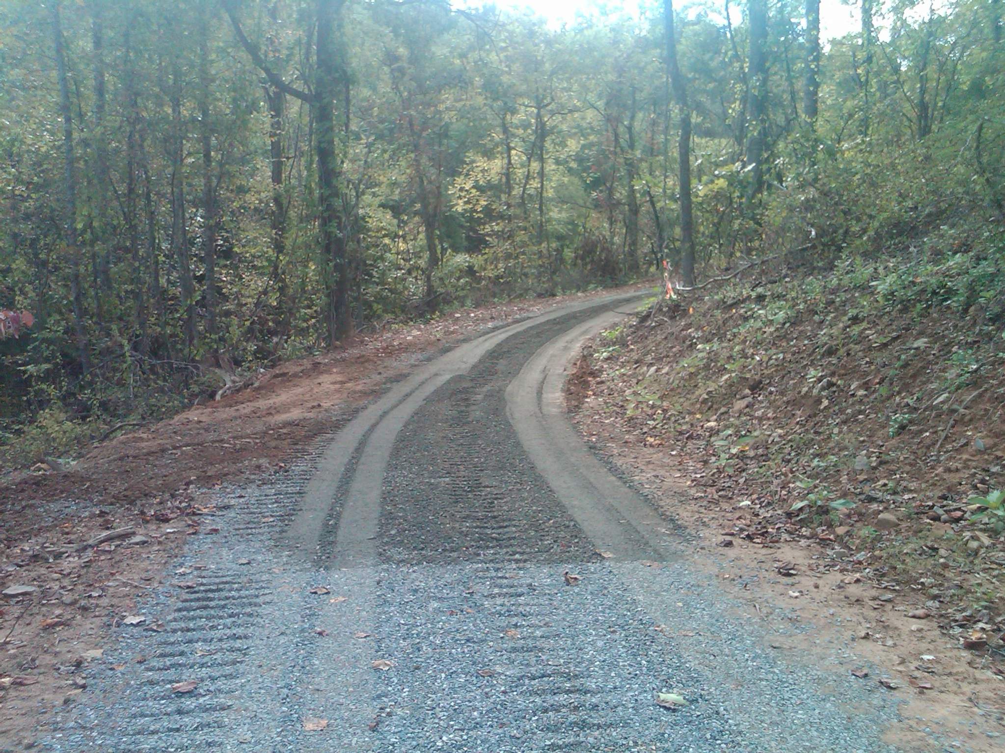

Wow, what an example of how not to build a road. Looks like a cut and fill operation with a dozer. (Cut and push the high spots into the low spots,sprinkle a little gravel on it and call it an all weather road):ashamed: Also looks like little or no base under that crushed rock. Whenever fill is placed, it should be placed and compacted in lifts ( layers) of about 4 inches at a time, then 4 inch or larger base rock should be "walked" in with a track machine or roller. This, of course, has to be done while the soil is somewhat drier than it is now. Even though you're across the country from me, the soil and topography looks very similar. My opinion at this point would be to basically start over with the grading when the ground dries out. As mentioned before, ditches are mandatory wherever water is present beside the road. I can't stress enough that the driving surface of even a private driveway should be at least 18-20 feet wide. This allows you to drive all across the surface to eliminate wheel ruts and the problems they cause. Yeah, it's gonna be costly, but it should be fairly easy to maintain. Hope you get some resolution from your developer soon.....Dan.

Really pretty place Boeing. It is hard to tell how steep your grade is and with 3/4 of a mile I know you can't show it all. My experience with mountain terrain in N. Georgia was that on the steeper grades crusher run was the best option for holding the road. Larger gravel would end up down hill. In my lower areas where it would get wet the advice for a heavier base gravel is what I did. That worked well. Ditches and maintenance are an absolute. You should look into a rear blade or box blade. You will need it. Water is going down hill and going to take the most direct route. It's a given. Your project is to put it where you want it.
Sure hope your developer comes through with more work. If it were me pushing him it would be for ditches and culverts. Gravel is going to be expensive but you are not going to get it all, only my guess.
