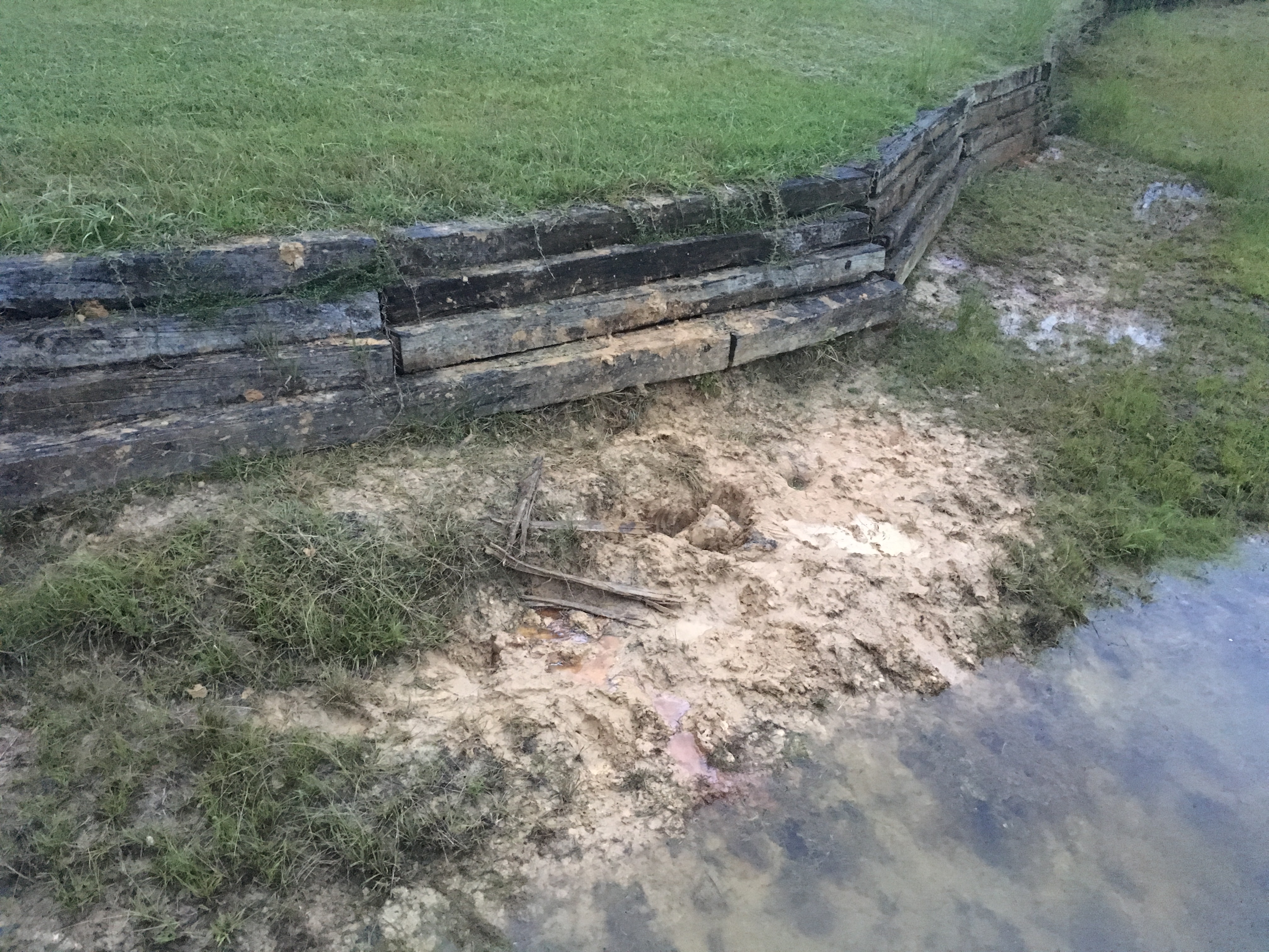

RR ties, temporary solution for permanant problem! A family friend growing up, im 52 now, was the superintendent for this area of L&N railroad and we had access to really really good ones. Bridge ties, for the elevated tracks over lots of rivers swamps in gulf coast Al, Ms and Florida. 10-15 years rotting out, some lasted longer but we get 60/70 inches or more of rain each year. The railroad would replace them on a schedule and ones we got may have been down 10 20 years already with the creosote leaching out by then and higher restrictions with the PCBs for the new ones that were replacing them. My electrical engineer dad, cutting corners, used them in places he shouldnt have when adding on to his house and building a driveway it cause bigger more expensive problems later. My retaining wall around my pond is built (infested is word I use) with railroad ties, Im debating my next move. In a world where money was no object I would put down the pvc sheet pile but not my post to hijack B6D02F4A-6DD3-4E73-AF2F-395B705806BF.jpeg
