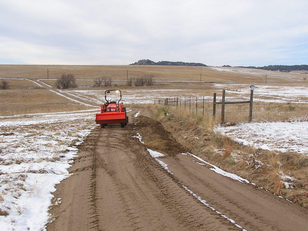

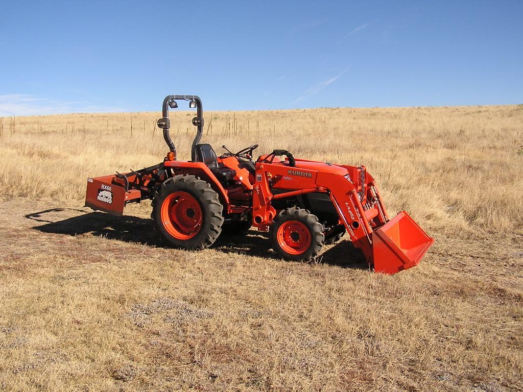

I am going to raise my drive 2-3 feet. :cool: The fence and ditch make a great snow fence. Here is the "Before" picture. I estimate it will take 1,000 buckets of dirt. :( I wish I owned a dump turck.

I'm guessing that the distance is about 1000' long, 10' wide and 3' high that you are wanting to add. If that's correct, then that's 30,000 cu ft or 1111 cu yd of dirt. Your bucket is about 8 -9 cu ft. so you have 3000 buckets full to do.
Don't forget to compact the soil every 8-12".

I'm looking at about 400 yards with a 1/3 yard bucket. I am placing 1 bucket dump side by side and leveling it. This rasies the drive about 2-4 inches at a time. Pack it in for awhile at add some more. It will take time.

I don't understand snow and it's properties, but would be concerned about what will happen in the low lying area if you put an additional 2-3 feet of dirt in what amounts to a dam across that. Since snow isn't like water that we deal with here, it seems like it would require some consideration, but I don't know how to advise you on that. It just seems like there ought to be something different in the low part of your driveway.

Snow collects in the low areas. Today this is my drive. It will blow off of the high ground. That is why I am raising it. The drainage is taken care of.

The first photo there is a low part in the middle of the driveway. I would gather that would be the worst part for drifting snow. I would buy a snow fence and a blower and say heck with raising it.

What would be the fun of not raising it???? You are right about the low spot filling in.
