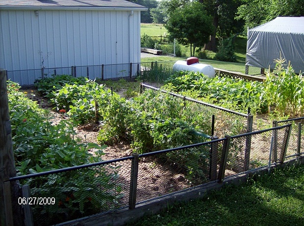

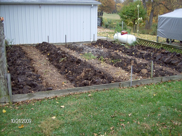

My raised bed garden is 24' square. I leave the walkways permanent, just work up the planting beds. I turn it by hand in the Fall, then use one of the 10" tillers through planting season. I mulch everything for very little weeding & better moisture retention. ~~ grnspot

That is about what my garden is. I have a 54" tiller for my tractor which makes quick work of the whole thing but still struggling with this part of it. I am assuming the Troy built tiller was a rear tine and that it was some sort of shovel behind it that rolled the dirt out?

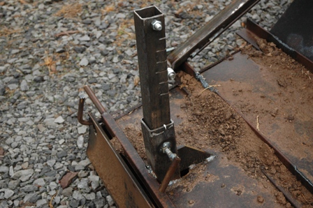

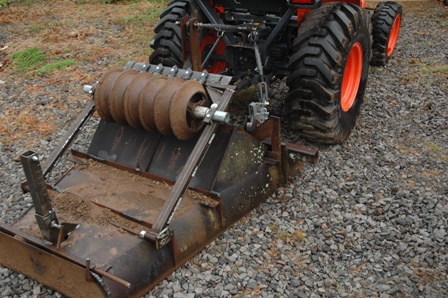

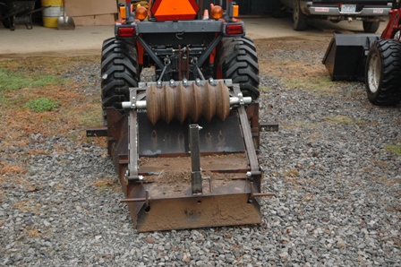

I made a bedder using steel pipe about twenty years ago. Still using it. I made it to put plastic down on the beds. I quit using plastic and cut that off and replaced it with a cultipacker. I use an old grader blade to flatten the top of the bed. I also placed a tube inside of a tube (to adjust seed depth) to run in front of the cultipacker. I do this when planting watermelon or other seeds that plates are unavailable for planting. Will try and post some pics. It is not the neatest looking, but it works!

Grnspt110 - Work it all by hand - that is what I am trying to get away from!

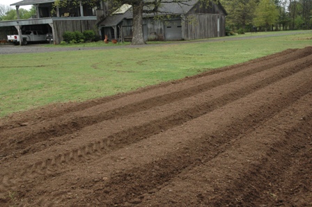

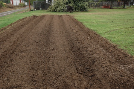

Here is my homemade bedder. The upright tube is for planting seeds that I have no plates for. It is marked on inches. The cultipacker folds down to cover seeds or just to firm bed. I let it all the way down to plant potatoes. The grader blade on rear hinges and can be removed.

Mulemn - That is a heck of a contraption that looks like is does a great job!
