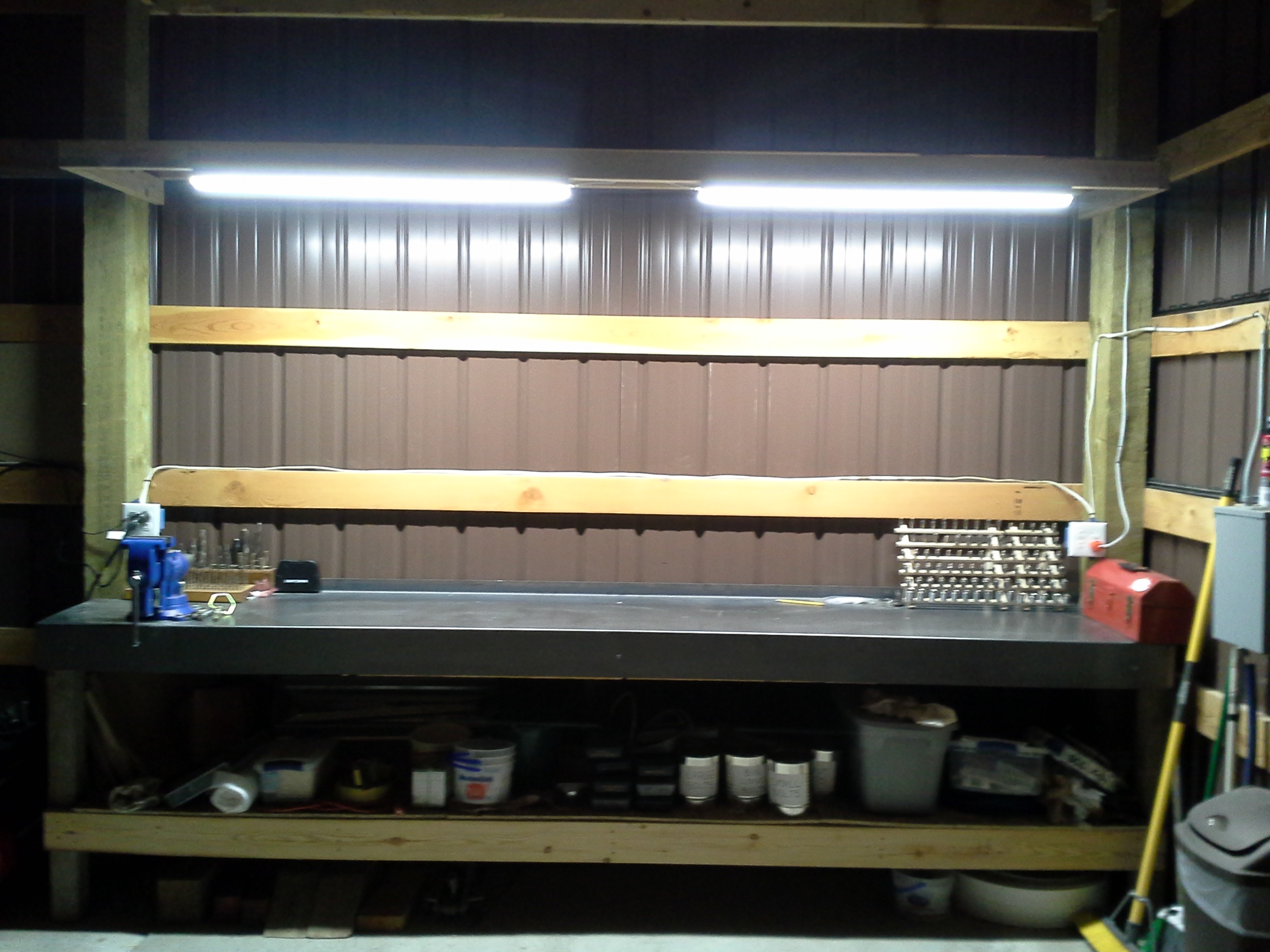

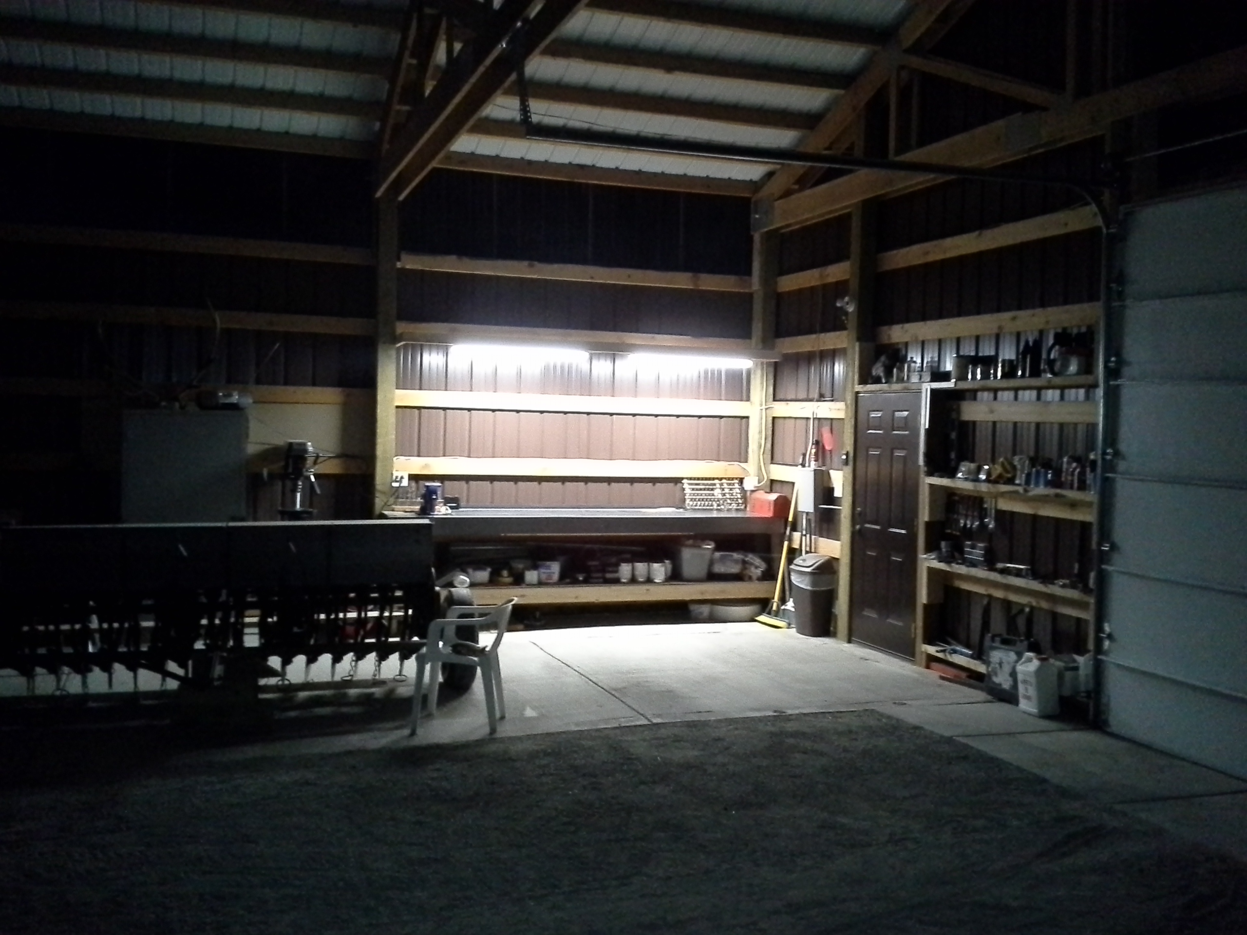

It's been awhile since posting any progress but I finally got around to adding some lights over the work bench. (LED)
I wanted to see how bright they were before putting them throughout the barn. Here's a shot at night. I do like how bright they are. :thumbsup:

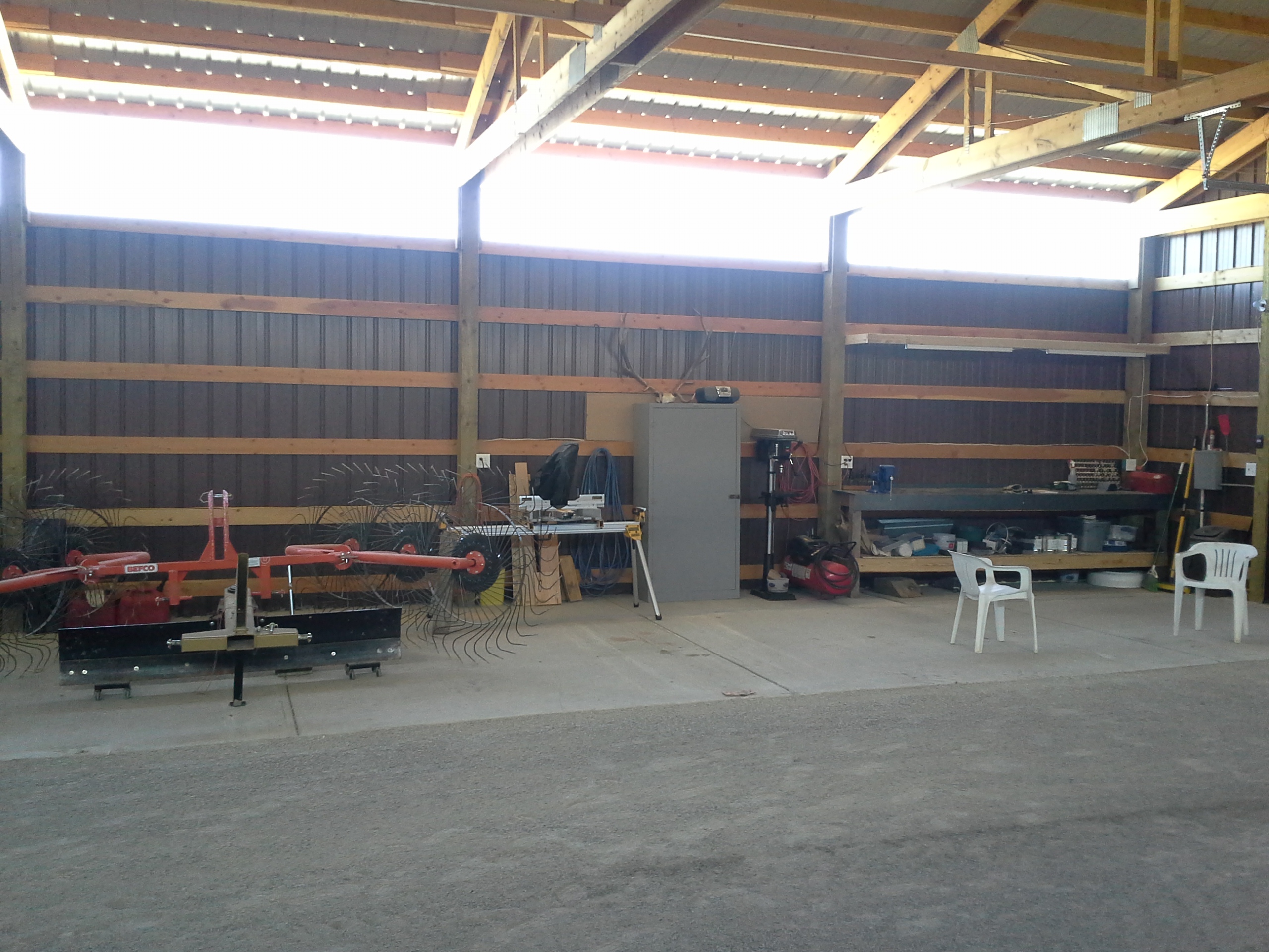

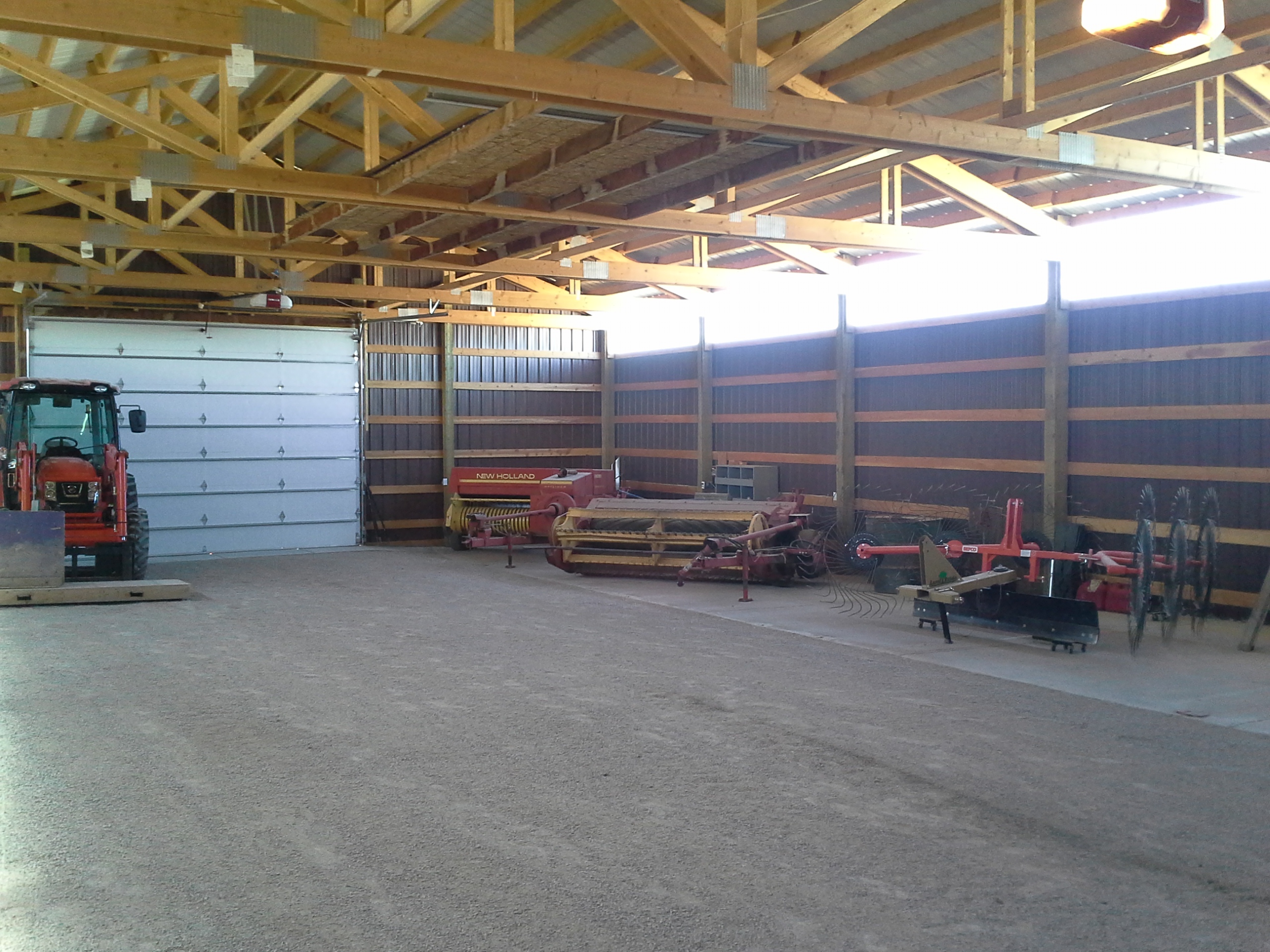

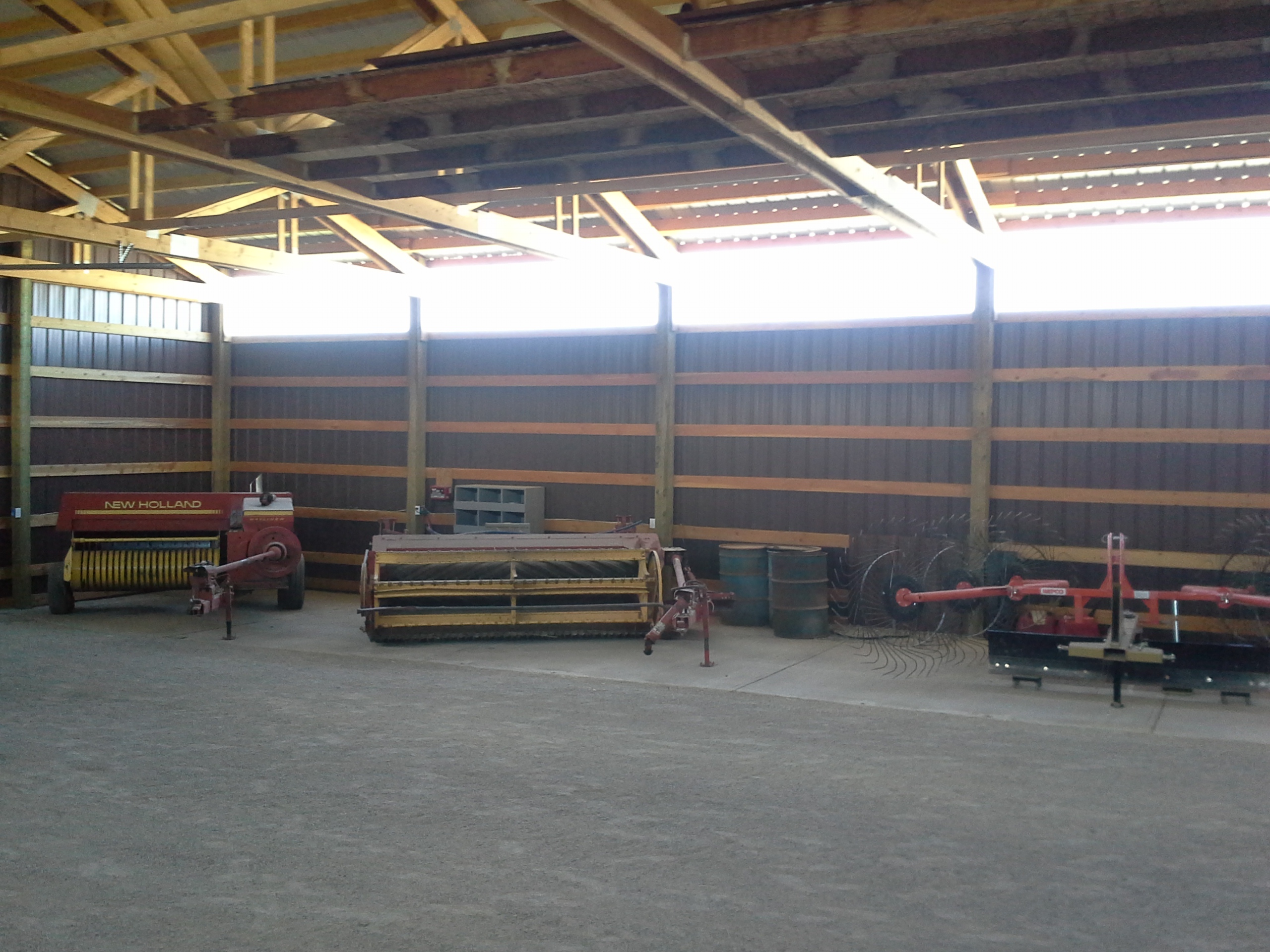

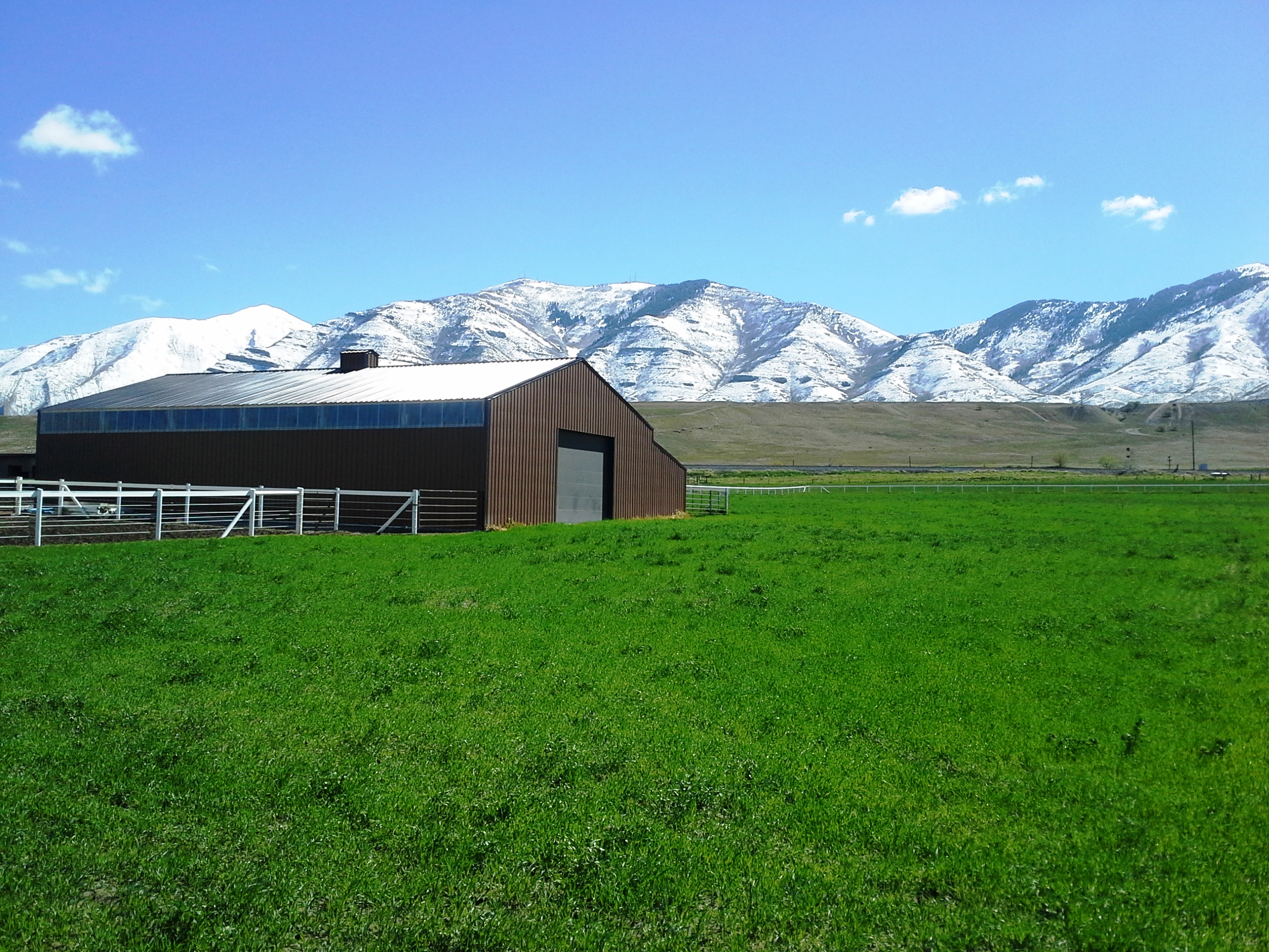

Thought I would update this thread now that I am nearly done with everything I plan to do with the barn. Still have not completed the lighting, but I don't use it much in the dark so no hurry.
All these pictures were taken today. Basically just showing each corner, cement is all the way around the perimeter with "crusher fines" as the main floor. I really like the stuff, it packs hard and is not dusty.:thumbsup:
As you can see there is a small sliver of light on the left side. (direct sunlight) Other than that there was no artificial light. Point is look how bright it is inside, both the big doors are shut. So if any of you are building and not sure about translucent panels---here's the proof. I could work in there even on a cloudy day and see fine without lights.

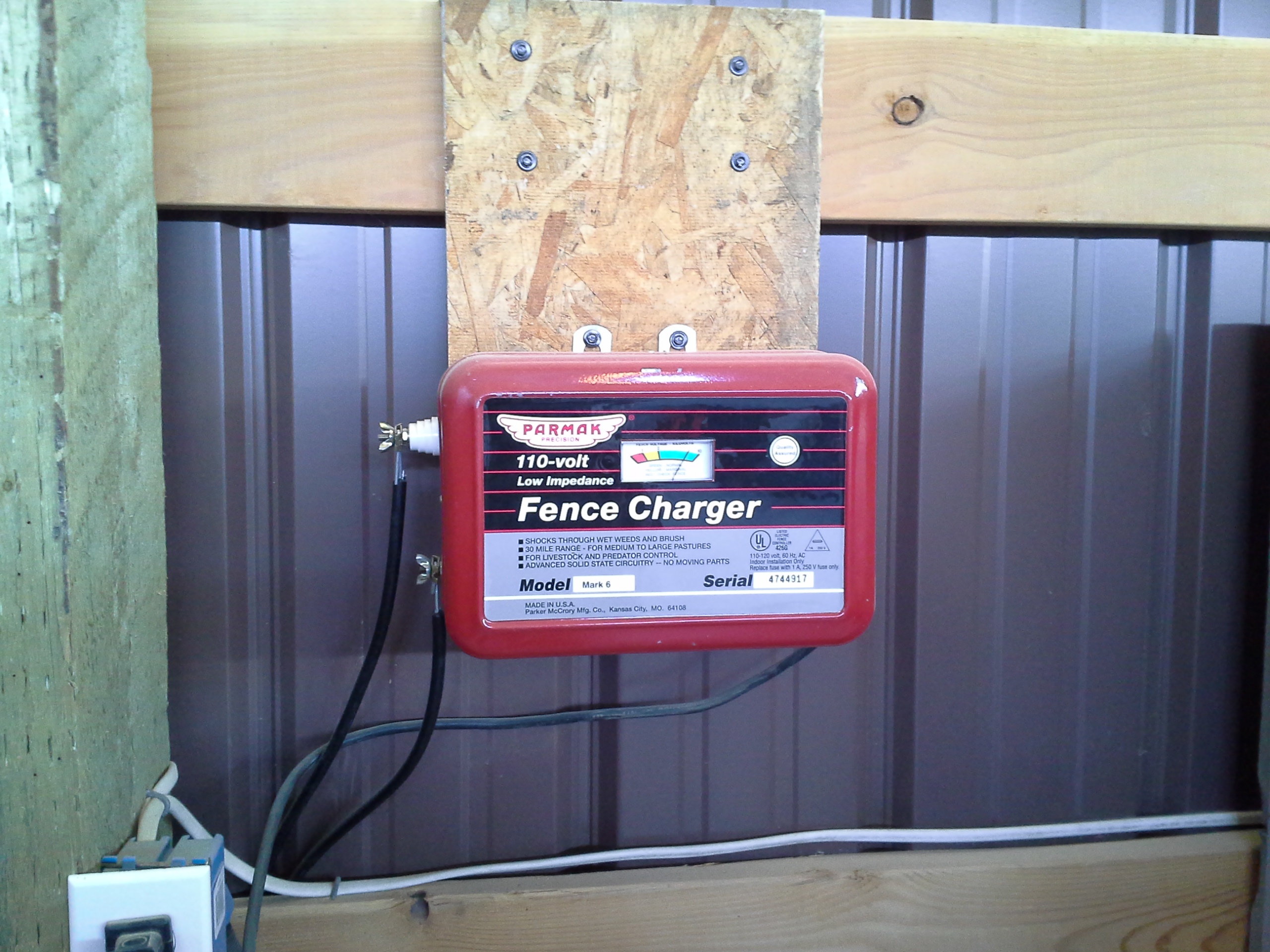

Added a picture of my fence charger. Keeps the animals where they belong.:)
And the last is how it's looks today. Sure wish it would warm up some so the hay would start growing more. But it is coming along great.
