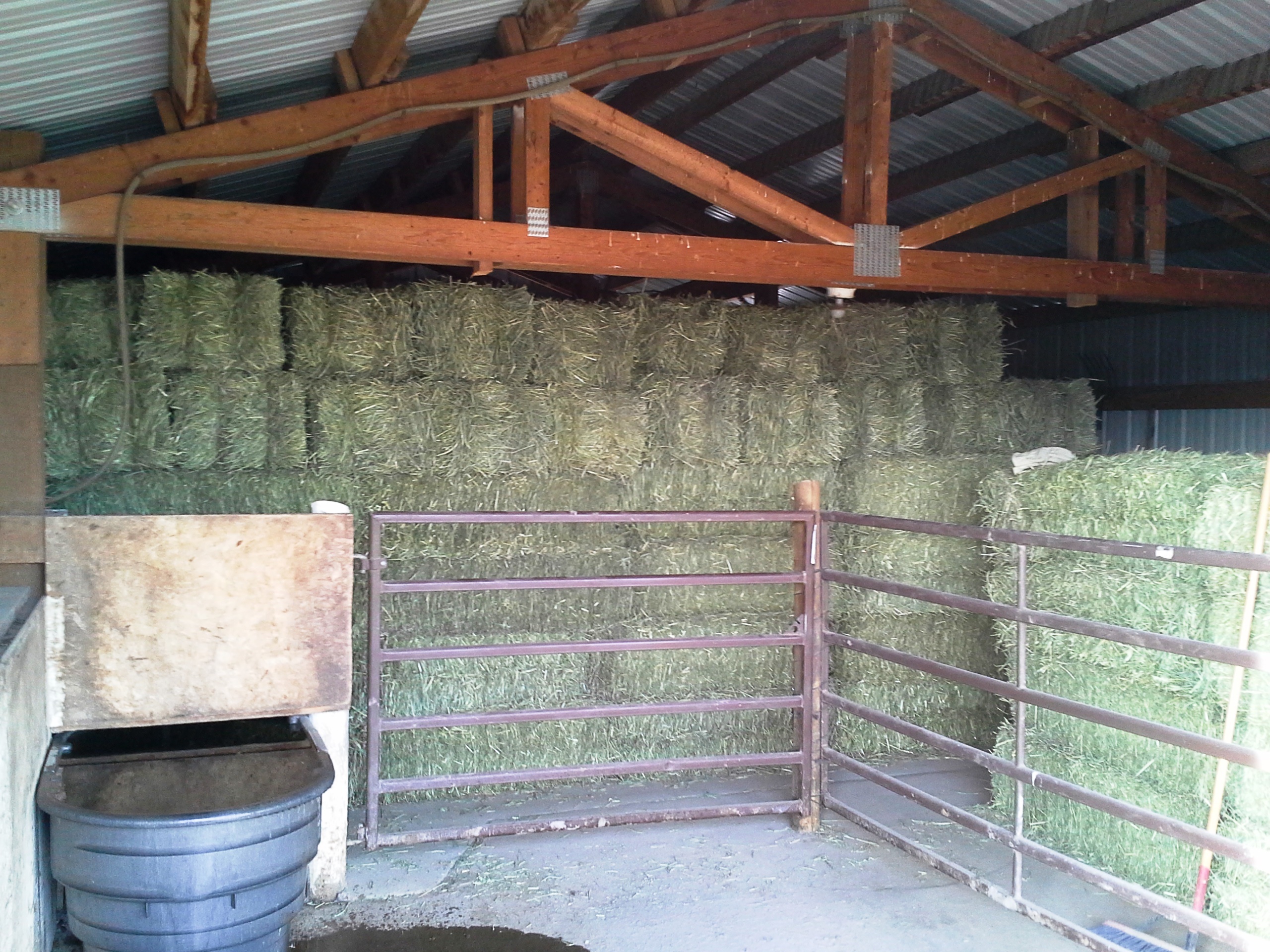

In Utah the butcher came to my house, killed & quartered the calves then took them back to his shop to hang. They cleaned everything up, leaving nothing at my place.
I already checked with the butcher I'm using here in Idaho, they have a guy (independent from them) who does the some thing. Kills & quarters and takes the beef to the meat cutter for aging.
Check around you may have the some type of thing where you live.
As far as water, I have a 100 gallon water trough with a gauged heating element. It will easily last 2-3 days even in hot weather for a couple calves.
As for shelter; deer, elk, moose do not have shelter so I'm not sure why some think a cow has to have it. I always did, but more because I stored they hay in there and built a feeding manger there.
Here was my Utah set up, I'll have something similar/bigger here in Idaho.
