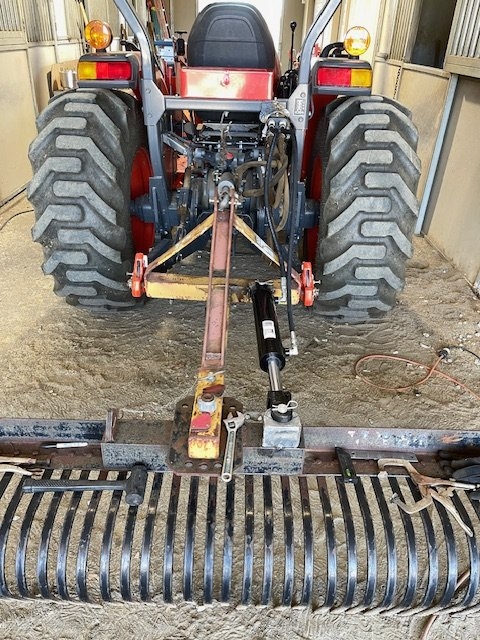

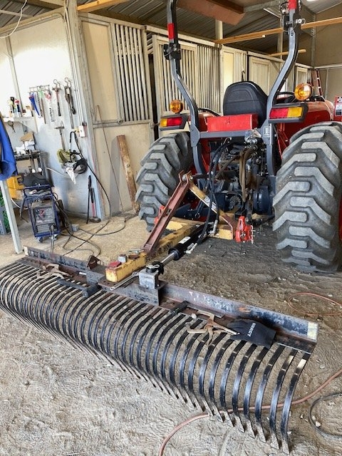

I use a rake a foot wider than my tractor. This allows me to get up close to the fence lines and when it is angled it about 6 ft wide, same as my MX5200 Kubota. I put a cylinder on the rake last yr to change the rake angle from the seat - that's a game changer for rake operation which is mostly rock gathering there.
