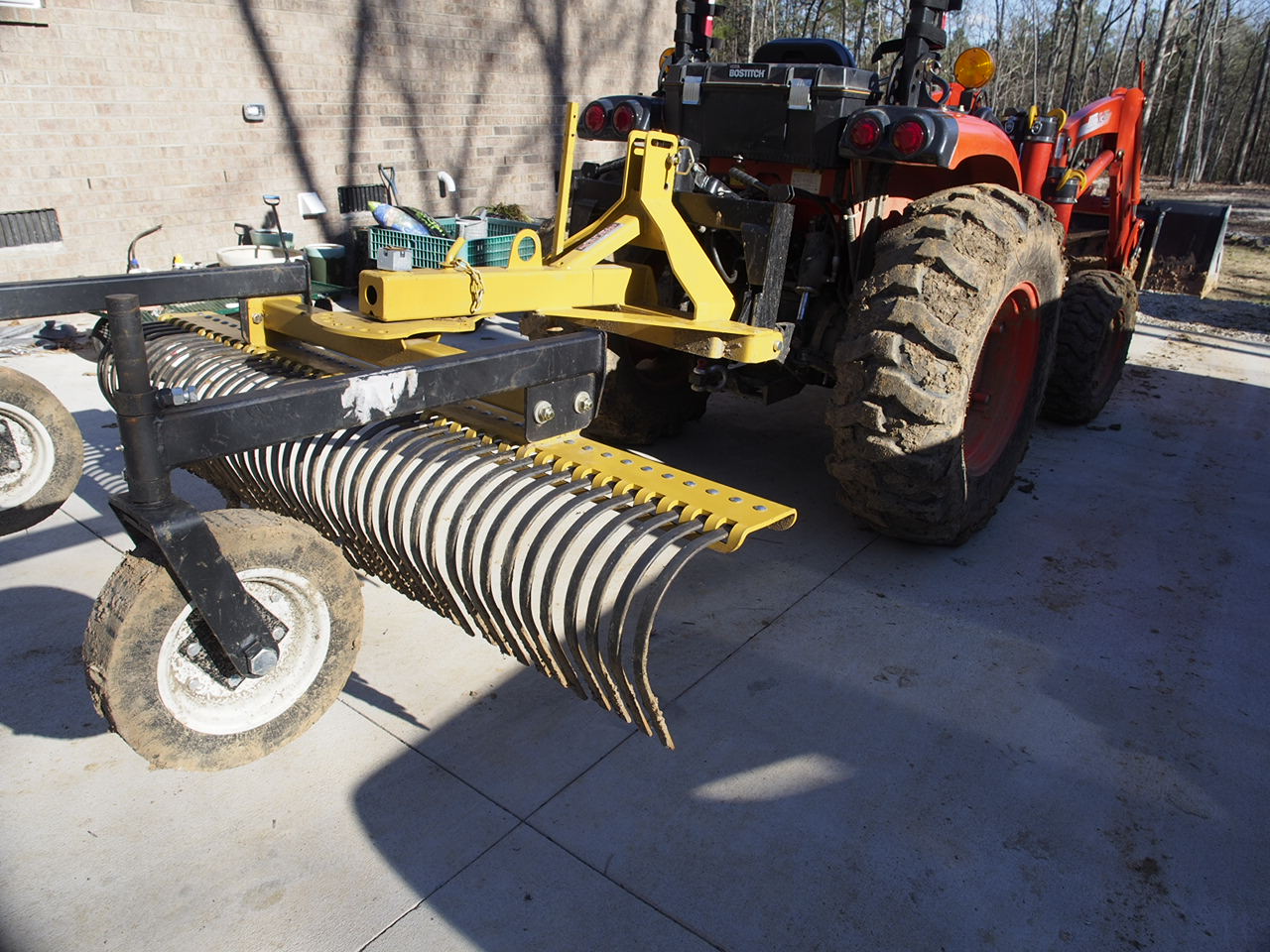

A friend is ordering this or a similar set. However, we have to mod it for greater length to get the wheels back a bit further. We used my EA rake with EA wheels as a template:
Another supporter of a good rake with a set of wheels (and TNT). For most any type of work I typically set the wheels 1" higher than the tines with the rake and tractor sitting level and leave them there. I then adjust fore/aft angle using TNT to dig deeper if required, along with 3PH depth control. It does a great job with gravel or light digging/scraping.
