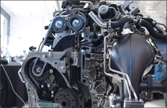

The Tahoe 3.0 L inline six Duramax is probably a great engine but I would certainly investigate longevity of the chains driving oil pump, fuel pump & camshaft at the back of the engine, before seriously consider buying anything with that engine.
As far as I recall, they are designed for 150,000 mile life, which may be fine for most customers, but buyer be-aware.
Replacement of the lower chain(s?) will require dropping off transmission which is little more complicated in 4x4 truck - no problem for a mechanic with a shop & proper tools.
   / Ram 1500 EcoDiesel #160
