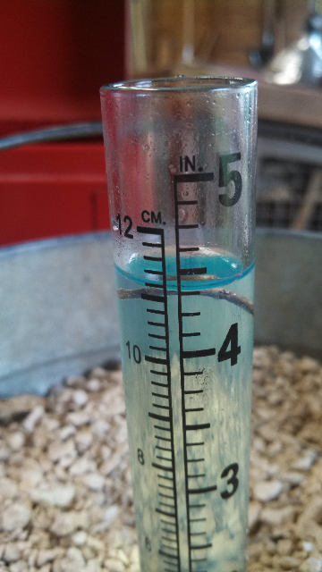

Well, folks, here's the status. The truck is plugged into the charger to top off the battery. I drained the fuel filter and set its contents aside to see if it'd separate. And while I was at it, I checked the air filter change indicator, and it may be time for a new air filter as well. I'll keep you updated.

What do y'all think? Water or no? I can't tell if that's a thin layer of water or just the refraction layer at the surface.
