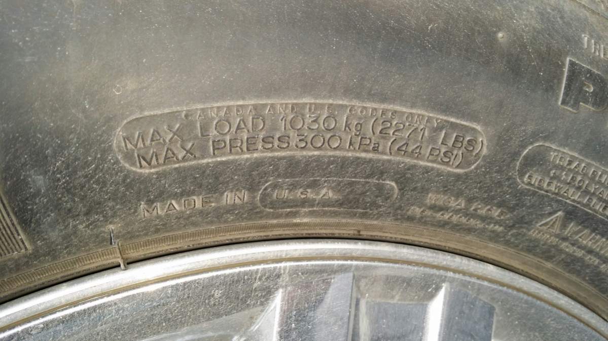

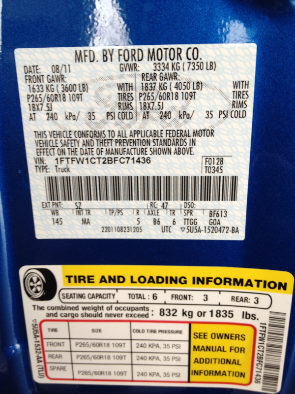

Sorry Jejeosborne
but if you are towing that 7500 lbs. mini ex on a tandem flat bed trailer, with the f-150- and are still running those p rated (passenger tires) you are either right on the line for tire safety or are possibly over it.... or am I mistaken- since this whole thing is about safety and educating people...
I am anxious to learn. What am I missing? Tires are rated at 2271 lbs each and axle rating is 4050 in rear and 3600 in front. Truck is rated to tow 11,300 lbs and 1835 payload.
I want to mostly stay legal and in doing so being somewhat safe. Obviously it would be safer to use a bigger truck with LT tires but the excavator is moved just once or twice a year locally and being legal for that 30 mph move is most important.
   / Ram1500 EcoDiesel V6 revealed! #384
You guys don't know anything about trucks, I just want to look good cruising. :D
   / Ram1500 EcoDiesel V6 revealed! #385
Ok- the truck is not over but with 2 adults 220#s each and 200#s for anything other than tongue weight, which (guessing here) works out to aprox. 1100#s leaves about 335#s to spare ? I stand corrected :eek:
but I would just say that I have had a couple blow outs in years past due to tire heat - was using a similar load rated tire on my j-10 Jeep and towing 150 miles with a heavier trailer, but loaded with just an intermediate size american muscle car... I have just had bad luck when towing using the lighter duty tires on the tow vehicles... it is an idiosyncrasy of mine i guess- I see you said that when towing that 30 mph would be used for the heaviest tows... Just be safe and i know from an earlier post that you inflate the tires by the tire manufacturers recommendations for max towing.

Well then, lets look at this from a nannies perspective. Ford rates their gvwr at 96% of the allowable weight on the axles. Dodge .. 87%.
Which truck has the higher margin of safety for an overload condition, or any condition for that matter. I guess being a Ford owner, you had better be carrying a bathroom scale around with you at all times.... cause there's not allot of wiggle room.
Do you seriously think the engineering in the Dodge is that much poorer? Or GM, OR Toyota... which are both in line with Dodges ratings.
Ford is notorious for doing this, all the way through their light truck lineup.
And yes, every truck I've owned before this RAM was a Ford... So I am absolutely not brand baiting, or bashing.
One of the things OEMs look at is the stopping distance at gross.. If its way off, they lower the gross or up the brakes. Tires also have a lot to do with it (up to axle limits, of course). If you want a plusher ride, softer, lower capacity tires go on it (notice that the 'max payload' option includes LT tires as opposed to P) Spring rate too. .. softer for better ride, harder for more payload. There's more to it than simply the axles.
