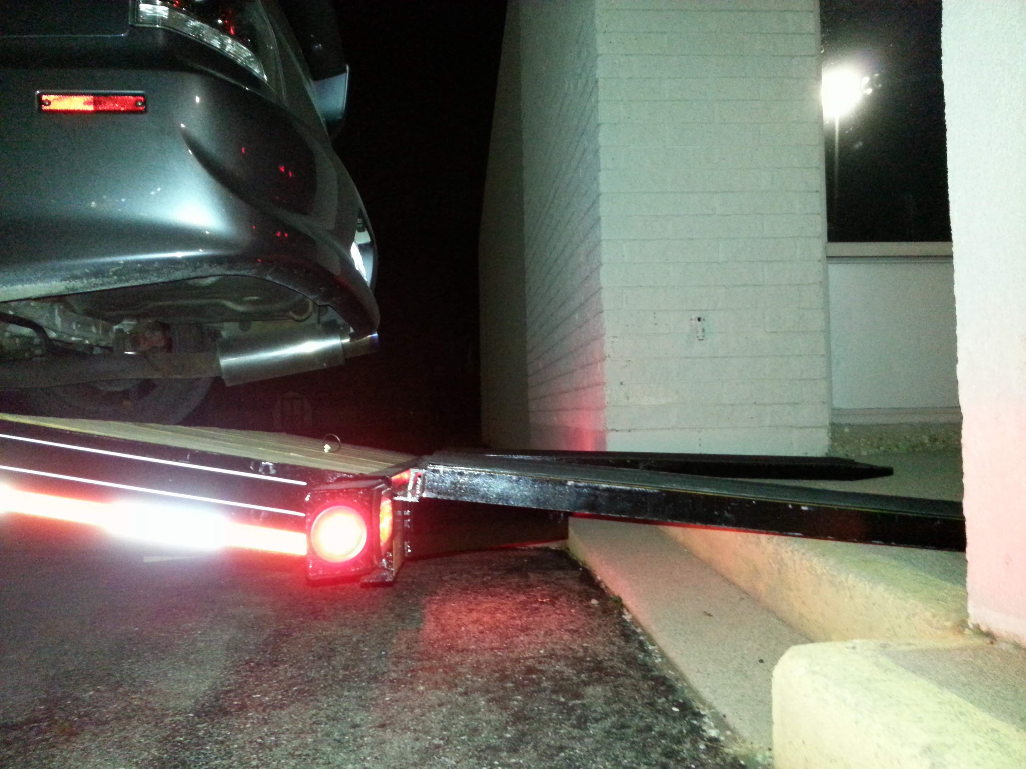

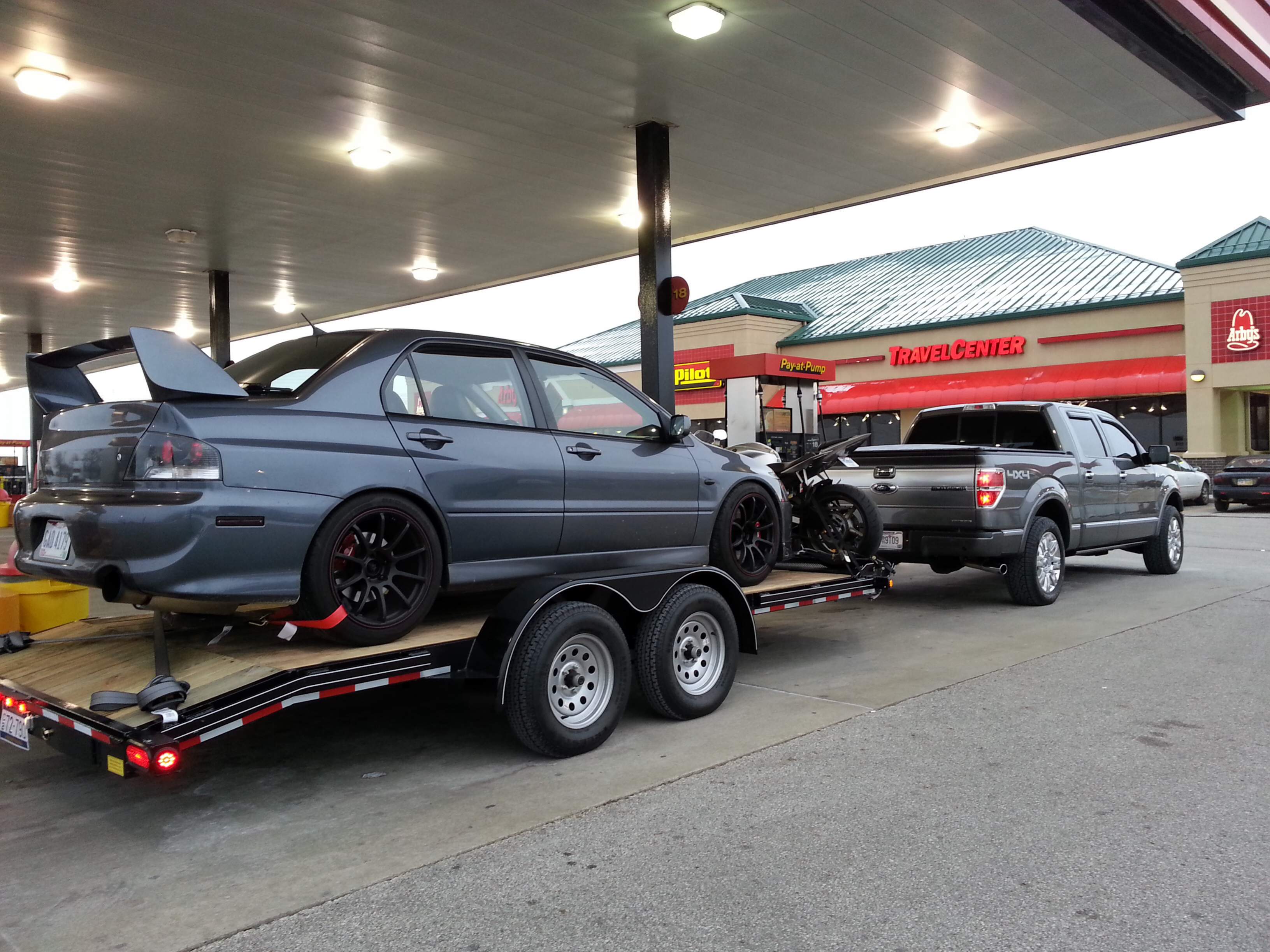

I picked up my sons car and bike in Ohio to bring home for winter storage. We had to find a shopping center front sidewalk to drive the car onto trailer. We tried sitting truck and trailer in a big dip so rear of trailer was as close to the ground it folded the tag under but the front of his car sits about 3" off the ground so it almost has to be flat. Loading the old Jeep Cherokee is no problem, or the BX1870. I think I also need longer ramps or the race ramps as stated.

What I've seen people do is just cut a couple of 2x10's, one shorter than the other and put those under the bottom of the ramps to reduce the loading angle. If you get fancy you bevel the leading edge to help the car climb over the edge of the board.
