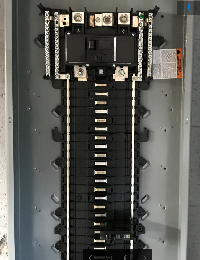

Sorry LD1. As far as large openings in the box itself for inserting the wire into the box, there are plenty. There are only 2 shared ground/neutral openings left that are only for up to 10 gauge wire. Then, for me to put a 50 amp breaker into the box, there is no room. I would have to take put in 2 tandem breakers to free up room. On top of this, I will be putting an addition onto the house which I will need more circuits for the addition. That i why I was going to replace the load center next year for a larger one. But now running into this year, I may replace it sooner.

#36
I got a new QO panel from Square D. See attached. I don't like the ground/neutral bars on top. This is a 40 circuit box and there are a total of about 45 ground/neutral openings. I was thinking about buying a neutral bus and running one on each side so all the grounds can attach to that and all the neutrals would attach to the stock bar on top just to keep it neat looking. Any thoughts? I have to see if I can find the correct bar that will match up with the screw holes.
   / Ran out of grounds/neutral slots in my main breaker box. #37
That is fine without adding. Their is no code, nor is their any type of workmanship issue with having more than one neutral or ground wire under one lug.
Is the inspector requiring you to bring the breakers/circuits up to code? GFCI and arc-fault?

#38
Actually, I talked to the inspector and he said all he is going to look at is the mains and ground. He said he can't inspect anything else since it is existing, so this should go pretty smooth.

   / Ran out of grounds/neutral slots in my main breaker box. #40
Was that when you were just wanting to add another ground bar?
Does changing the whole box change his opinion?
Your old box is grandfathered. New box including breakers may need to be brought to current code
