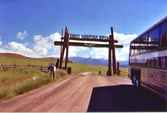

Here's a picture of one that really impressed me here in East Texas.

You're right Eddie. That one is quite impressive. I don't envision mine to be quite that massive. I'm thinking more in the line of three 10-14" diameter cedar poles that I cut myself. I do have some big cedars on my place but nothing like that, not to mention enough $$$$ to complete a project like that.

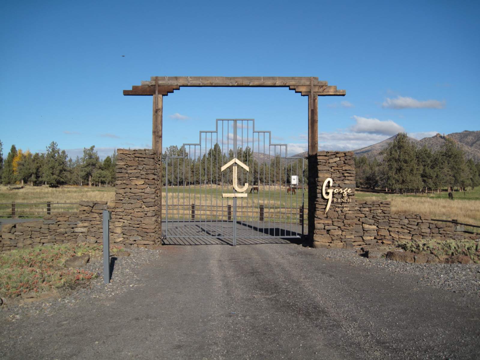

Now back to entrances. If you go to google images you can see a ton of ranch entrances. One of the ones I liked best after looking at dozens was the one outside of George Lucas' ranch. It has stone pillars, ornate metal worked towers and a trellis type archway. This would be daunting for most, but if your a welder/blacksmith like myself or know one this could be an enjoyable and relatively do-able DIY project. Whatever you do make sure your footings are meeting the minimum code in your area. In my area it is 18" and I prepare to go down 2' and my archway isn't even top heavy. Some may want to go down deeper. Remember that side to side your braced by the horizontal. The footing needs to stop it from ever falling forward or rearward. Ranch entrances should also be routinely inspected form time to time to make sure timber, stone, metal's are in good condition and nothing is wearing or stressing.
Other neat things you can do with ranch entrances are running electrical into them for lighting or to power mechanical prop. If the idea of running electrical is too daunting or impossible consider installing or hanging solar powered lanterns from your archway. In sunny areas these work exceptionally well and the nicad batteries in them last a long time. You might also want to consider solar powered spot lights in front of your ranch entrance to put a focal light on your archway and property entrance or to highlight the name of your farm/ranch/property.
I hoped this information helped someone out there thinking of building an entrance. They are pieces of art in themselves and they are the first thing your friends, visitors, neighbors will see when they come to your property so doing it well, safe, and to code is important. You want to put your best foot forward in a ranch entrance. Also resale is important. You might want to consider hanging your name or business from the entrance as opposed to carving it into the timbers or welding it in. As with most things you do on your property you have to ask "is this something that no one else in the world but me will enjoy" if it is you might want to pause before doing it and give it some honest thought. Are you sticking around on that property or in a few years might you move on? Things to consider.

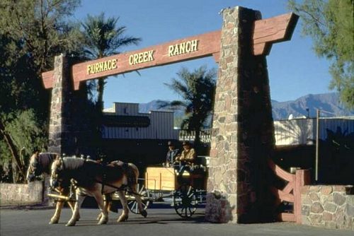

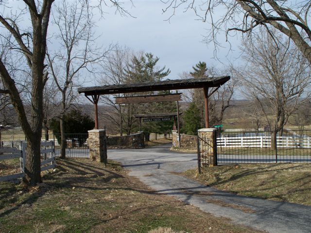

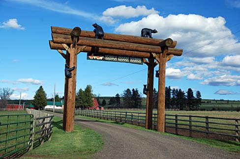

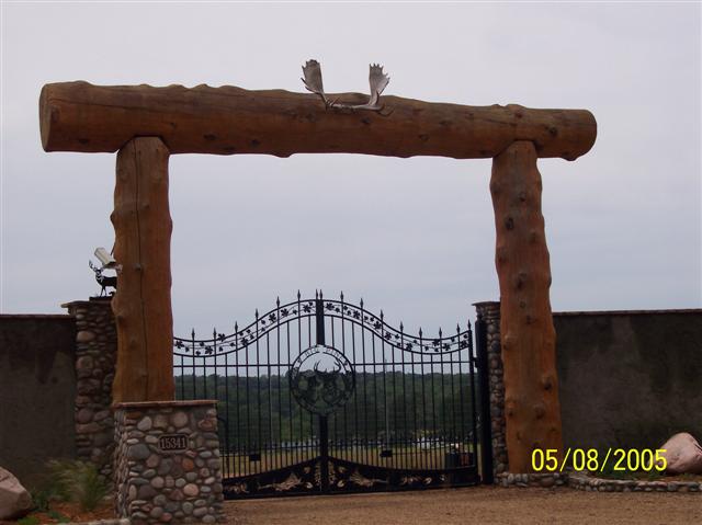

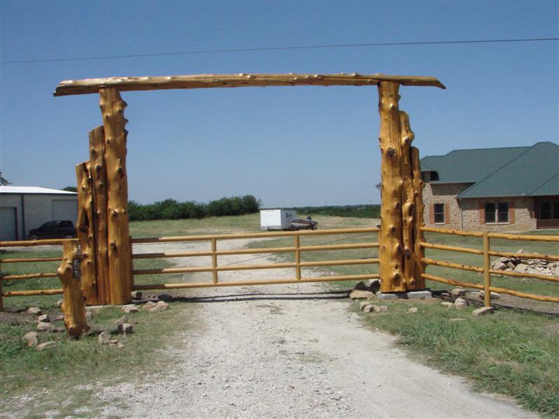

I'll upload some pictures so you can see a few entrances. Get the creative juices flowing.
