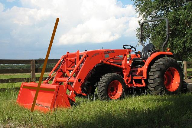

In your other thread where you describe your FEL being too short to stand the gate all the way up ... A 4x4 or 6x6 can be secured vertically across the face of the FEL using chains or ratchets. We did this to lift five ~14' 6x6 posts out of the ground, & it worked great. Also used it to lift trusses down from a pole barn (prev owner built it over the property line). If you use an ten-foot 4x4, you'll extend the height of your FEL by about 7 feet. Like this:

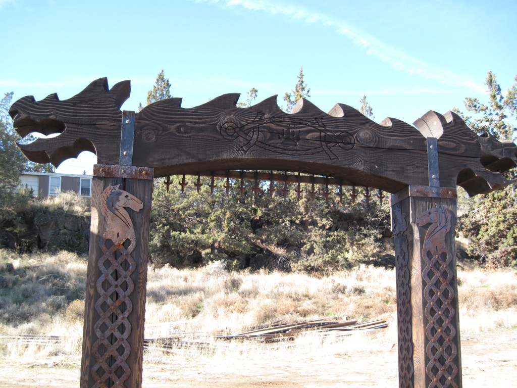

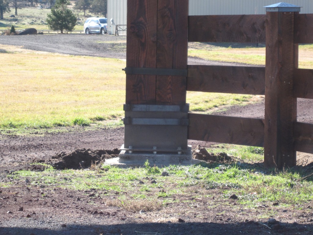

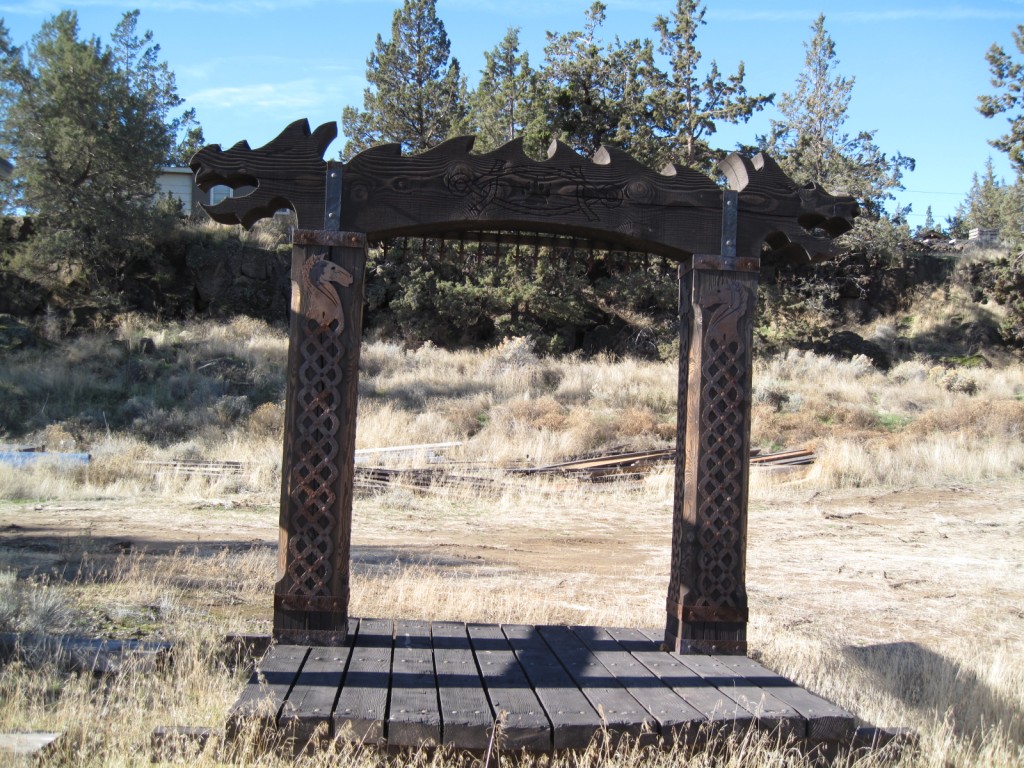

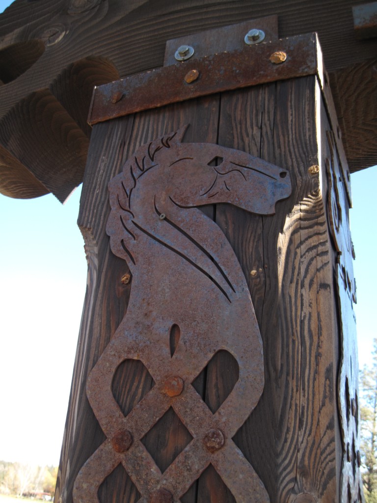

I was driving all over tarnation today and I found some pretty cool archways. Here were two I got some pics of. The second smaller arbor the clearly did some serious work on. It was pretty cool. The large ranch entrance had timbers bound in metal. It was pretty cool. To bad I was facing into the sun or I could have gotten better pics. The timbers didn't go into the earth. They were actually sitting above the concrete in metal plates. I guess this prevents rot?

Those are some nice arches and a lot of work involved. I have actually considered including some Haida artwork to my design as I am slowly learning that skill....very slowly! I've also a professional welder who was my neighbour next door at my former property and now that I built my new house, I'm back near him again and he's willing to do any metalwork for low $$$'s (he's retired and has the time).
   / Ranch Type Entrance #30
love the designs, guess i need to save for a plasma cutter now...thanks!!!
