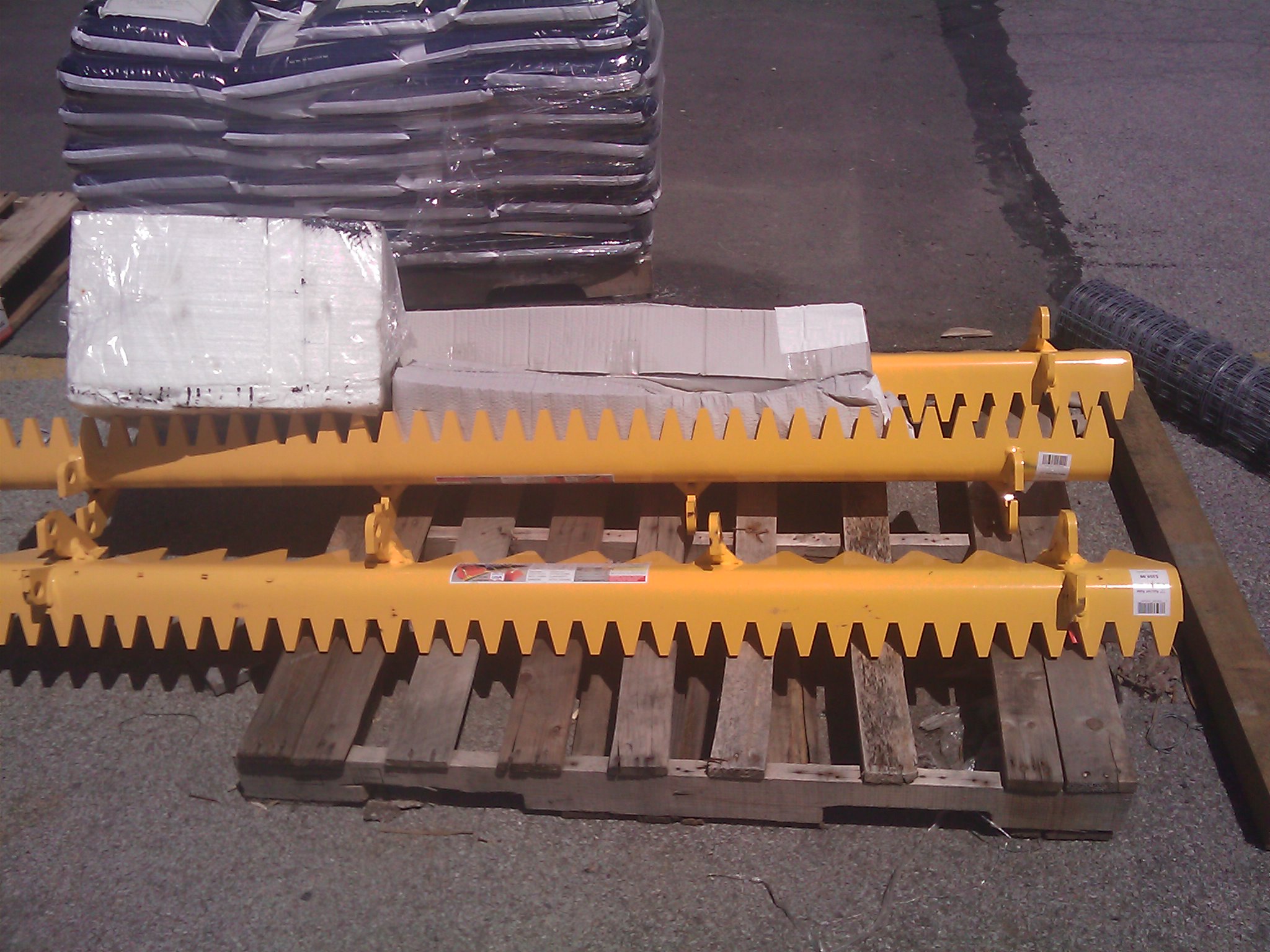

Saw some at the Canandaigua NY TSC yesterday. Very heavily built from the looks of them.
