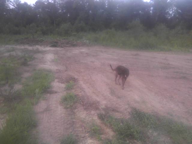

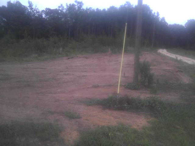

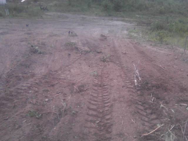

The Ratchet Rake was the first attachment I bought, I live in central FL and clearing Florida scrub for planting pasture. I use this device 90% of the time. Learning curve was small, mainly in determining the proper angle for what your doing ie. forwards or backwards. I've found it performs exactly as advertised and am very satisfied with the investment.
I replaced the ratchet strap with chains and binders though because one of the lower connector clips got bent up and one of the ratcheting handles was destroyed by a rouge limb.
THe only limitation I have is not with ratchet rake but tractor power.
Re. what condition the ground is left in? Well we have no rocks here just dirt and sugar sand and that is what's left, maybe an stray root sticking up.
My plan is after ratchet raking the property to then disk.

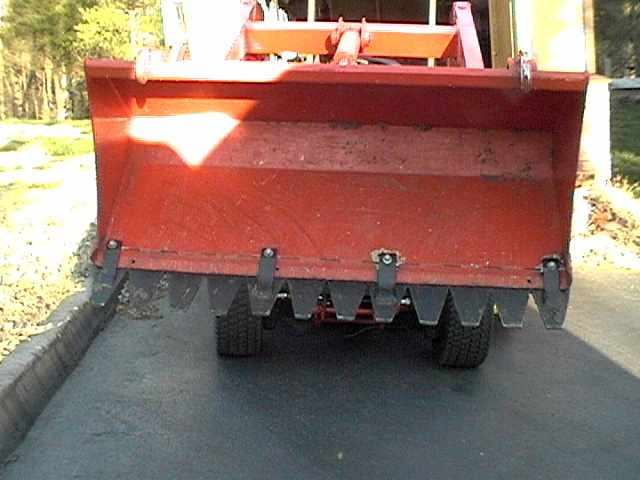

Not when you make one that has a lot of teeth like mine. I made this because I'm in a constant battle with honeysuckle. Most of the time I can catch a root, or the trunk where it forks, and rip it right out.
This looks alot like the upper half of the Ratchet Rake which I rarely use. The lower half with the smaller teeth is what I use almost always.
