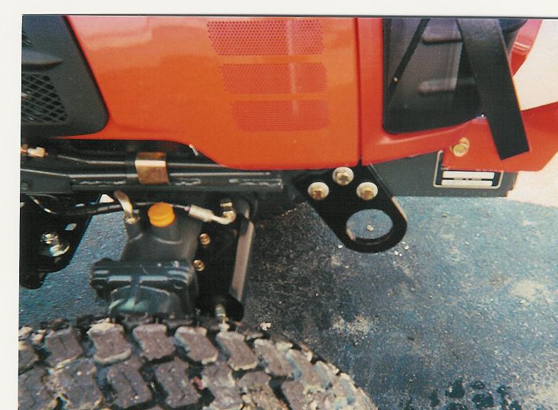

My machine is in tow every week so i installed brackets to chain through.
That looks like a really good idea, I am going to look for someplace on mine to do the same.
Yeah, that looks good, nice and high, better than the draw bar where I see alot connected to. with it higher up your really pulling the machine down when binding, not just sideways.

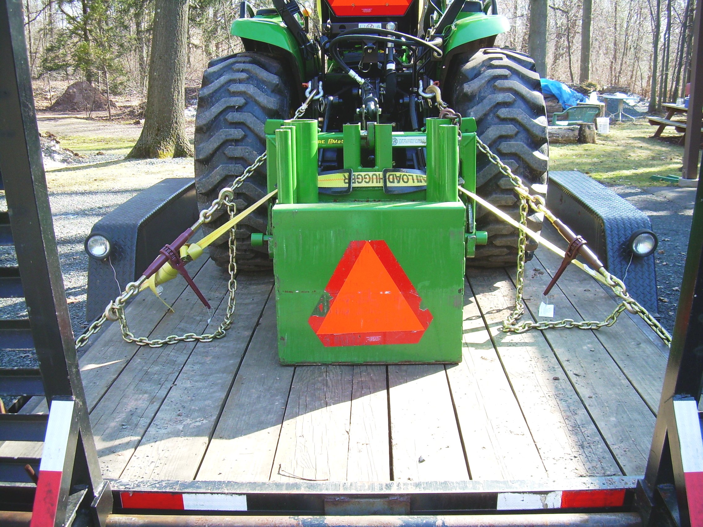

Mine is similar.

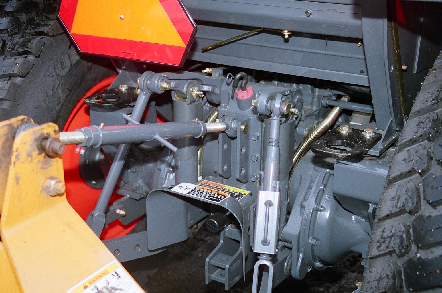

   / Ratchet straps or chains? #48
Front brackets.
