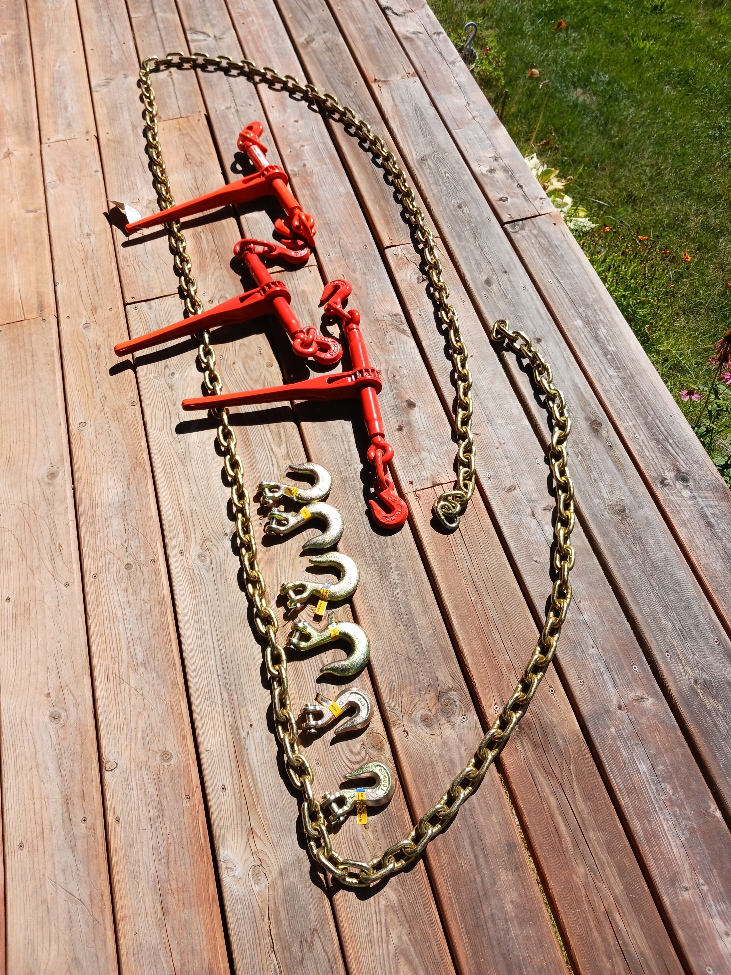

But now I just use ratchet straps for the side by sides and atv. For the tractors I went back to the safe trouble free route...3/8 grade 70 transport chains and binders.
