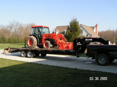

Although my truck, tractor, and trailer are filthy from several trips to my remote property, attached is a picture that proves that I did buy an appropriate sized trailer and the appropriate tie down equipment after my near disaster. A friend calls it my "near miss". If I nearly missed something, wouldn't that mean that I hit it? /forums/images/graemlins/confused.gif
To answer a few more questions; no, I don't have stock in a chain manufacturer, yes, I am nuts, yes, I'd pick Chinese made chain over straps anytime, I did spend the extra money and bought US made chain and binders myself, no, I didn't actually soil my pants (came closer to wetting them if I recall correctly), yes, I greatly appreciate the posts of the federal DOT rules, yes, I printed them out, yes, I did read them, no, I'm not nearly finished planting my 5000 or so trees, and yes (duplicate), I am nuts. /forums/images/graemlins/laugh.gif Did I miss any? /forums/images/graemlins/tongue.gif
I had no intent of scaring anyone when I posted this thread. I just know that before my wild ride that I firmly believed that two straps on each end would be plenty adequate to hold my tractor. It would have been difficult to convince me otherwise. I'll just say that I'm considerbly more humble and feel that I've had a self inflicted "attitude adjustment". I'd momentarily forgotten how much I don't know. /forums/images/graemlins/tongue.gif I just hoped that I could show my ignorance so perhaps someone else didn't suffer a fate worse than mine for believing what I believed. Know what I mean??

   / Ratcheting tie downs BROKE in transit! #129
Dargo,
No pic. Please try again. Nevermind ...it's there now.
Nice setup. It does look LONG!
Moon of Ohio

I clicked on your picture, and immediately had to get a tissue to wipe the drool from my chin! What a great setup you have now. John
