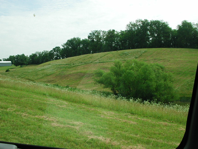

We have a lot of slopes and they are hard to gauge in pictures and even looking at them on foot at times as opposed to from the seat. I doubt that I will ever get "comfortable" on some of our slopes no matter how many times I mow them; maybe that's a good thing, keeps me careful.
I've found the more you use a tractor though and more slopes you encounter the less uncomfortable you get, I do notice my going from a big tractor to a smaller one always makes the smaller one feel more tippy.

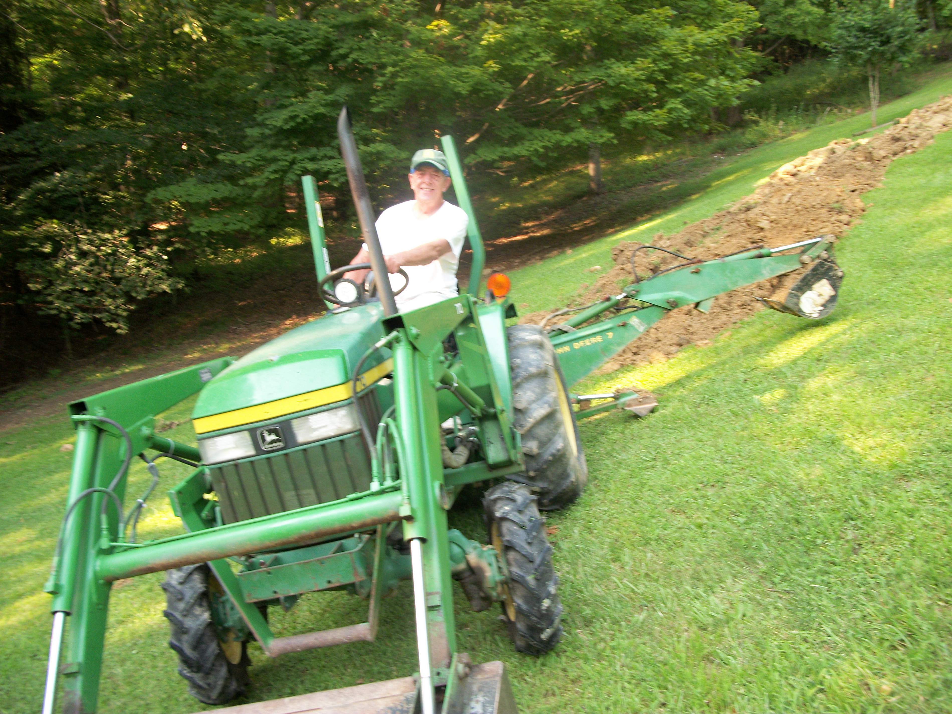

I wasnt mowing but withe my backhoe swung up hill when I moved my guage read just alittle over 20 degrees. I was concerened a few times. 247.jpgJust be safe. cobb71
/ Rate this Slope #26
cobb71,
If you do much of that stuff Just be safe, fix your rops.
/ Rate this Slope #27
cobb71,
X2!!! That not even Roll Over Protection System the way it is. Its just the remenants of what used to be a ROPS. Its one of those things you probably want to fix BEFORE you need it!!:D

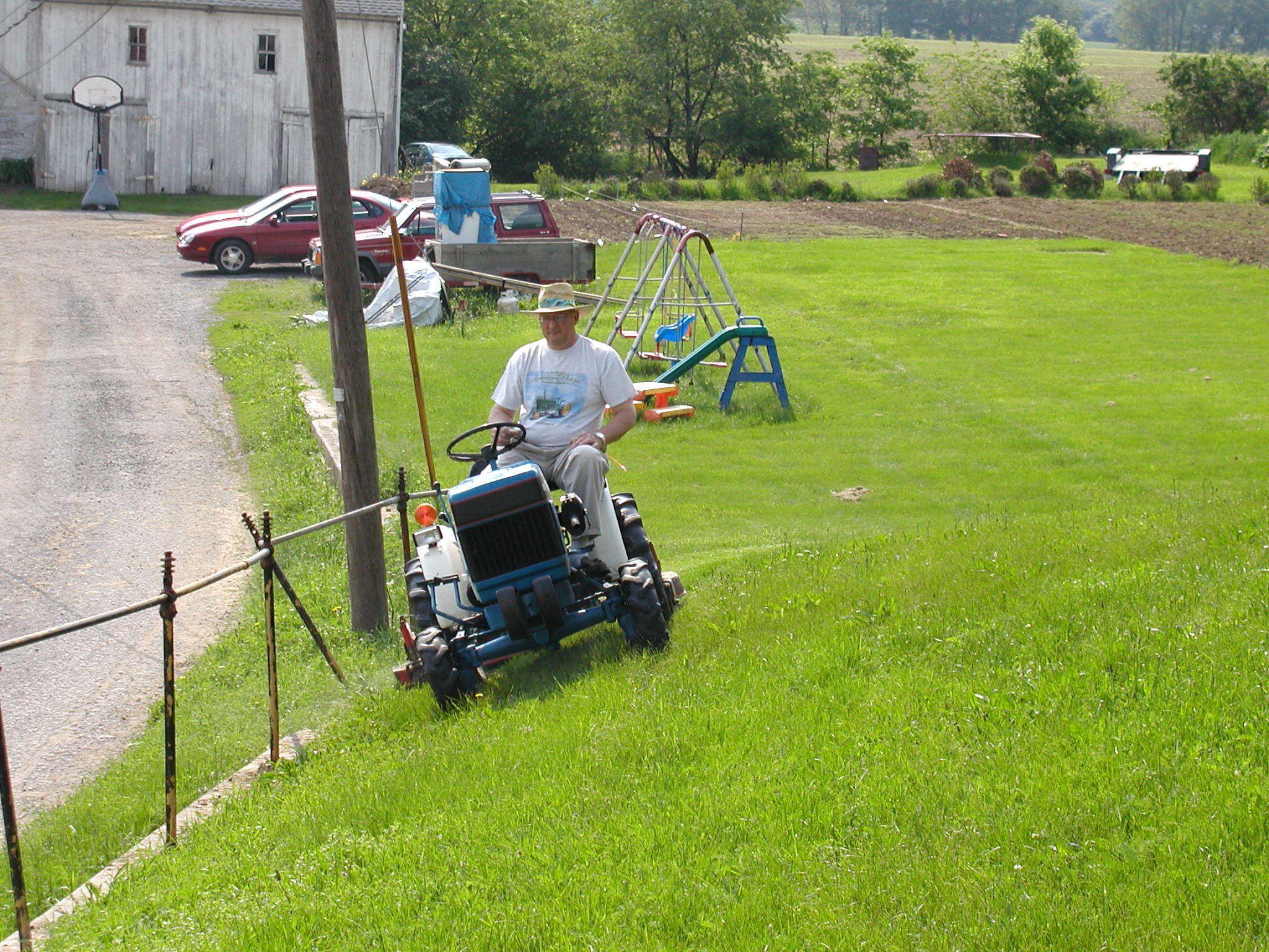

take your time and do what you feel is safe. as you get experience you will end up pushing things more and more. hopefully not to point of rolling tractor.
for myself on steeper hills, mowing up and down is not really an option at the road side ditch. and take the hills at an angle.
i will go slower on steep hills for sure. slower i go less chance of when hitting a bump on high side or going into a hole on the low side. and all of a sudden tipping over. the slow speed gives me more reaction time to correct things.
i rarely will drive across a steep hill. to much can go wrong way to quickly. steep hills for me are any were from 25 to 45 degree angles.
have rear tires filled with a fluid can help reduce COG further down on tractor. vs adding weights higher up on the tractor. to help reduce tipping over.
