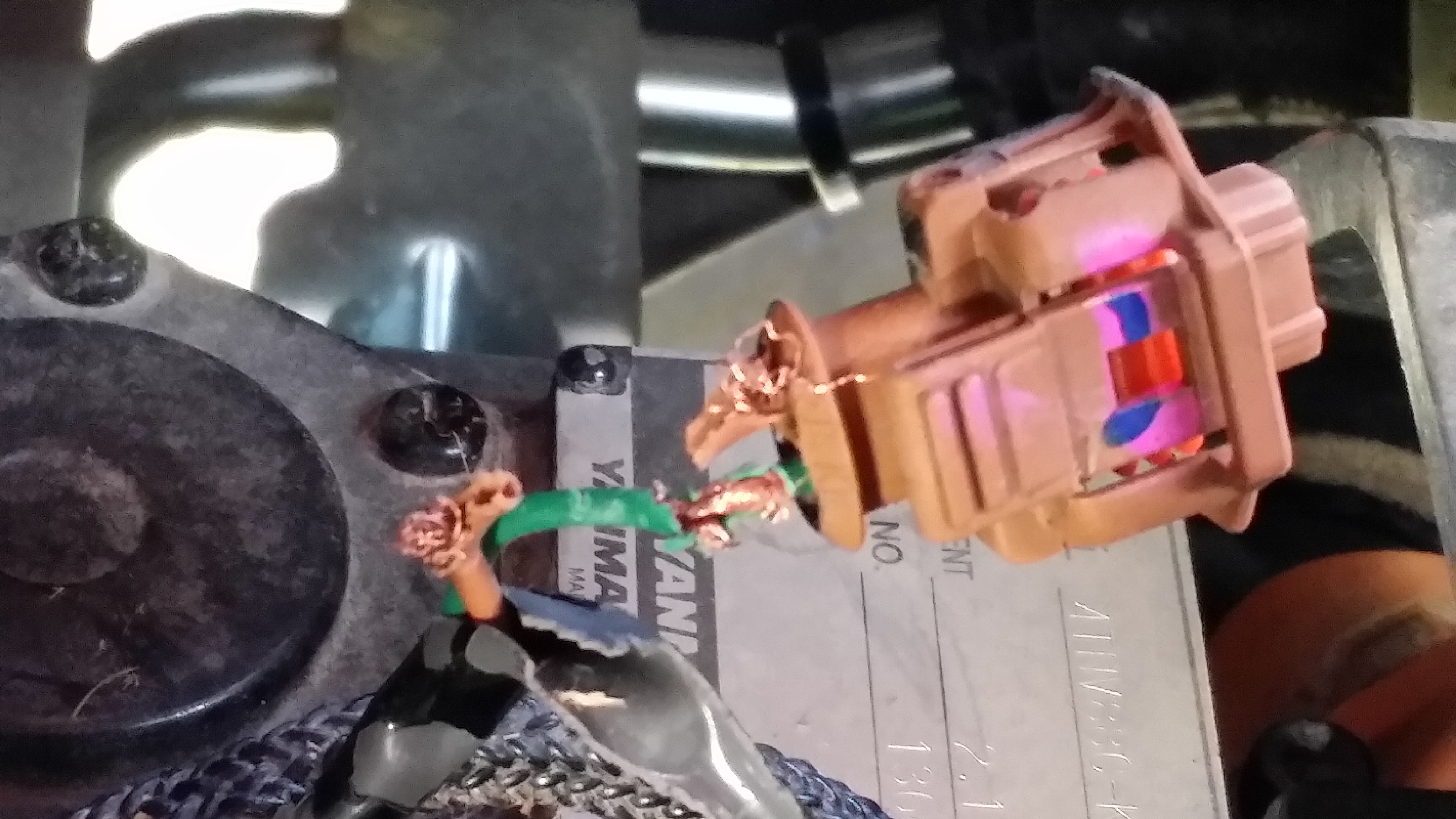

Good afternoon,
This year I purchased a TYM 454 HST Tractor new. My old Montana gave up the ghost.
A few days ago, when I went to get my tractor out of the barn, there were warning lights on the cluster that were not listed in the manual. They looked like the engine warning light except that they had an 兎xclamation mark in them. The left was blinking, the right was not. I tried both the paper and digital version of the manual. I was finally able to determine what the issue was. A rat, foul critter that they are, had chewed through the wiring of the connector on a glow plug. The wire was chewed through right at the connection making it impossible to re-wire it as there is no wire remaining with which to work with.
The dealer is telling me they don't sell the individual connectors so I need to buy an entire wiring harness to replace the one plug connector. There is of course the additional charge to do all the re-wiring. As since I also have no way to get it back to the dealer I'll have to pay them to haul it back and forth. As I have a back problem I simply cannot do the wiring myself. The option of spending a $1000.00 or more to fix this problem is not a viable solution. Not after having to replace my older brush hog (almost $2000.00) which spun out three different PTO shafts at $148.00 a pop in less than a month until I replaced it. (hog was only rated up to 40hp) My mistake for not noticing the horse power rating difference sooner. Plus a new hydraulic line when the backhoe outriggers slipped on the ground (no traction) hitting the arm against a large rock snapping off the connector on the line. Another almost $200.00 to replace the line. Then (almost $800.00) replacing the straight blade (60 inch) for a 72 inch which actually covers the width of the tire track. Just to take care and manage our property. I'm surprised my wife hasn't divorced me yet.
I contacted the company (N. Carolina) via email last night with the issue as well as the photos. Amazingly I received an email from them this morning. They are looking for a place where I might be able to purchase the connector, as well looking into the issue of shoes for the backhoe. But, I thought someone on here might have an idea as well.
Sorry for the long winded run. Just getting frustrated here in S/C Missouri.

The only issue is a single 2 wire connector? If that dammaged connector dosnt directly connect into the back of say a gauge cluster or component i would start by removing both connectors and just but splice it for the time being.
As far as your other issues they just seam to be general issue with equipment. If you cant afford a $200 hydraulic hose then you shouldnt be owning a backhoe. For attachments being to small...well

I'd hit all forums that had that type engine/glo-plug combo. Reads like your dealer needs some money for Christmas. Splice it in the meantime if you can.
Looks like some careful work with a pocket knife or dremel could expose enough copper to splice it.

If i could, cut back the insulation a little to splice. If wires will be too short, add short piece to end. The pins in the connector can be pushed out with the right tool and new pins put on or spliced onto wire. Some connectors are very are to find. We have to buy connector kits.

Rare that a connector cannot be separated from a connector. Usually there are barbs that can be released. If the existing wiring, when the damaged part is cut out, can reach then just put on a new lug (or maybe you can reuse the originals) and slip it back into the connector.
On my older VW TDIs it's fairly common for people to build their own harnesses (they're very simple). The trick part is in threading the GP end to get a small nut on it to hold on an "eye" terminal at the end of the new wire. For this system, however, it's just a single wire to the GP. Your tractor appears to have two wires, and I couldn't say for sure what the second one is doing, in which case you're probably going to have to continue to utilize that connector end.

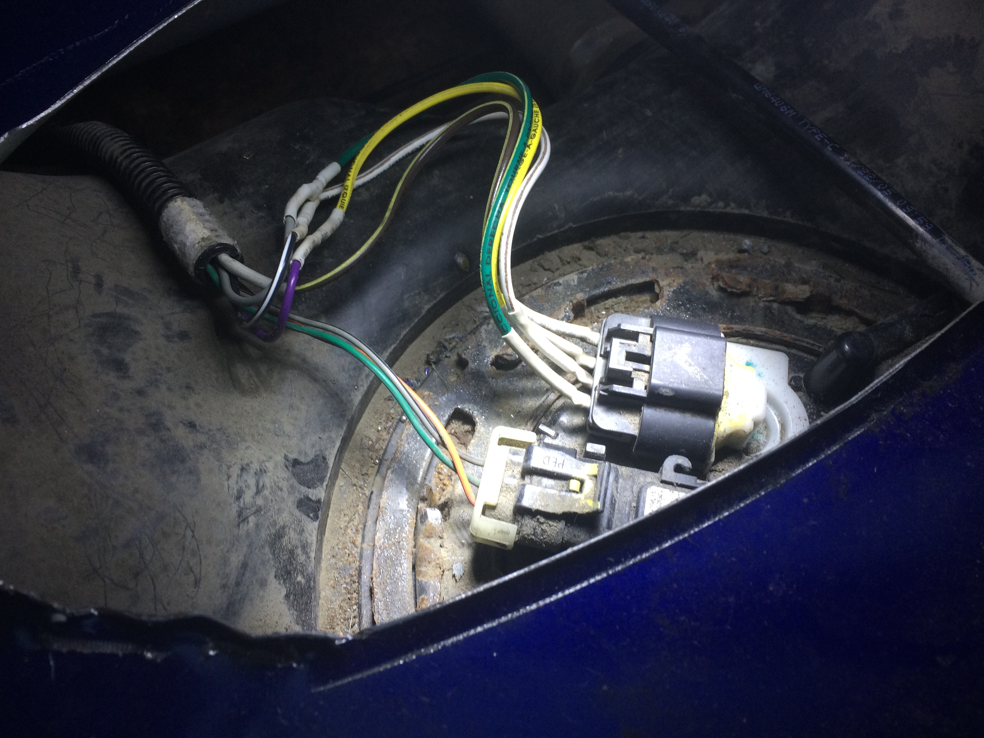

I've just been there with a car that sat for 11 mos with a full tank of gas and me putting of removing it. On a dare, we cut a hole in the trunk to access the fuel pump and found 3 of 4 wires chewed off right at the connector like the worst shown in the attachment above. Chevy uses yummy wire?
These newer waterproof connectors don't all disassemble easily to replace internal bits like those of yore. On the bench I soldered a few more inches onto the wee stubs remaining on the connector and covered 'em up with heat-shrink tubing.
So, a week later I was tilting my pickup box to get to a tank pressure sensor that scanned as low volts. ... and mice had chewed off all 3 wires from the sensor but not the 4 on the pump/fuel sender connector like the'd done under the car.
I covered up more for neatness with heat shrink tubing on the truck job. Here's how the car looks showing my gawky 'rainbow' extension/repair made of trailer wire. Note that I had to work right up to/at the connector.

I highly doubt that is a proprietary connector designed by TYM for exclusive use on your tractor, and only available from your local dealer as part of a wiring harness assembly. The engineers designing tractors would benefit from focusing their efforts on things other than minutiae like plug design and the bean counters would likely scoff at the notion of a dedicated assembly line for this one special plug.
No, they would more likely, and most often do, purchase standardized connectors from someone who specializes in production of standardized connectors, and use those connectors in their design, maybe or maybe not assigning them an in-house part number.
Check for any part numbers stamped on the connector, especially anything that says "DIN". Consult online visual connector cross-reference tables. Google all kinds connectors, I'll bet you find that your glow plug connector is the same connector that (fictitious example) Toyota used for the headlights on a '97 Tacoma and you can get the connector from eBay with wire pigtails for $6.50 delivered to your door, and it might even have the little butt splices included.
/ Rats and Wiring #20
I posted links to the connectors earlier and then as I lay in bed I realized that wasn't really very helpful. You already have an intact connector. What you need is a "pigtail" with longer wires coming out, that you can splice into your harness. That proved to be a little harder to find because when a OEM uses a connector in an assembly like a harness or pigtail, they assign that assembly with their own part number and the connector part number is lost. you have to figure out who is using that connector, for what purpose, in what assembly, and a part number for that assembly. I did find one excellent source.
It would seem that GM used the same connector for the fuel injectors on their 6.6L Duramax diesel engines for 2004/2005 year models, which had problems with the connectors melting so they switched to a different style, but that means that "injector wiring harness repair kits" for this engine are plentiful. Below is some Google fodder followed by several links to actual products which I strongly suspect will work for you. Again, I encourage you to verify the connector dimensions before purchasing, but I'm pretty confident this is it.
