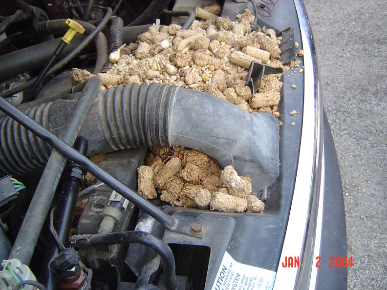

Is this mainly a Texas thing???? See the attachment for what I found under the hood of my M-I-L's van last year. It sits out in the pole barn most of the time. We've gone through 3 wiring harnesses and in fact it's sitting right now needing a fourth. We've had both squirrels and rats nesting in there and never found a good way to keep them out. We can't use poison ... too many critters. In fact it may have been one of the dogs that got it this last time. We've tried just about everything, except fox's urine, I don't know about that one. /forums/images/graemlins/shocked.gif /forums/images/graemlins/shocked.gif /forums/images/graemlins/shocked.gif We're trying a barn cat right now so we'll see how that works.
I'm a little surprised that you have this problem since it's an every day driver but you better carry an emergency or spare belt with you because sooner or later it's going to get caught in there and then you lose just about everything. I found that out when a cat decided to call the engine compartment of my truck home during the cold winter nights.
