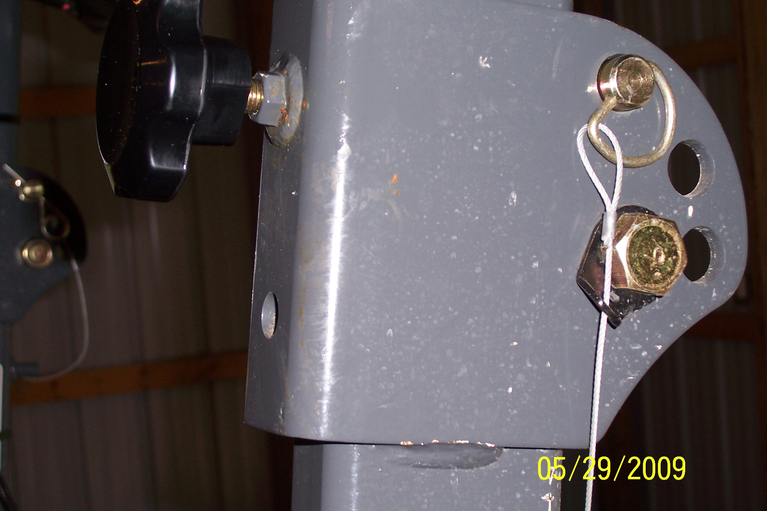

Just got my B3200 last Friday and so far the only problem I'm having is this really loud rattling from the folding ROPS when I'm mowing.
My question is, anyone else have a fix for this?
Please don't suggest duct tape... Already thought of that.

Not sure how your ROPS compares to my L3800, but mine rattled also. Very irritating! :(
Can't remember if it's on the front or back but at the fold over point there was a nut welded on. I put a bolt with lock nut in both of these and tightened it. No more rattle. :D

I put bolts into the welded on nuts on my ROPS and this stopped this joint rattling. M10 x 1.25 I believe but do a search to check, I got the info on this forum.
At my 50 hour service, my dealer put springs on the pins that go through the hinge which also stopped some noise. I can take pics tonight if it would help....

The BX25 comes with bolts with hand knobs there. I'm sure your dealer can get you a pair. Never figured out why Kubota doesn't put those on the larger tractors since they have the threads to accomodate them.

I ordered a set of BX25 knobs to fix the ROPS rattle on my B2620. They should have come with it though.
Purchased the Hand Knobs last week from the dealer and that cleared up the rattling. About $11.00 ea. plus some shipping. Only thing I have to remember now is to lower my ROPS before I pull under my awning... WHAM! lol
Thanks everyone for the advice and ideas.
