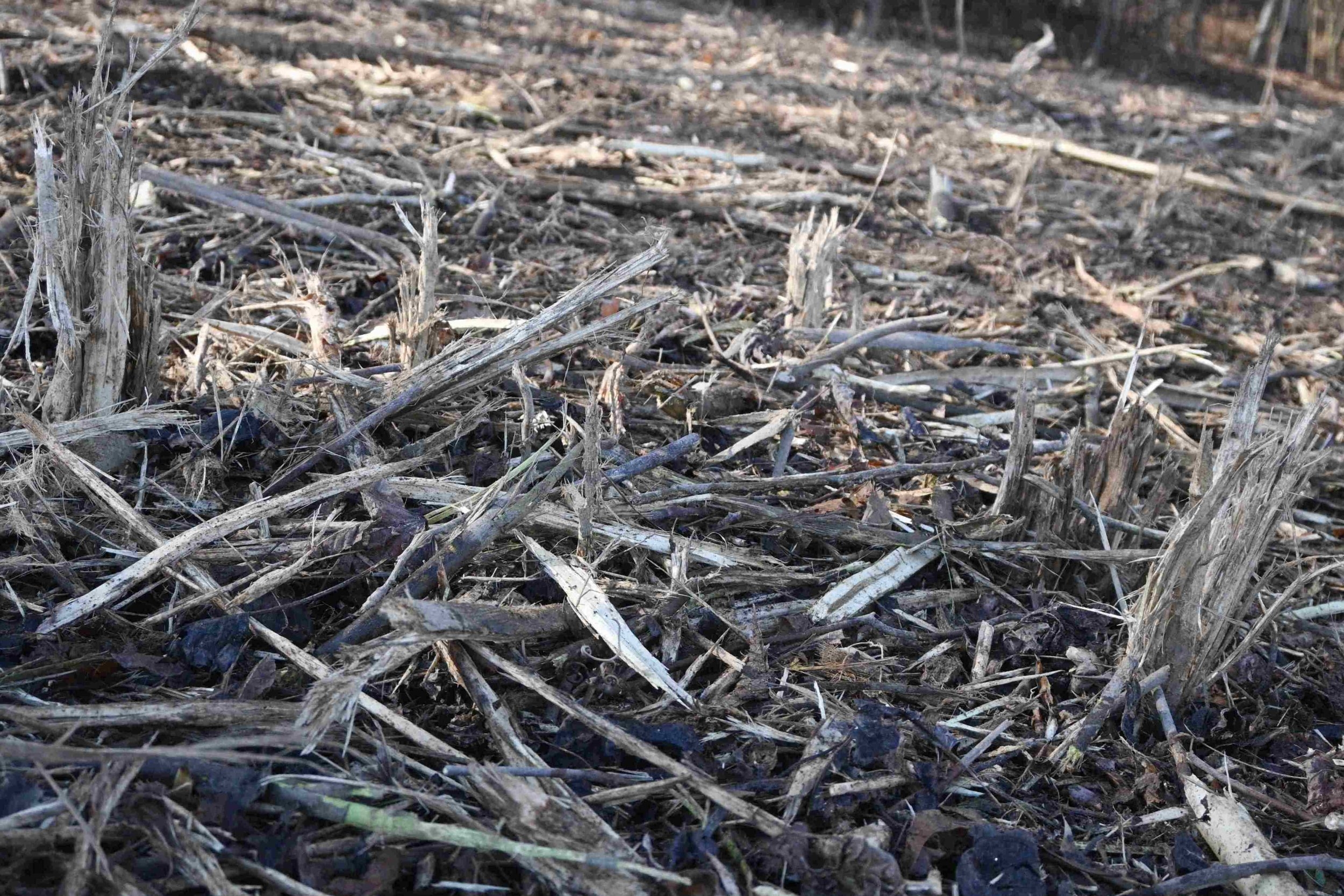

When I had forestry mulching done with a drum mulcher a couple of years ago, the guy did a great job, but I still had chunks of debris which I believe was unavoidable due to the size of material he was mulching.
