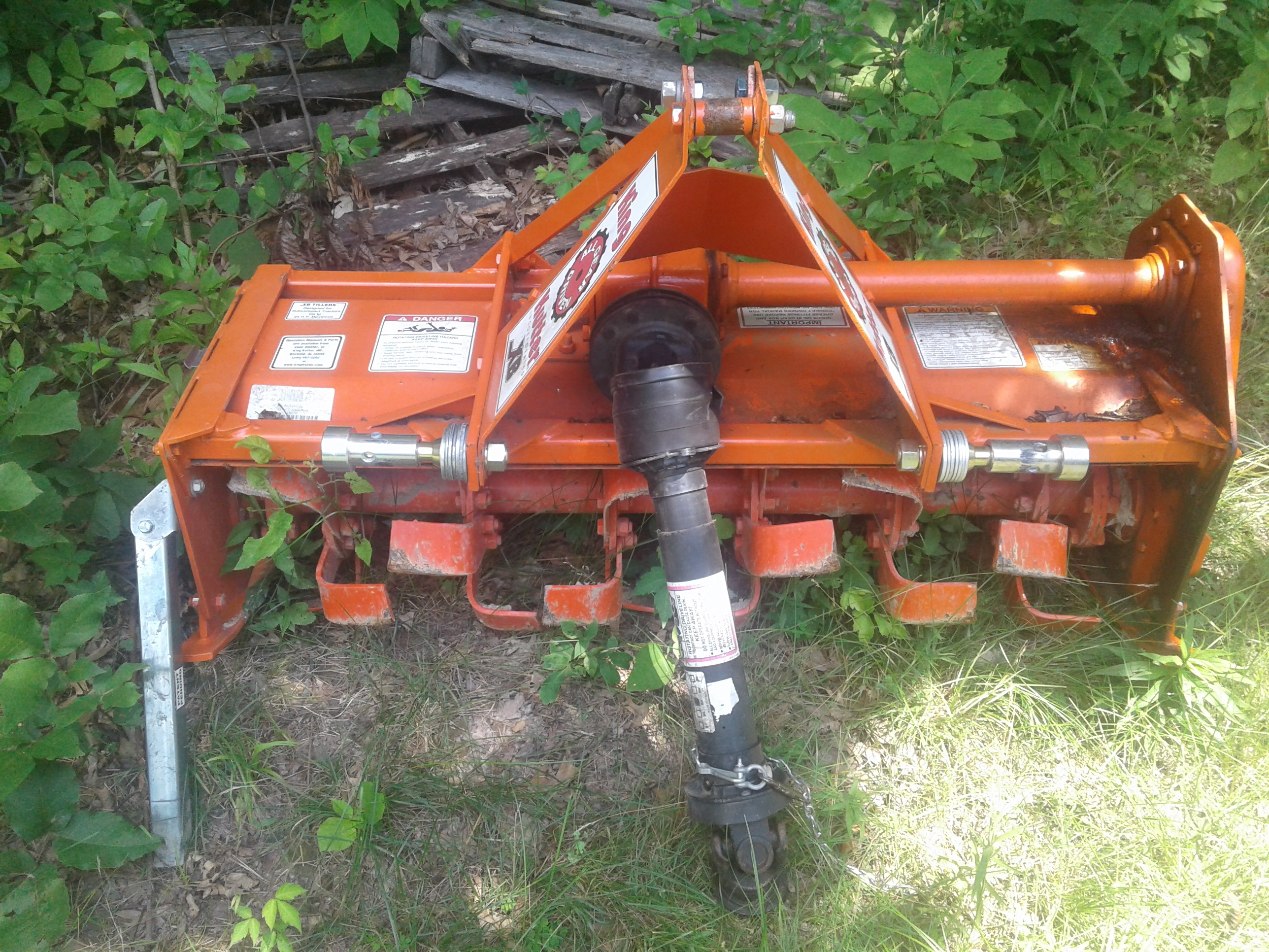

Here's what I did to make a tiller fit a QH
You didn't post a pic of your blade. Maybe a lift arm drawbar can be bolted to the front (3/4" bolts), or welded on. You would need to extend the top link also. More ideas here.
