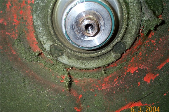

I just checked mine. I took the blades off and there was no sign of grease in the grease cover and no grease oozing from the spindles, top or bottom. My left took 36 pumps before it came out the bottom. The middle one took 43 pumps and it came out the top and not the bottom. The right took 27 pumps and came out the bottom. In all cases, the grease was green that was pushed out (my grease is almost clear). I am sure that my deck was never greased properly at the factory or at the dealer. I took before and after pictures of every spindle. Attached is a picture of the right spindle.
I also know now that you must remove the deck to grease it properly. There is no way to tell if you have pumped enough grease unless you take the blades and dust cover off.
John

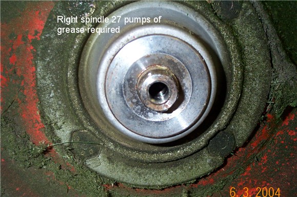

Ops... /forums/images/graemlins/blush.gif I thought that I had merged the before and after shots. Here is the after picture.
John
   / RCK60-24B bearing failure ?? #28
Another ops!.. This evening I went to my garage to put the blades back on my mower and discovered that grease was oozing from the bottom of the middle spindle and not out of the top. I must of seen grease that came out of the top of the tension pully an thought it was the middle spindle. I felt under the gear box and there was no grease there.

I have more or less concluded that if the decks are designed for grease to push through the seals anyway, that new users should pump A LOT of grease in to begin with...
So Junkman you did good...
I guess I did OK by pumping in maybe 10 pumps in each time I had the deck off...but still when I got interested and took the blades off as well as the spindle covers, it STILL toll almost 10 more pumps per spindle to see grease (except for the center spindle).
It sure looks to me like the spindle covers would hold a lot of grease though...maybe fifty pumps of my grease gun...so I would keep that in mind if I were trying to judge what was going on without taking the blades and spindle covers off...

Spoke to Kubota Representative today about this. He informed me that there is enough grease installed at the point of assembly to keep the bearings "sanitary" for shipping and the selling dealers are supposed to fill the spindles with grease as part of the pre delivery set up procedure. Also noted that the dealers might be under the impression that this is done at the point of manufacturing and that is where the breakdown of communications was. He also informed me that there would be a bulletin going out if they find that this is commonplace. I informed him about TBN and he said that they were fully aware of it and often read the comments. They don't respond because they (Kubota) feels that this is a consumer driven forum and that it isn't their place to be involved. To sum it up, they do have their fingers on the pulse of the Kubota forums, but do it in stealth mode. I spent over an hour on the phone discussing varied topics of the BX tractor with him. Very knowledgeable person that had almost all of the facts at his finger tips and said that he would get back to me on the ones that he wasn't familiar with. I feel better about Kubota today than any other time since I purchased my tractor. They really are trying to make a quality product and want to know about problems when they arise. Contrary to my previous opinion and that of others, they don't have their heads in the sand. /forums/images/graemlins/smile.gif
