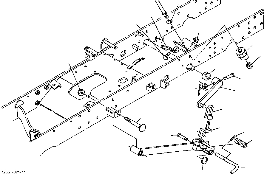

Jul 14, 2018 / RCK60B- 22BX Mower deck height adjustment problem #12 A anthonyv Bronze Member Joined Mar 29, 2011 Messages 83 Tractor Kubota BX24, Kubota BX2200 Pull the spring loaded pin as if you are removing mower. This clears the threaded rod part, then turn to raise or lower. Reinstall pin.
Jul 14, 2018 / RCK60B- 22BX Mower deck height adjustment problem #13 D dggott New member Joined Jul 12, 2018 Messages 7 Tractor Kubota bx2200 anthonyv said: Pull the spring loaded pin as if you are removing mower. This clears the threaded rod part, then turn to raise or lower. Reinstall pin. View attachment 562639 Click to expand... What exactly do I turn? The threaded rod? Is counterclockwise a longer cut.
