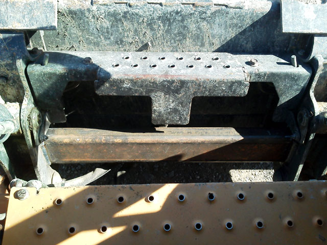

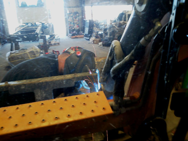

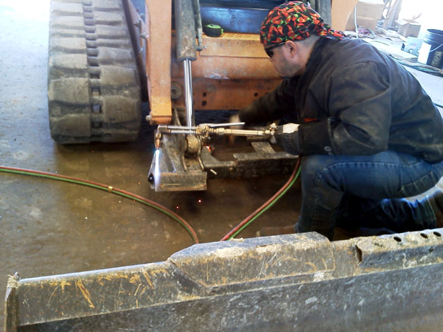

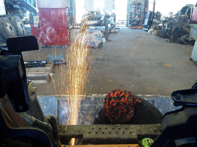

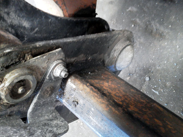

I felt a bit hinky about the weld shop, so I called my gravel / concrete supplier contact who said..."Bring it in!" These guys have a deal with Peterbilt and get frames, cabs and components, and build their own dump and concrete trucks from the frame up.
After the bent piece was cut out we discovered that it was only 1/8" thickness. Not any more...1/4" now plate to plate. Chuy getting it done.
