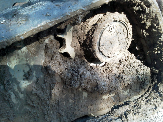

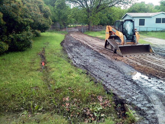

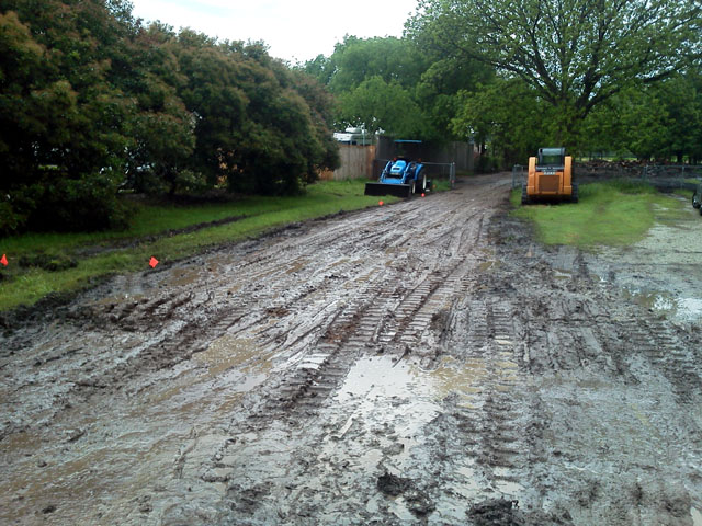

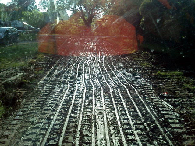

I only got a couple hours on the job today. I started roughing in a swale down the fence line and depositing it on the driveway area. Since the driveway had dried out quite a bit since I exposed it yesterday I wanted to get it covered up quick. All of the soil in the backyard is sandy clay...the front yard is black nasty clay. I got rained on early a couple of times, but not too bad. Then, while I was unloading the tractor it started to hail, followed by a bucket-dumping down pour. It's Soup City now, so I called it a day.
Eddie - I'll use rock if the job needs it, or the road will get exposed to heavy vehicles. These guys only have a couple pickups and small chippers so I'm not too worried about that. I'm using 1.5" road base for the job (which usually firms up pretty well), but I'll still have to see if sub-base has firmed up enough once I get back to the job. If it hasn't, I may have to put some 3" rock down before the road base.
