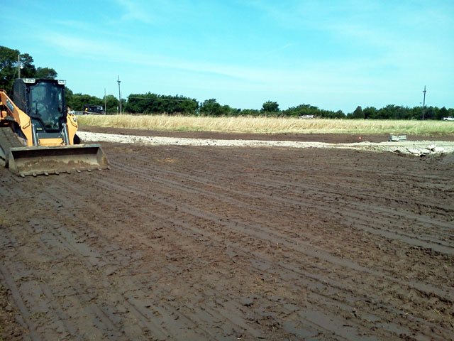

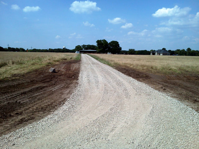

It finally quit raining, but the first job this week got off to a rocky start. This customer has an easement around a small plot that a local farmer works. I built a new road through the easement a couple of years ago and included a culvert [pipe across the road. Every time the farmer plows the drainage changes a bit, so we decided to grade out a larger swale, install a second pipe and also lengthen the original pipe by two feet. I also touched up the road while I was onsite. The job is only seven miles from my culvert supplier, but with several major water crossings closed near Lake Ray Roberts, it took a seventy mile round-trip to pickup the pipe. That, and the little issue of sinking the tractor the first day turned a simple one day job into two.

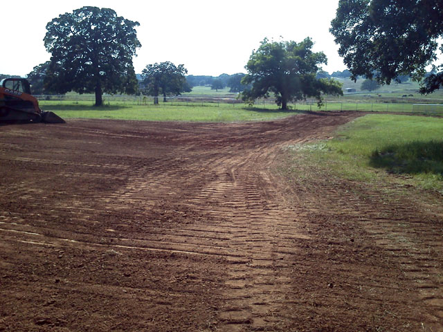

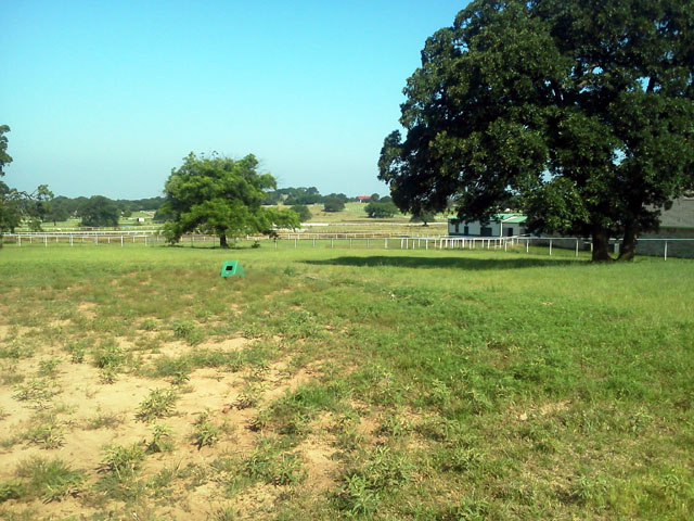

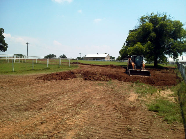

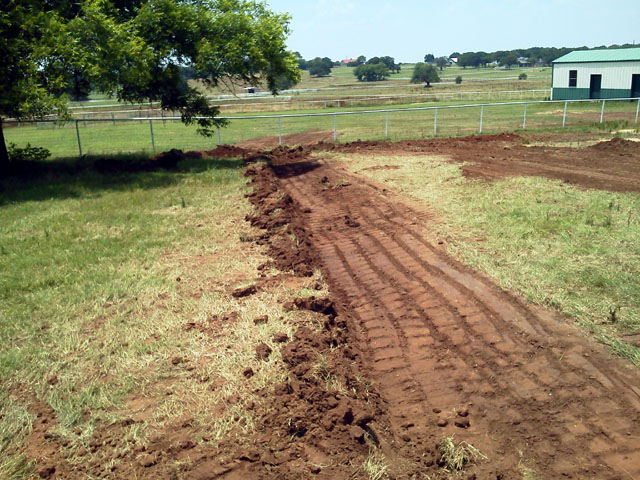

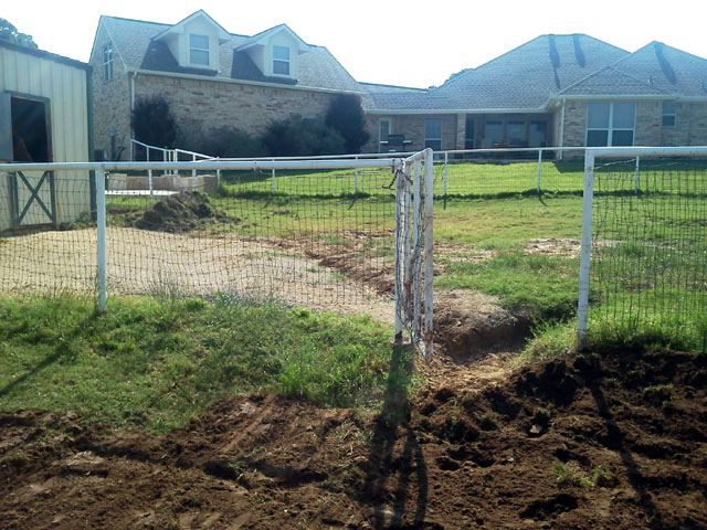

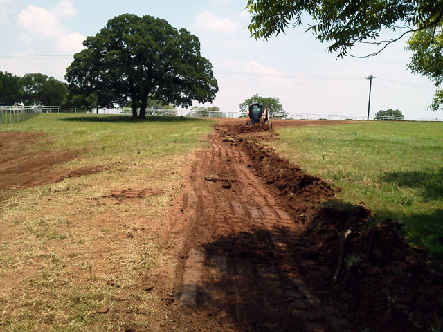

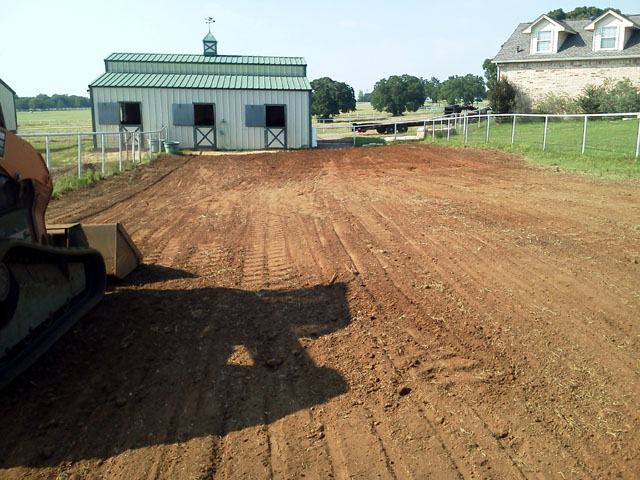

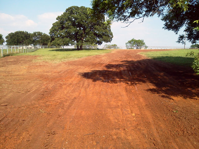

With most of my jobsites still a tad too wet, I headed for this one in sandier soil on top of a hill. The county resurfaced the road and basically eliminated the bar-ditch along the frontage. The change assisted in washing out the customers arena and diverted the flow away from the natural drainage doing damage to the area between their home and barn. Here are the photos of the bar-ditch and graded area. I also regraded the arena and the area above it. I'll post those photos after I place sand.
