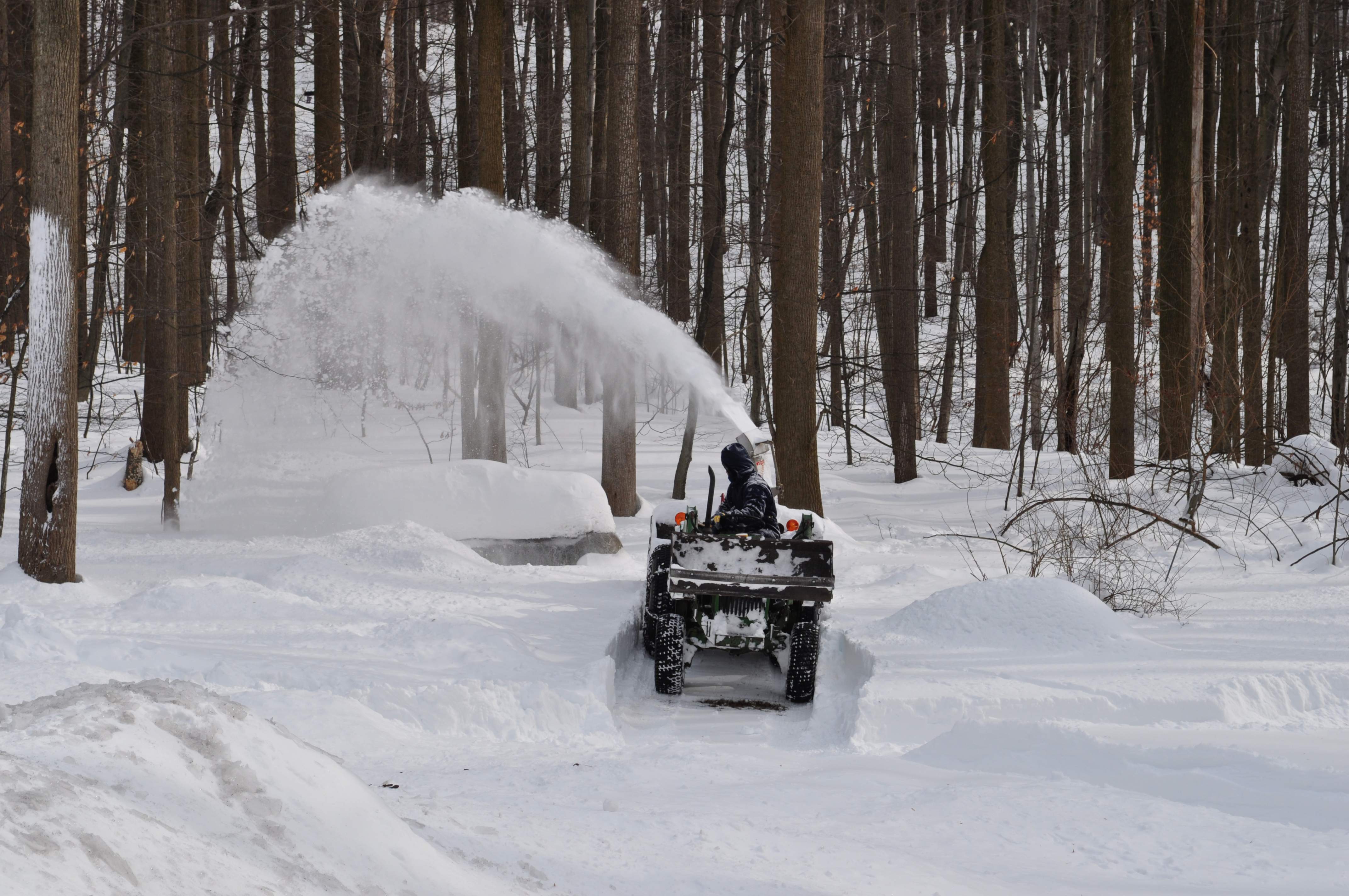

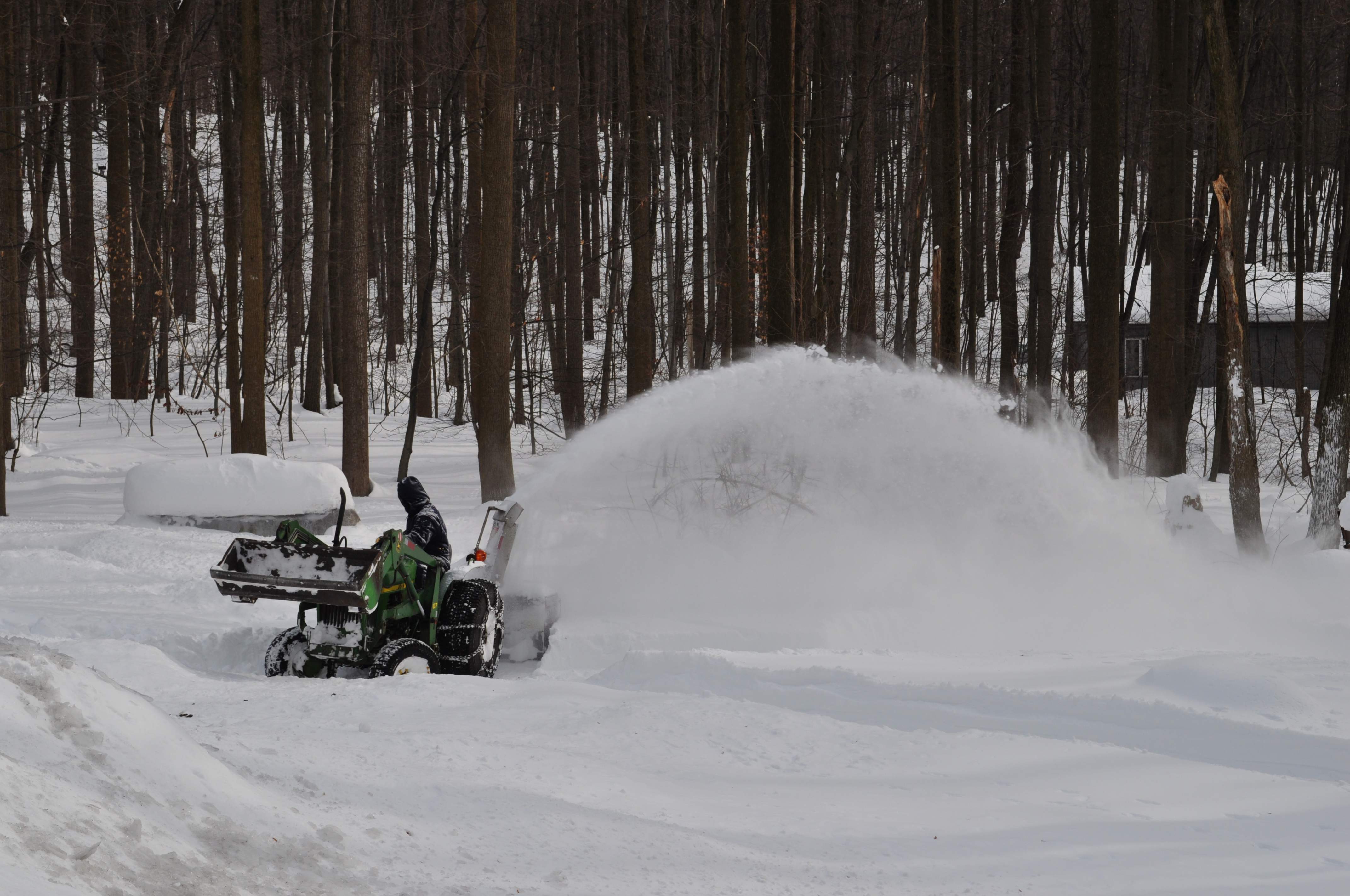

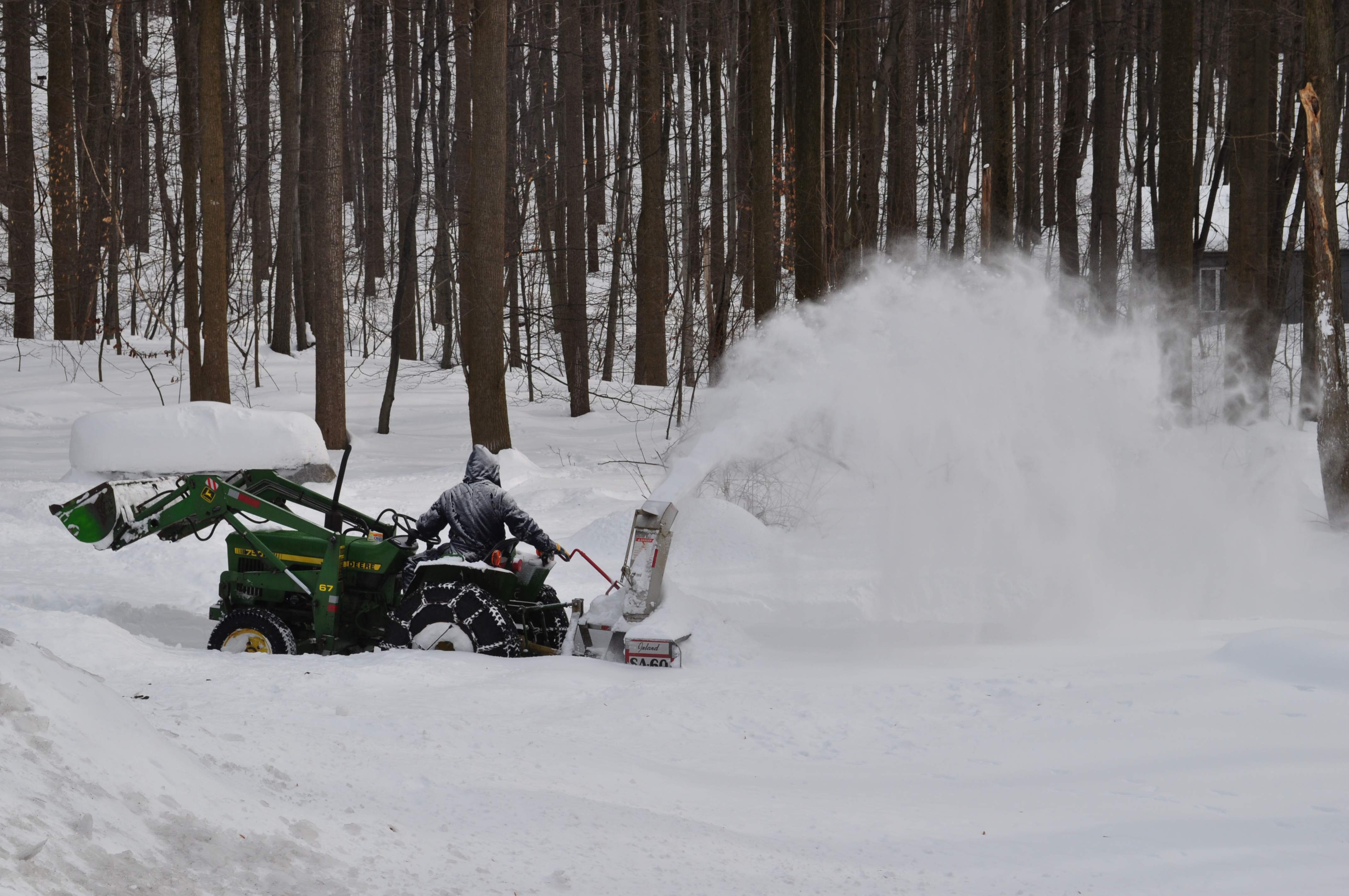

MacTractor,
I wanted to add pictures to my post above, but couldn't find them at first.
Here's a couple of photos to show what 18 pto hp will do for reference. The blower was in Inland SA-60 with a fan of approximately 20" diameter.
